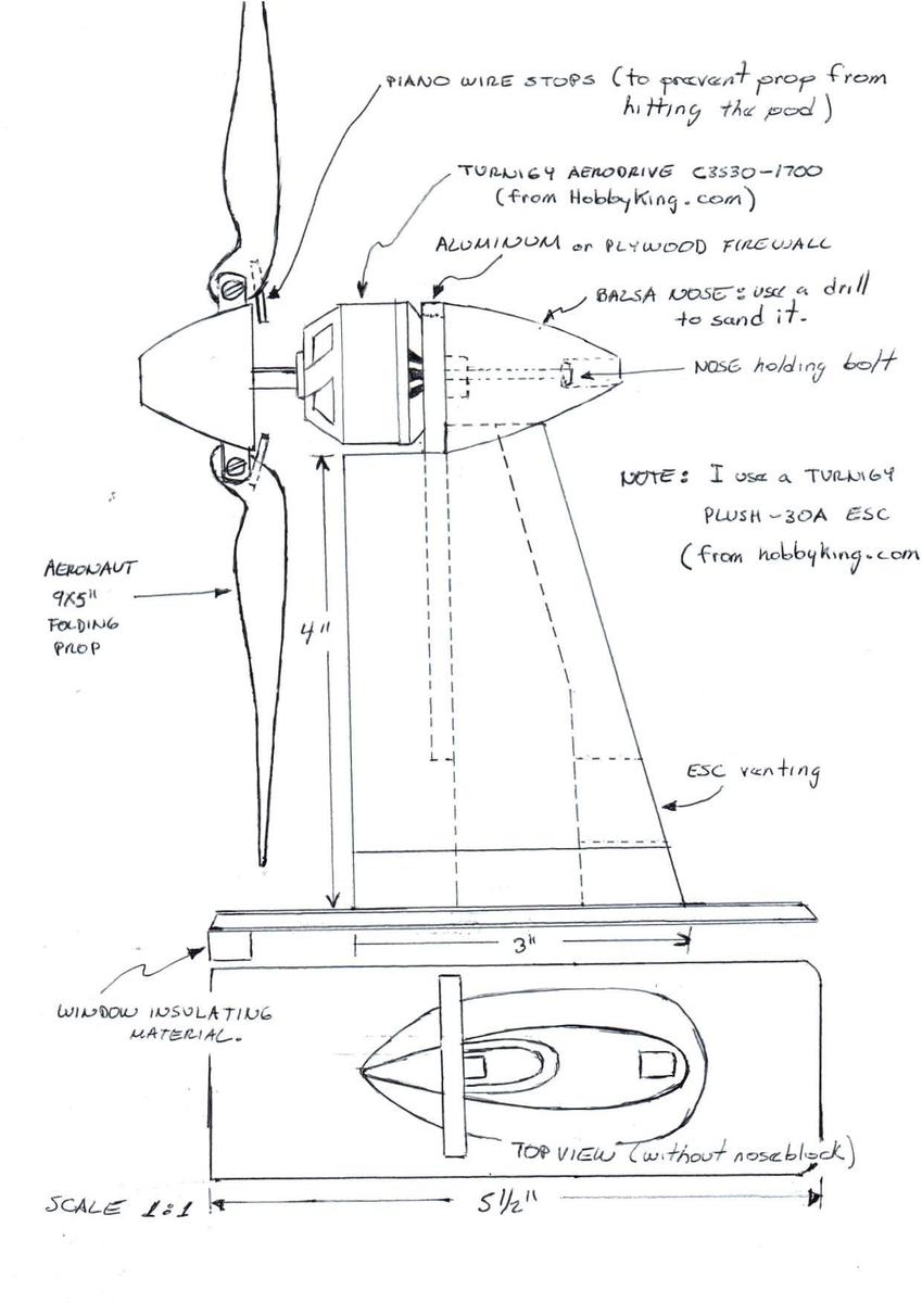

Paul, is this idea for a power pod of any use?
Stuart
Soarcerer
- Posts: 589
- Posts: 652
Re: Soarcerer
Thanks Stuart, Yes I have something quite similar in mind....... Also a pusher, the idea is to make a replacement hatch and mount it on that, just in front of the wing. I will probably use a bit less power than you are suggesting, and it will be swept back so as not to affect the CG too much...... But it will have to wait a while because I am trying to get the boat back in the water!
