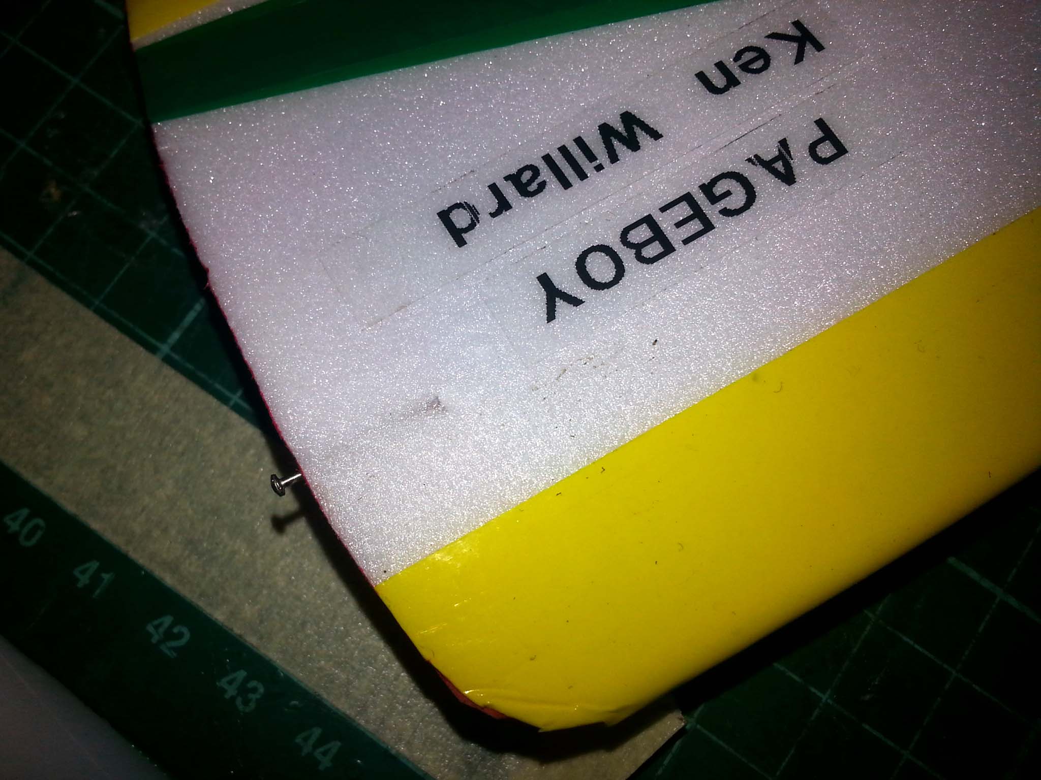

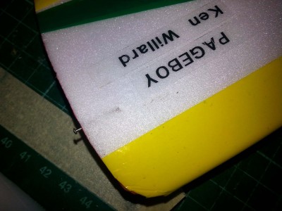

A simple trick I use on these small models to accurately get the CofG right, is to insert a pin into each wingtip at the required CofG location with the pin head protruding about 3mm. Then I can quickly & easily lift the model by the pins to check that I have the model balanced correctly - far more accurate than using your finger tips! If you decide to move the CofG, just relocate the pins accordingly.
pins inserted into the wingtips at the CG location

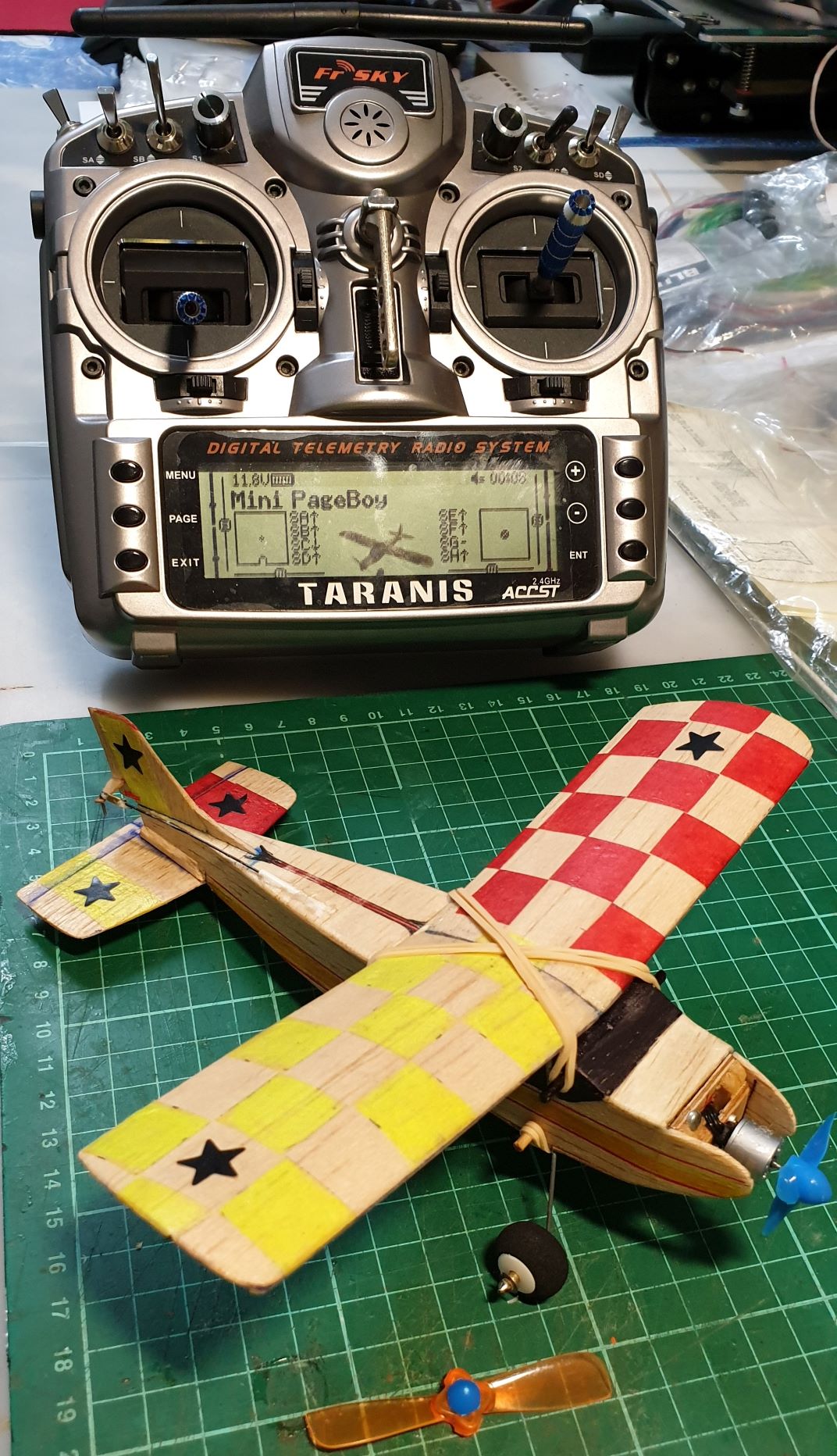

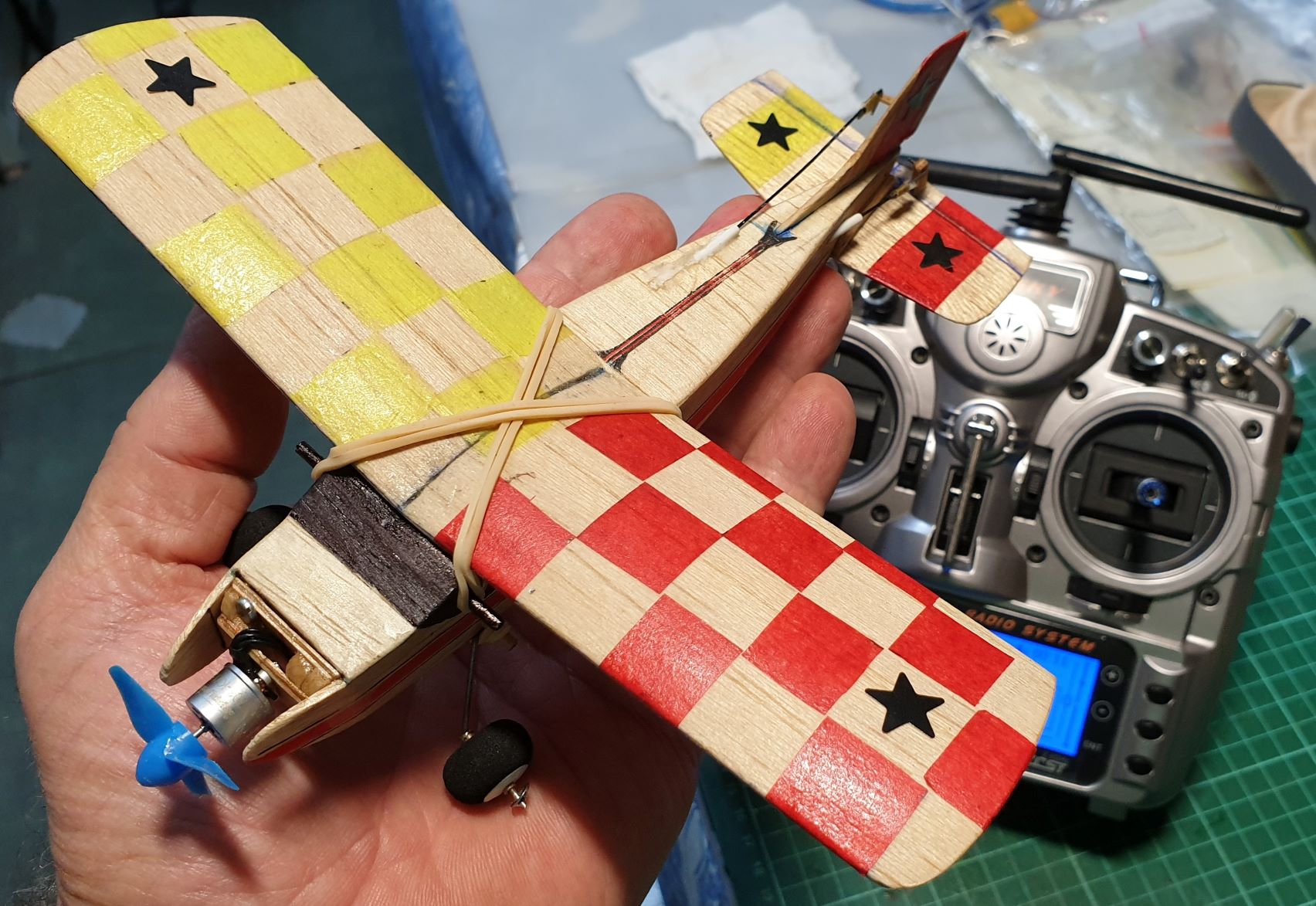

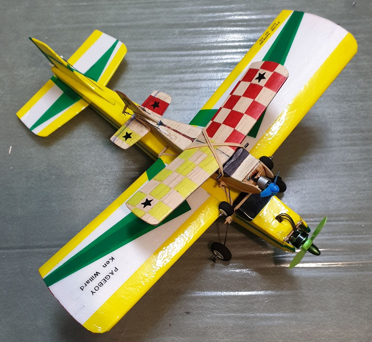

Re: Pageboy
Here are a few pics of my just completed 50% PageBoy. Came out at (edit) 33g ready to fly :D
a bird in the hand...
it is small, even compared to the full size(?) Pageboy!?!
More details to follow :P
