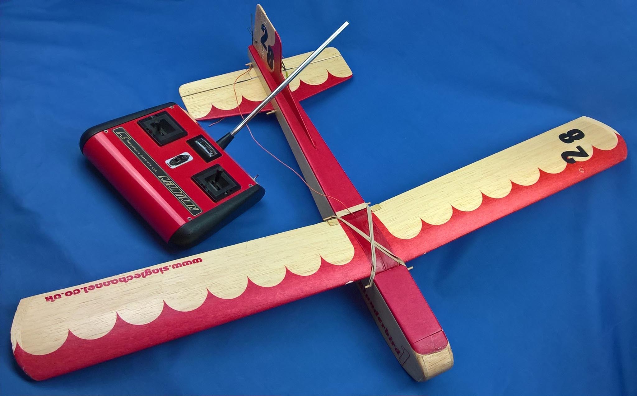

After some successful flights off the coastline with the Eagle Soarer last week I've prepared my Blunderbird glider for when I next have the opportunity. I've now added elevator - I found elevator invaluable for making progress forward into the wind.
Here it is with my Aerotron tx

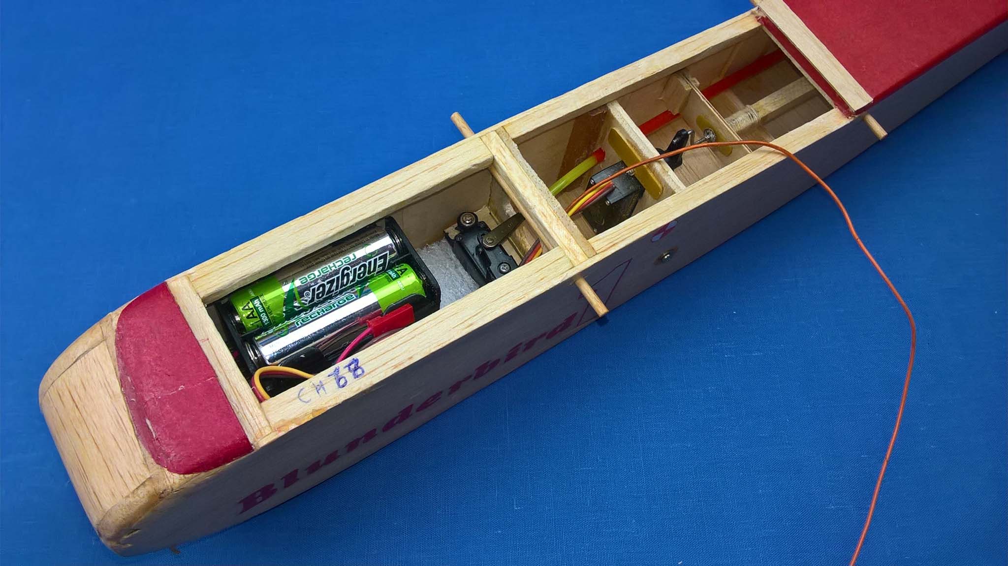

Found a nice place to mount the elevator servo in the front compartment

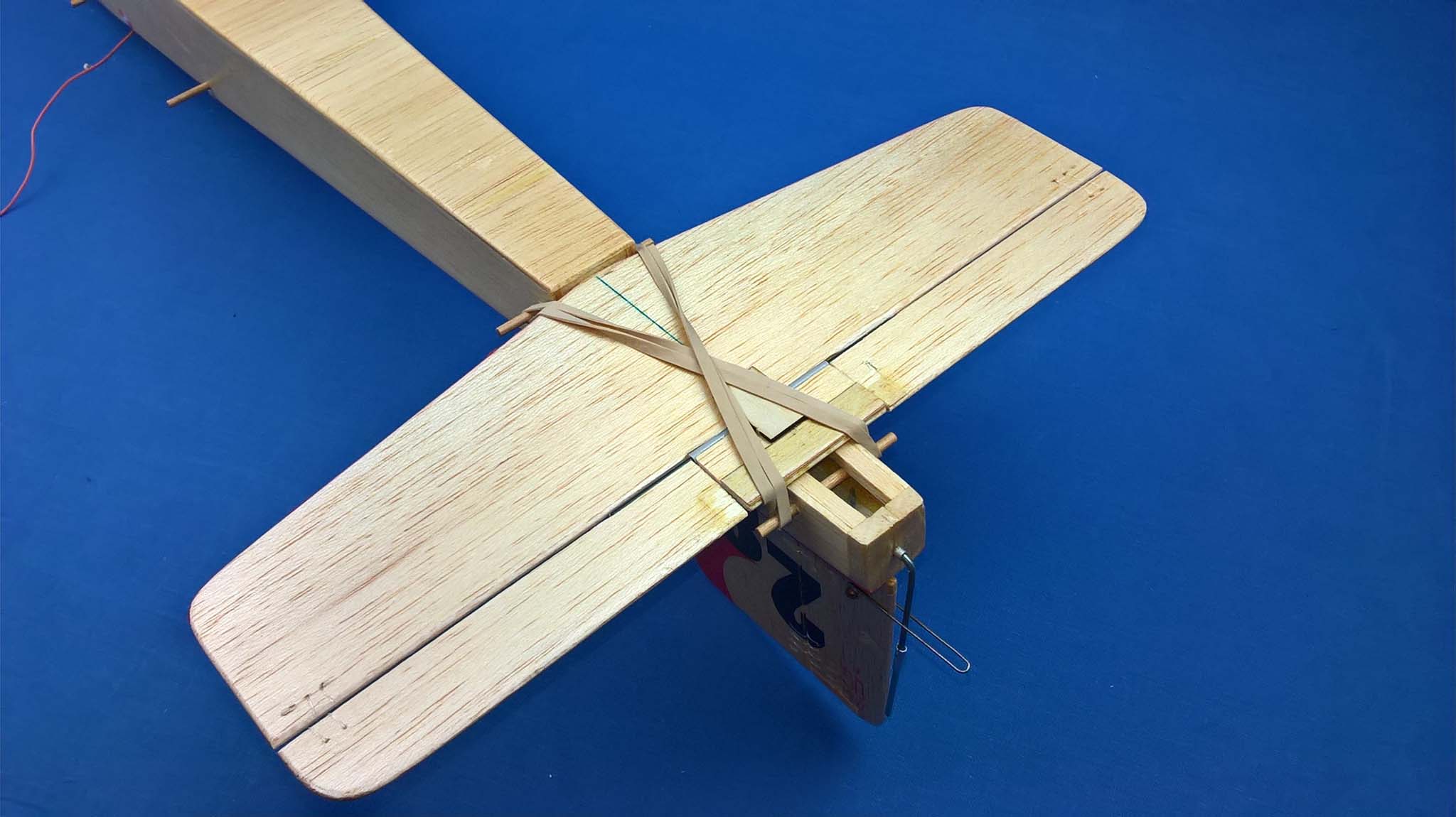

Tailplane is still banded on - elevator joiner is carbon rod going through a tube in the centre

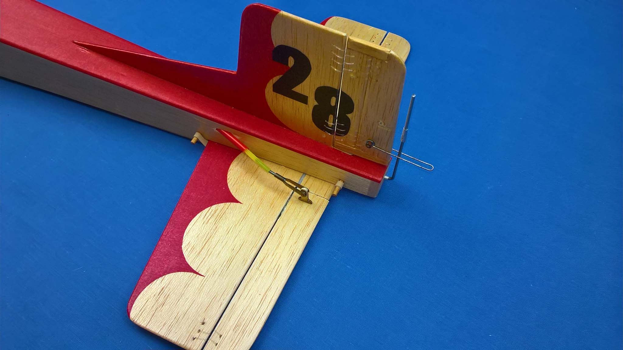

I used a snake with a quick link

The Tx looks like it's based on the RCM&E kit built set...
Glad the BB is now ready to be flown other than free flight😀
