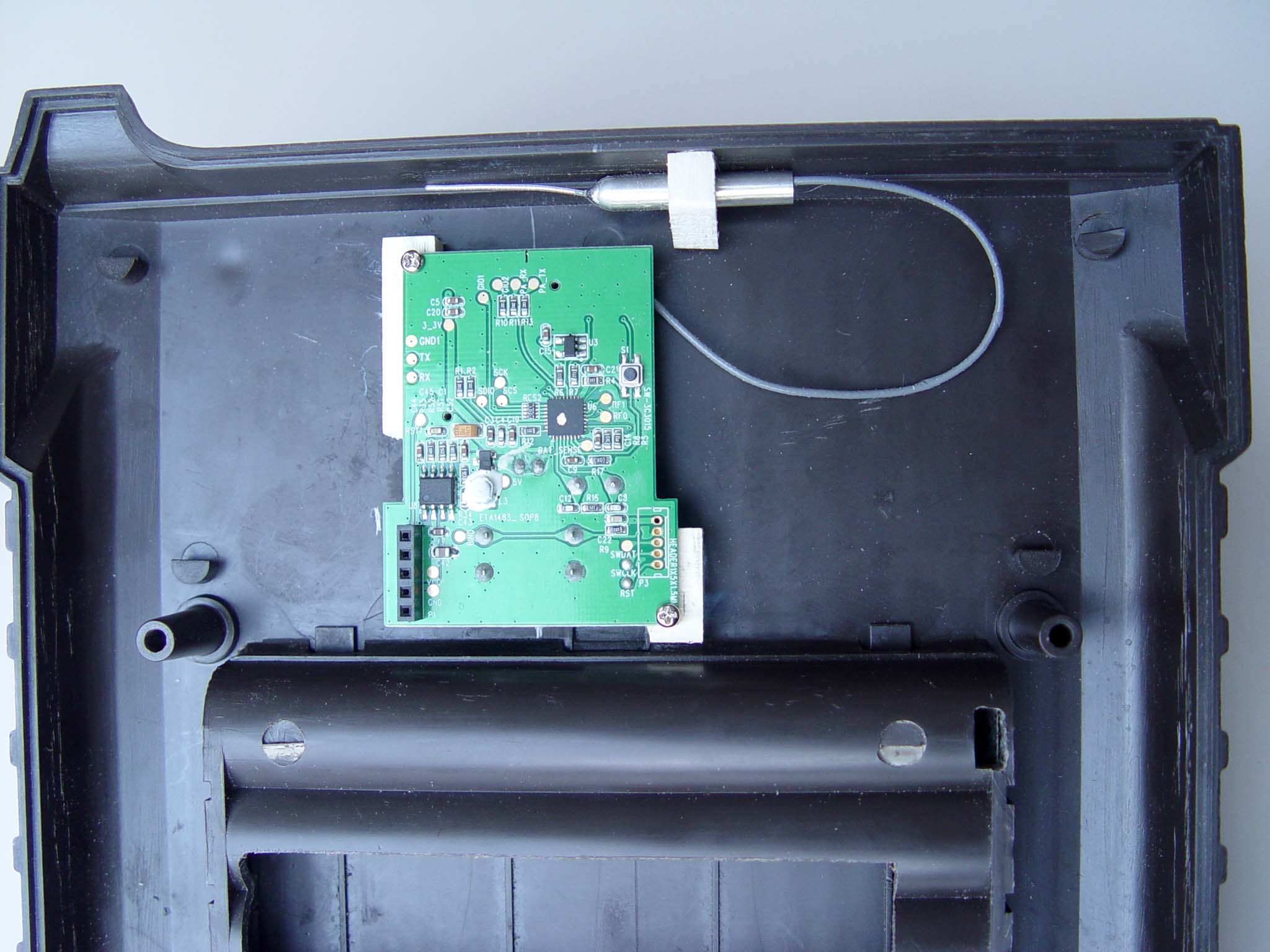

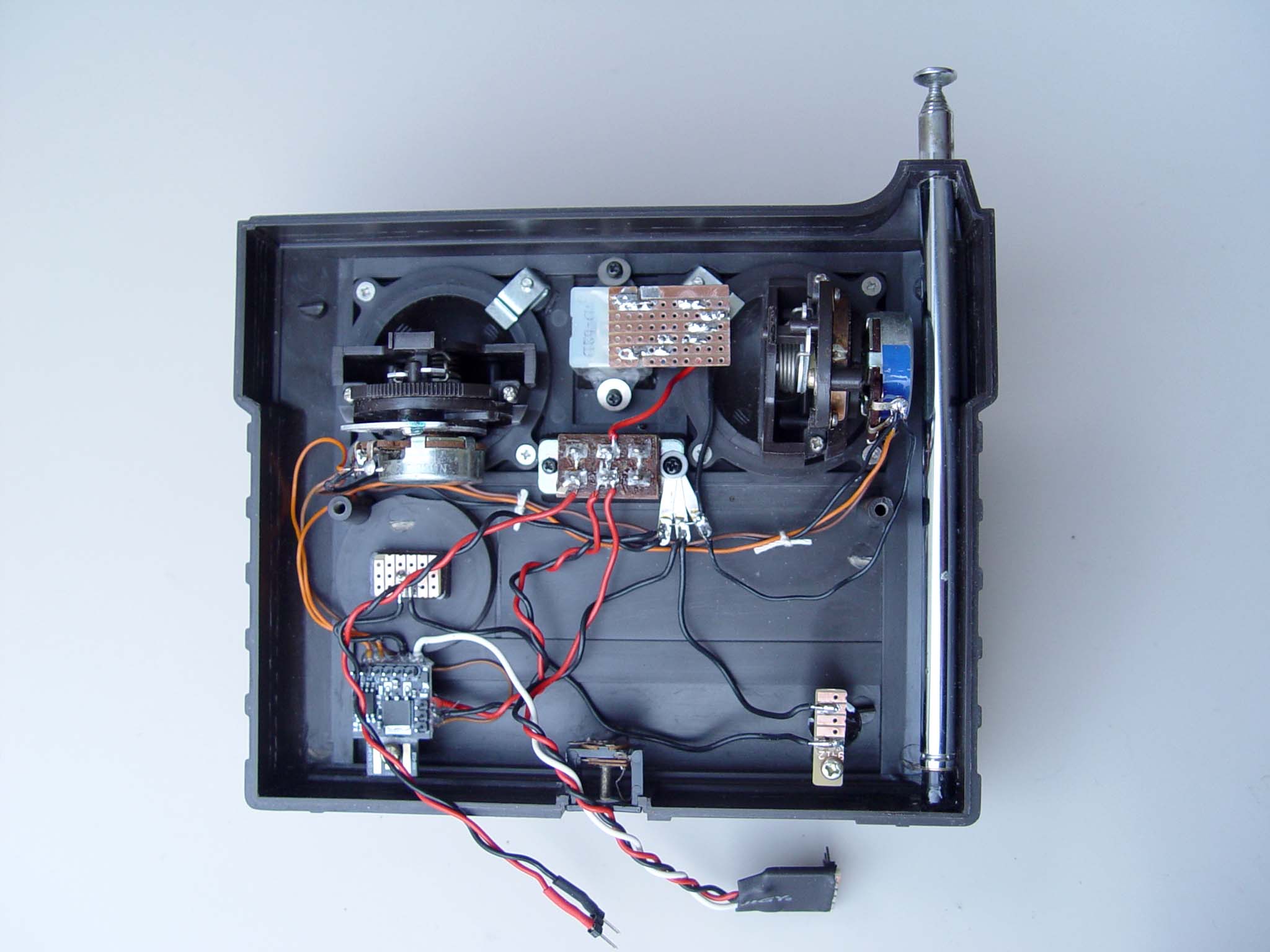

I skipped the GT2R module, and used a Flysky AFHDS-2A module after dismantling (euphemism

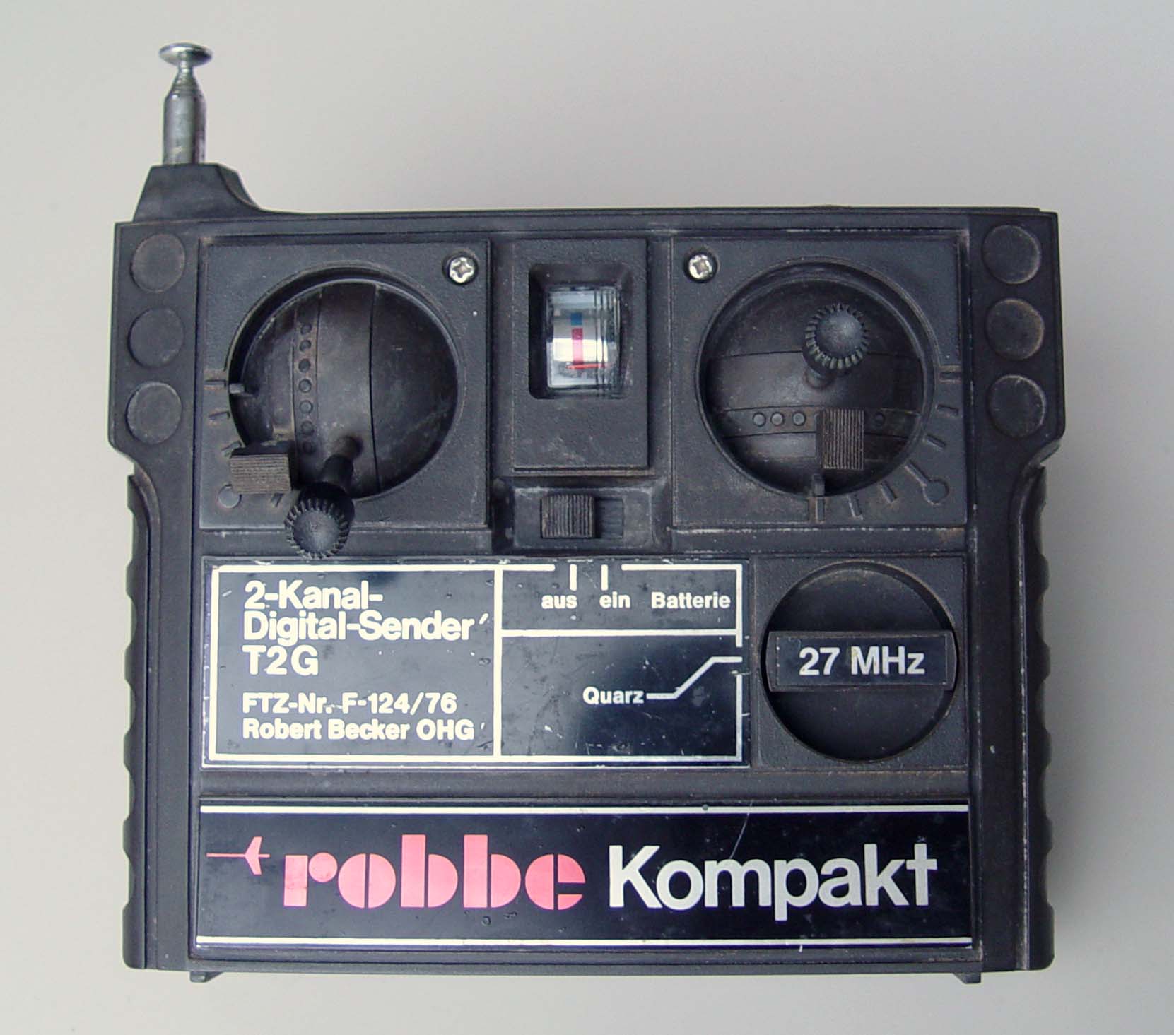

The transmitter is not in the prettiest condition externally, I think the fuel residues of yore have attacked the already matted surface, and trying the best I could (within reason) I could not get all the nooks completely cleaned.
The 2 channel transmitter is a bit of an enigma. The right stick (seen from the front) has the well known trimming mechanism, with an external lever rotating the pot by a small amount. But the one to the left has a completely different mechanism, whereby the pot is fixed (except for a permanent adjustment facility), and the lever is moving the centering mechanism around the axis, so you are able to set the spring-return of the stick to any position.

About programming the DigiSpark: I used Phil's 3 ch sketch with bells and whistles as a basis, but converted it to a 2 channel, without the s/c capabilities and the mixing, since the Tx is going to be used for boats mainly.
I disabled the throttle lock. The mechanism I described above will ensure that the throttle is in the off position as long as you do not touch it, and it will be also when you need a mid position "off' in case of a forward/reverse type ESC
