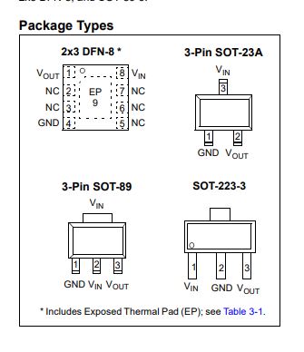

Out of interest, I wonder which bit failed in the OrangeRx? When powered up does the LED still illuminate? The reason I ask is that the module uses an ATXmega processor, a more modern version to that used in an Arduino, so it's unlikely to have failed. If no LED then it's probably the voltage regulator which is (I think) a Microchip MCP1703 smd that's failed. It should be possible to replace this. If the LED is working then I'd have no idea!

I have replaced a few voltage regulators both on Orange as on the original Spectrum as this showed up from the beginning to be a weak spot from day one when I was involved with testing the Spectrum in the early days. The first one you could even hear them!
I should probably have hidden on the bottom of some of my many boxes a few Microchip MCP1703, they are quite cheap, just to remember they come in all kind of shapes. You could easy test them with a regular multi tester. One of the reason they are delicate is their rating of only 250mA
I have noticed on several Orange modules cold soldering in the hole thru components like LED's, push buttons and the connectors so it's worth to go thru them with an iron.

Many thanks for all the responses...... Mike, thanks for the offer but I won't need to borrow one because my last order was for seven modules and so far I have only used four of them. It just means that one of the other projects will have to wait but I wasn't about to do that one yet anyway! No, the LED isn't working so maybe it is the voltage regulator that has gone.....? Tobe, I will have a look at it and see if I can recognise any of the components in your diagram and report back...... However I am in a full-blown panic getting ready for Christmas so it may have to wait for a while!
