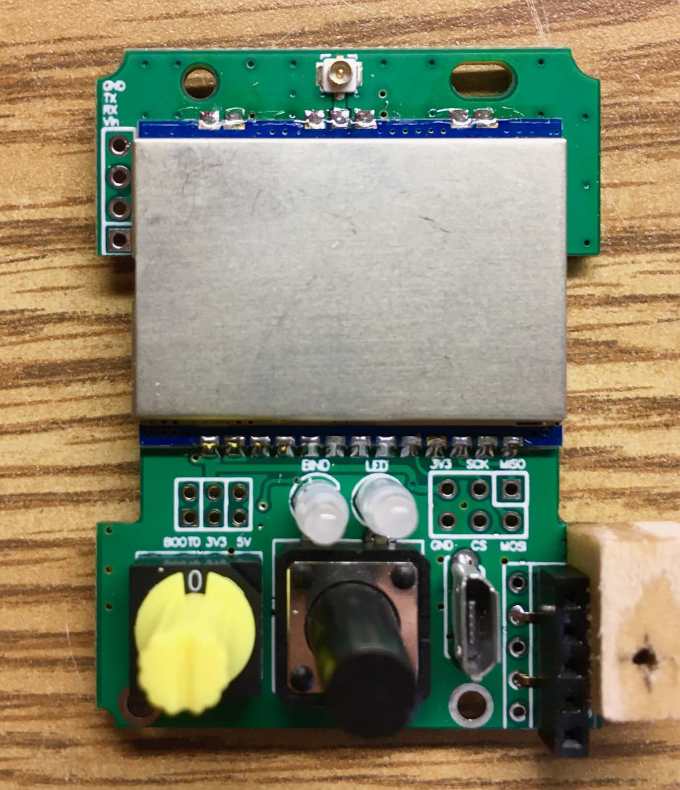

Folks I have the 4-in-1 multi purpose module from Banggood. I've been looking it over and I think I've identified the inputs from my decoder. However I'd like to verify I'm correct. [Edit: wrong, see below] In the photo, on the upper left, it appears their are 4 inputs annotated as GND (ground); TX (transmitter); RX (receiver but not sure if it actually says RX); and Vin (voltage in). I believe I should use the GND and Vin for the power, and use the TX for the PPM coming out of the decoder. If anyone else has used this module I'd appreciate knowing if I'm correct.

You are correct Phil in your assumption.Phil_G wrote: 25 Jun 2020, 01:51 I havent used one of these Al so I'm not sure but I doubt thats the case. Surely its the conventional JR connector in the diagonally opposite corner? The tx and rx will be for serial I/O
Others who have used it will be along soon I'm sure.

Yes, use the (standard JR) black connector in the bottom right of your photo.
There are 5 pins. Reading from the top:
1. CPPM signal to module.
2. You don't need to use this one. May have been an RF-power-level signal on old 35MHz modules (for driving a 'transmitted power' meter which some transmitters had instead of/as well as, a battery meter.
3. Battery positive, power supply.
4. Ground.
5. Again, you don't need to use this pin which is a hangover from long-wire antenna modules - this was the R.F. output pin from the module, connected to the transmitter telescopic antenna.
I'm not sure which pin computer radios use when they're communicating with modern modules serially - maybe it's the same pin 1, or maybe it's pin 2 and/or 5? In any case, for the normal PPM signal, you only need to use (counting from the top) pins 1, 3, and 4.
