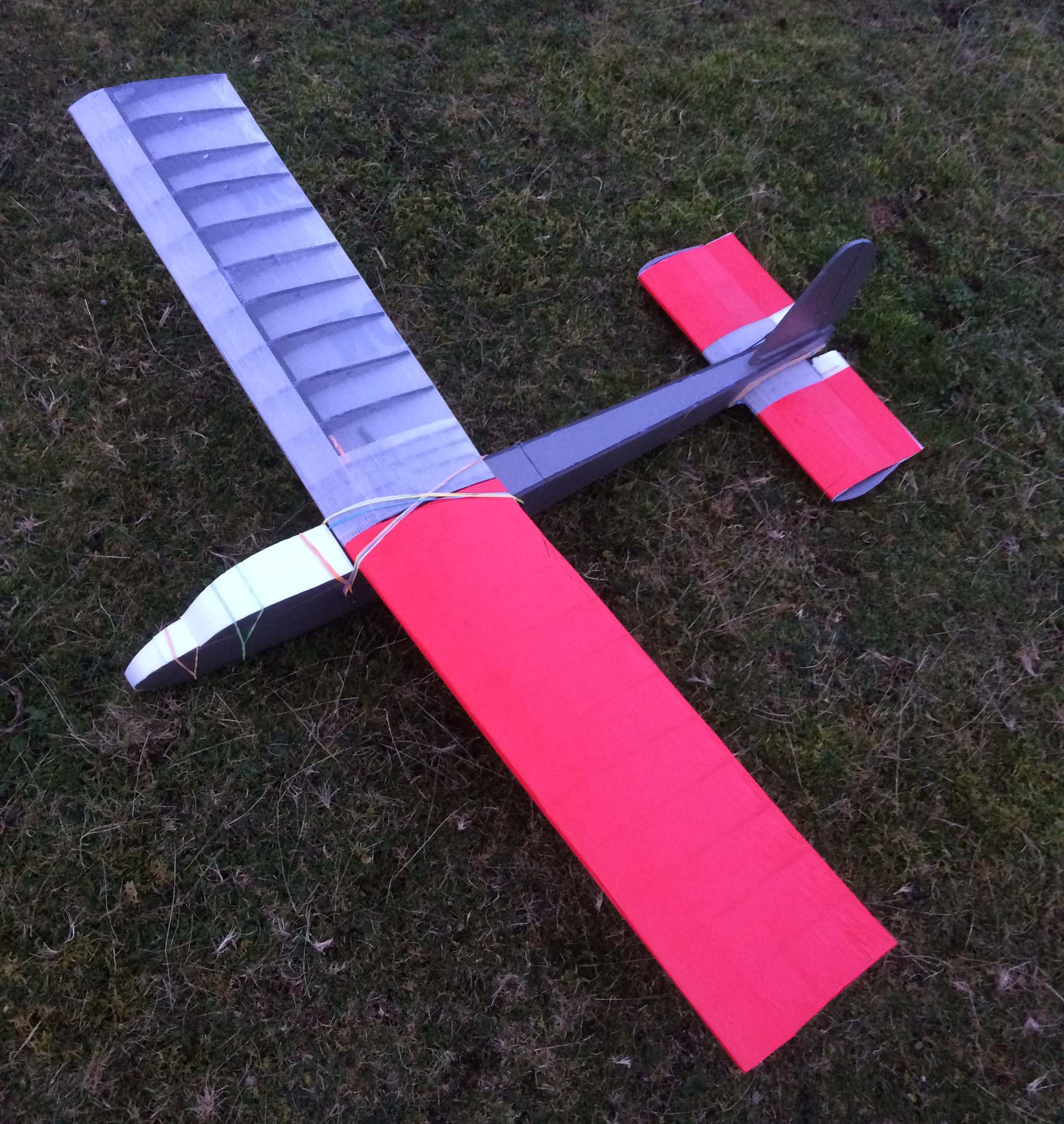

This my modern version (with apologies)

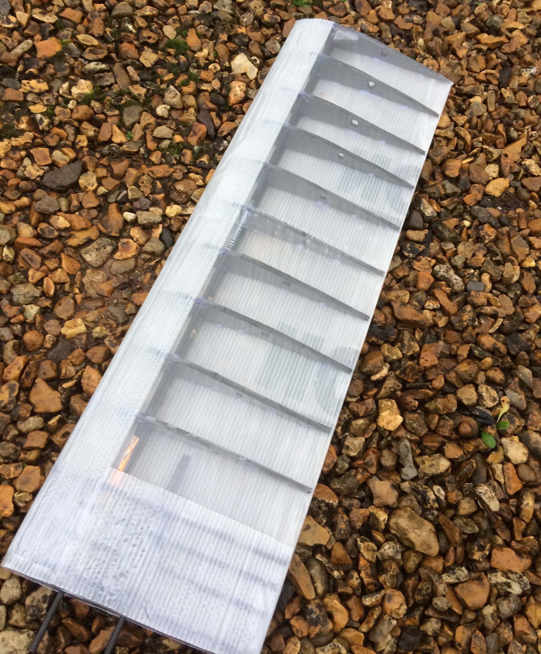

Fuz is 6mm depron
Wing is 2mm correx, 6mm depron ribs and carbon fibre arrows recycled from the local archery club
Red side is Solarfilm / clear side is doculam laminating sheet
Flies Ok - but flying it on the button I found it tricky to damp out the post-turn zoom - as in previous post
