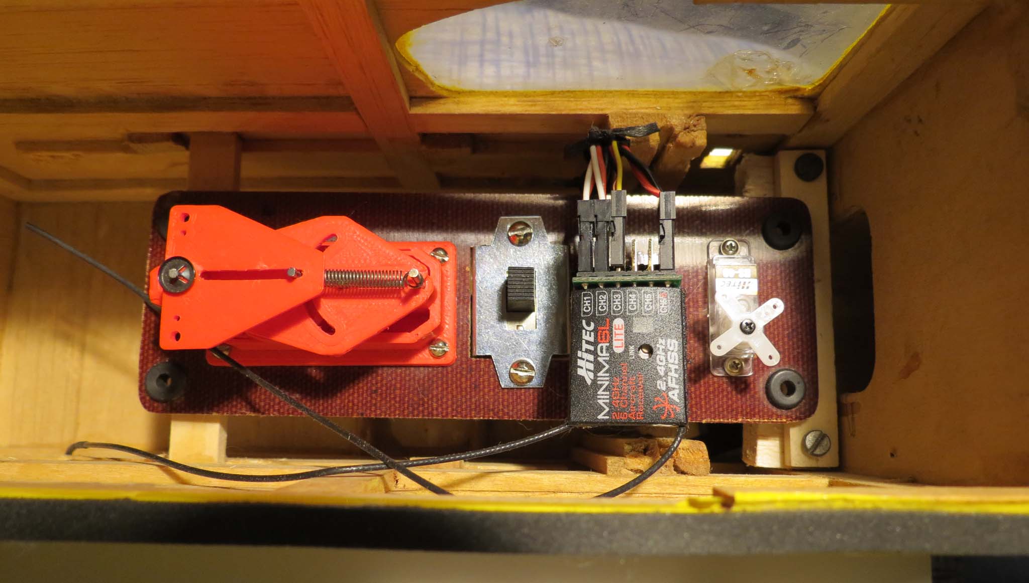

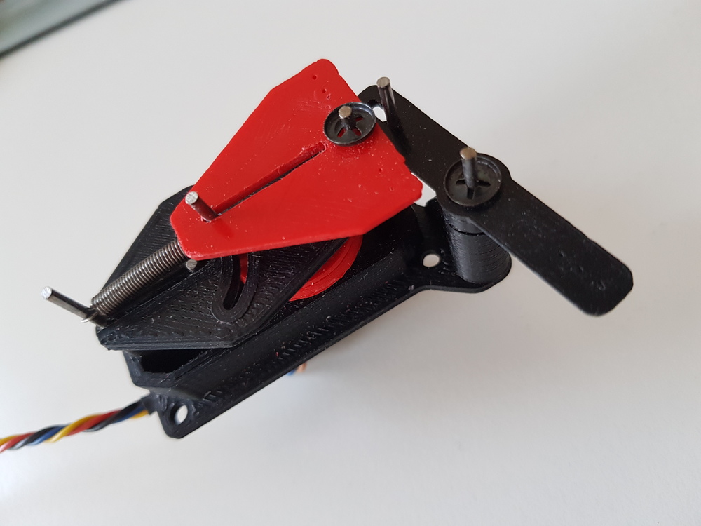

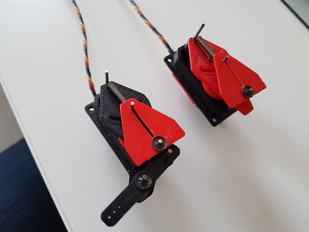

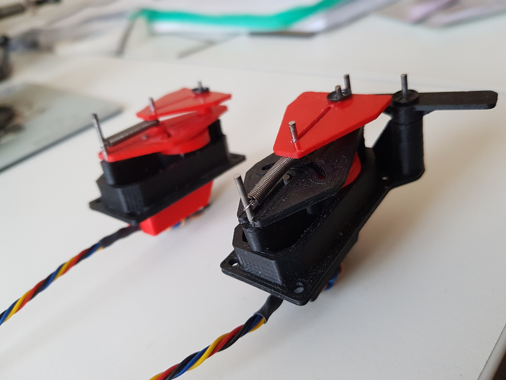

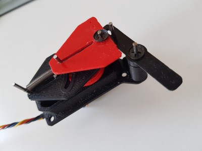

Here a few hints concerning the installation and set up of the actuator GG-Tobe PnP
3 leads connector should be connected to the aileron and the single lead to elevator. After You have done it you might have to follow this set up:
The recoder design is such that all adjustments if required would be done at the transmitter using travel volume, in fact the best way to set it up is to program elevator and throttle to very low travel. Then, with the sticks at neutral and with the linkages made and the surfaces flapping (only slightly at this stage), increase the elevator throw to give a rapid oscillation and just a few degrees of rotary movement on 'down' and maybe 240 degrees of rotary movement on 'up'. Then rudder travel volume is increased so that at full 'up' elevator and full rudder, the Rand is just short of cycling - ie it shouldn't ever fully rotate. GG is by its very nature a compromise, so some adjustment for best effect will be necessary - always aiming for as much movement as possible whilst avoiding 'cycling' on full throws.
In most cases You don't have to do anything as the actuator should fully work out of the box but some radios.
The actuator current draw is in the range of 100mA depending on how smooth your linkage is. I would recommend a BEC set at 5,2 - 5.4 V for constant voltage as the GG Actuators are voltage sensitive. As voltage drops, the throws diminish which also calls for "up" trim inputs on the elevator.
The voltage range for the GG-Tobe is 4.8 V -6.0 v.
I wouldn't recommend to reverse elevator in the transmitter due of the design of the "Rands style actuator" thus a mechanical reversing is to prefer.
There are several reasons:
If the actuator stops working you would have full up instead of down
As per design the actuator have more up then down in its original configuration
Last but not least you would have down instead of up when giving rudder.
...there was a "school" to fly reversed as it was considered to get a more "proportional elevator " on "high pulse" but I personally would not recommend it!
In this case a small bellcrank would do the trick and it was quite common in the old days.

Don't know if this will help, but the throttle servo is simply plugged in where it would normally go. This installation mimics how it was done with the Hallco radio system. They had everything on the receiver printed circuit board, even the actuator
An ESC will also plug into the same place. Should work with electric power as well.
Of course, the Tobe actuator can be easily mounted like a propo-type servo using screws and hardwood or plywood mounting rails. System is installed in a Midwest "li'l Tri Squire", 40" wing span and a Cox Medallion .049 with an ACE R/C throttle ring.
