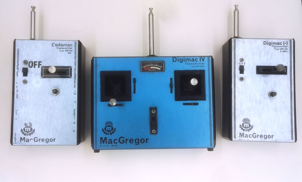

I assume that the big concern with the Codamac is the sliding switch? The rest of the radio is, I understand, essentially the MR200. Is that thought to be just as bad?
As I said before, the Codamac I have got is essentially new. The PCB and battery case is pristine, and the aerial is smooth, stiff and undented. For an early review, however, I have some concerns!
1 - The box is made from plastic and 0.025" aluminium sheet. This is almost paper-thin, and the back can be easily bent if you are not careful.
2 - The 'quick-blip' button is of much poorer quality than the earlier Macgregors.
3 - I'm not impressed with the way the battery is held in place by jamming a bit of foam over it.
4 - The metal control stick is unscrewed to transit. It screws into a plastic collar, and the treads will easily strip. Worse, there is no fixed location for this collar on the shaft. So if the shaft rotates because the screw is not tight the signal will fail. I wonder if this could be a reason for any bad press it may have?
Plus points are the compact box and a nice ergonomic design for the controls.
I suspect that the combo was originally used in a boat. It came with a Supermac MR60 receiver which had a coating of rust. Odd, for an aluminium box... Opening it up, I found traces of water and corrosion products all over it - but the electronics seemed sound, and it provided power to the relay. Trouble was, the relay was all gunged up with corrosion and wouldn't work. I thought about removing the relay for cleaning, but eventually opted for cleaning in situ, using a pin and hypodermic to clean the relay lever with meths. Once it was freed it worked reliably with a solid 'clack'. I suspect this was used once in a boat, not cleaned and dried after use, got sufficient surface corrosion to stop it working and was then put away and forgotten.
Now I hope that it will get back onto a lake after a 50 year rest....

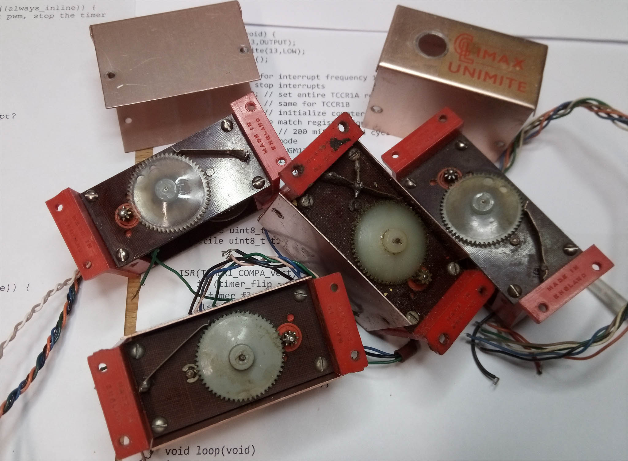

The Climax Unimite had a brass leaf-spring against the transfer gear as a brake. without it the actuator would cycle endlessly... similar in principle to the rattler on compound escapements :)
The instructions (see singlechannel.co.uk Archive) explain how to adjust the brake to prevent skipping:
