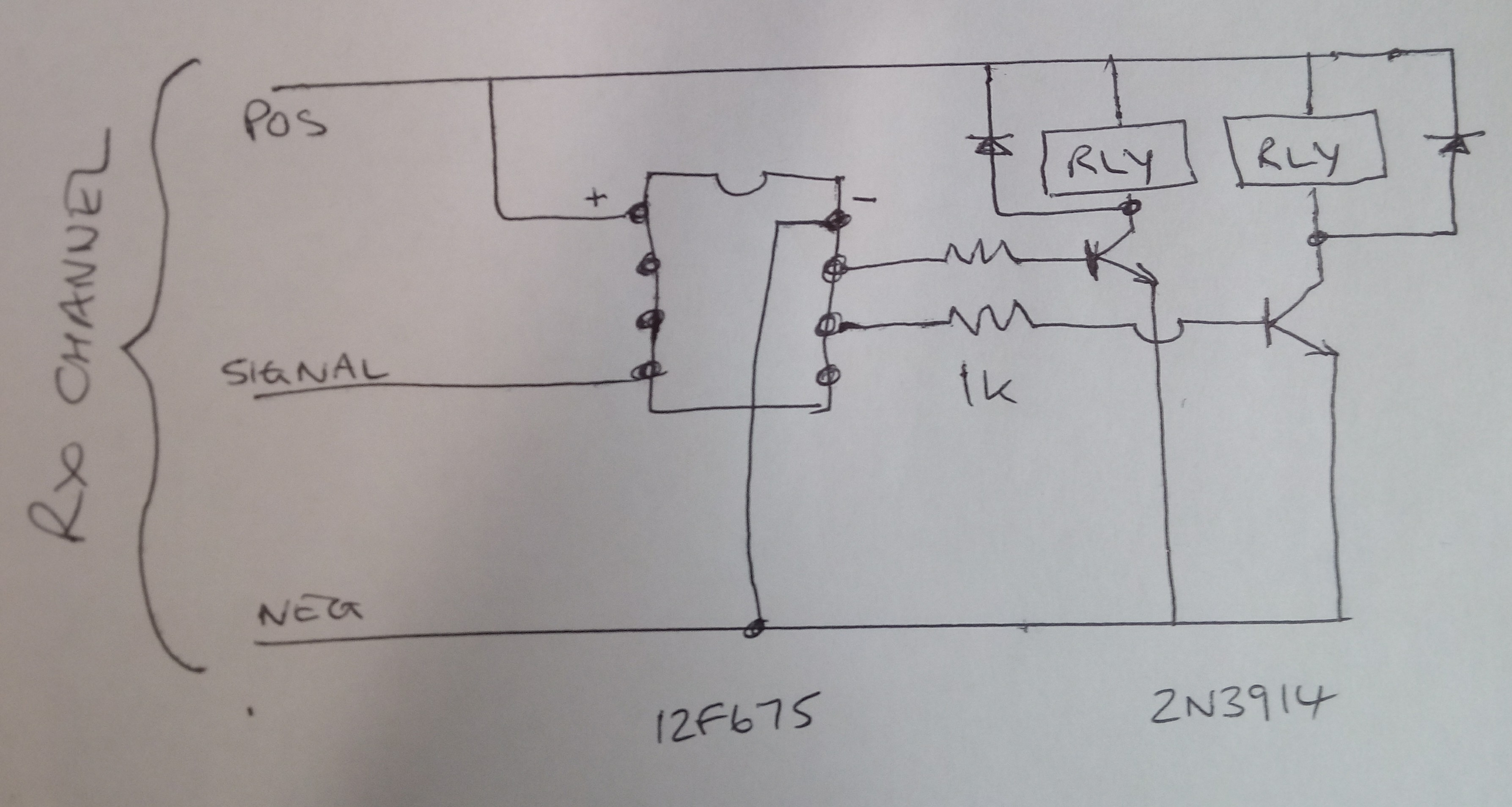

I've done the same thing, driving period reeds servos from a conventional channel signal. I used a transistor driver to get enough current for the relays and to isolate the inductive bemf. Works perfectly.MaxZ wrote: 09 Aug 2020, 14:18 Hi all,
Bruno (F2B) and I are discussing designing and building a controller for a Graupner Bellamatic servo using an ATtiny85 and two of these: https://www.kiwi-electronics.nl/download/KW-1580.pdf (the 5V 150mW version)
I used relays in preference to bridges so that they could be wired to any standard reed servo straight from its supplied diagram. viewtopic.php?f=62&t=327&p=1440#p1454
Files attached, I checked them this morning hence they have todays filedate, they're from 2011 ish
Mitigating bemf is personal preference - many use a DC buzzer straight off an I/O but if you'd scoped it you wouldnt. The Atmel ovp clamping diodes are only 2mA so you need something Max.
Its all inline code so the PIC will translate easily to Arduino, basically its 4 lines, use pulsin, if > neutral operate relay 1, if < neutral operate relay 2 else release both relays:

Yes Phil, I read your stuff on that subject, as a matter of fact it set me off to search for a local source of those little relays. I take it you share my concern about inductive loads straight from the ATtiny, so a transistor driver will be required to take care of the bemf. Or would a Schottky do it, as the coil current is only 30mA, so the port on the Atmel should be able to drain that?

Re: Graupner Bellamatic controller with ATtiny85
Thanks Phil. I had already made a stripboard layout with exactly the scheme you included, I still have to write the arduino sketch. But Bruno is well on his way to produce an alternative using a H-bridge driver chip to drive the Bella, so i'll see what he comes up with first.
