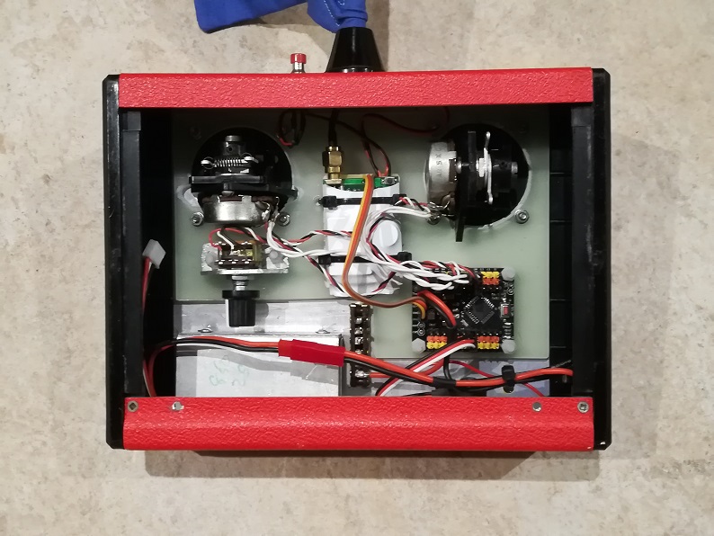

You can buy a standard lead, leave the plugs or sockets on both ends but separate the three wires. Then twist them by holding one end (gently) in a vice and use a twist drill to twist the other end. "Over twist" it a bit because it will try to unwind. Then keep it straight with slight tension and use a heat gun to gently soften the plastic coating. Keep the tension on while it cools and it will set as a twisted lead. :P
These were twisted in this way........
