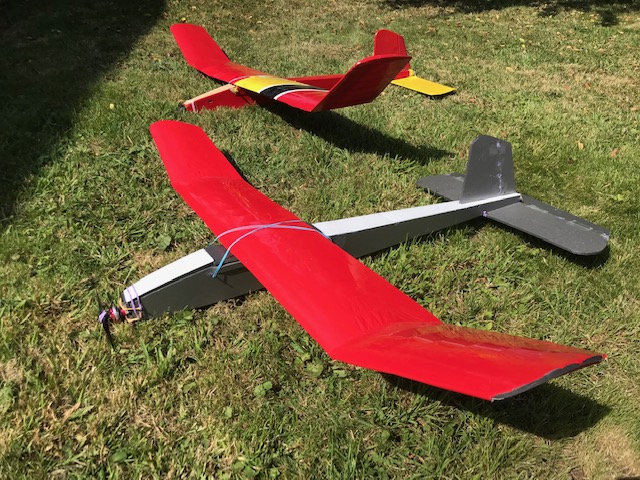

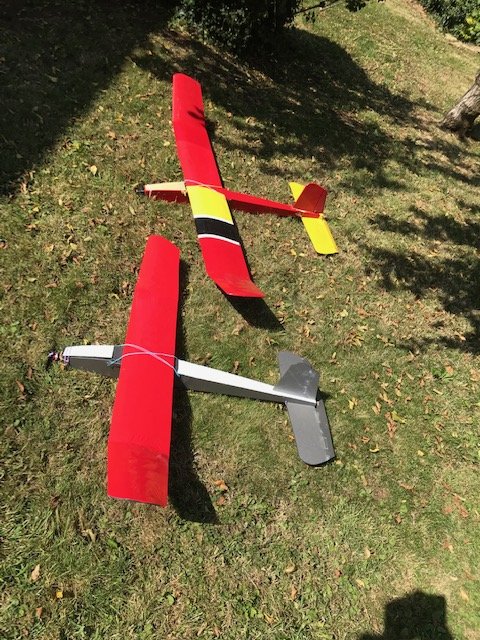

Near Z is 6mm depron + brushless outrunner (nose can go over if prop is off)
Wing made up with ribs and capping with c/f spars - hot glued.
Big mistake as covered in Solarfilm - shrinking built in warps - but all straight now. Won't build like that again...
Far Z is original from about 1974 - flies well - usually Crook Peak
Fr Sky and Pascal Langer s/c emulation - SW slope is spine ridge so hard to land on the button (well for me)

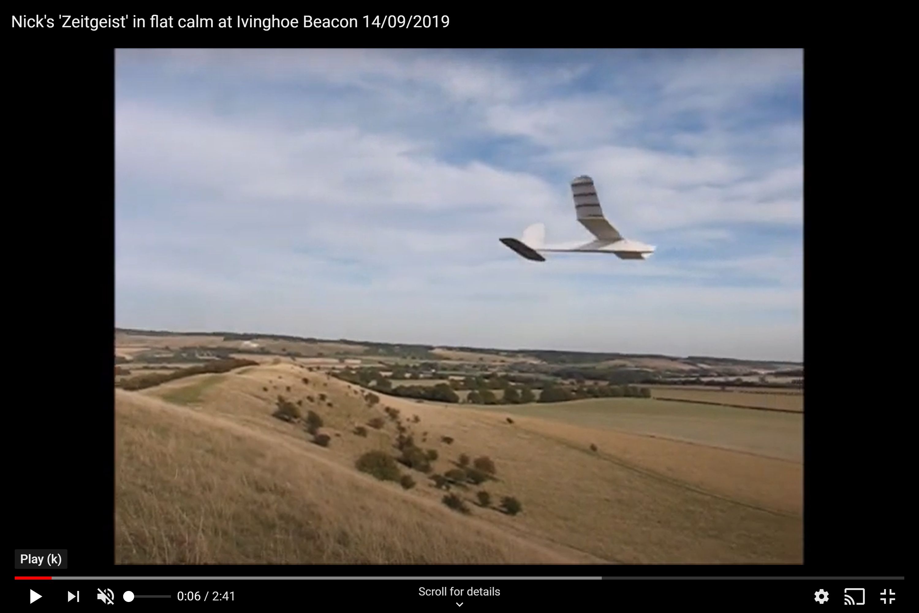

Z + seagull at Ivinghoe to remind us of summer

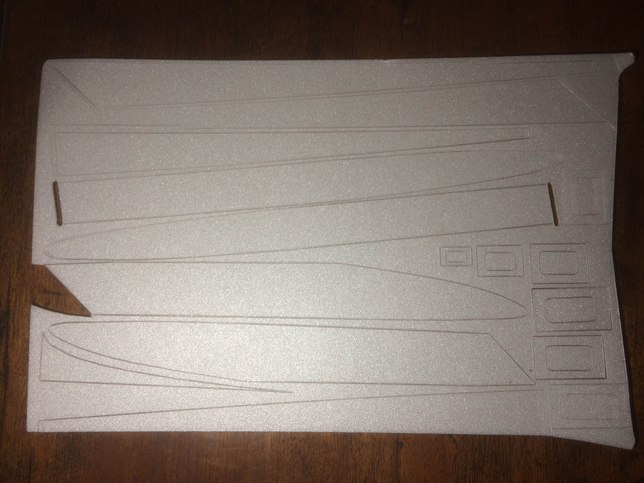

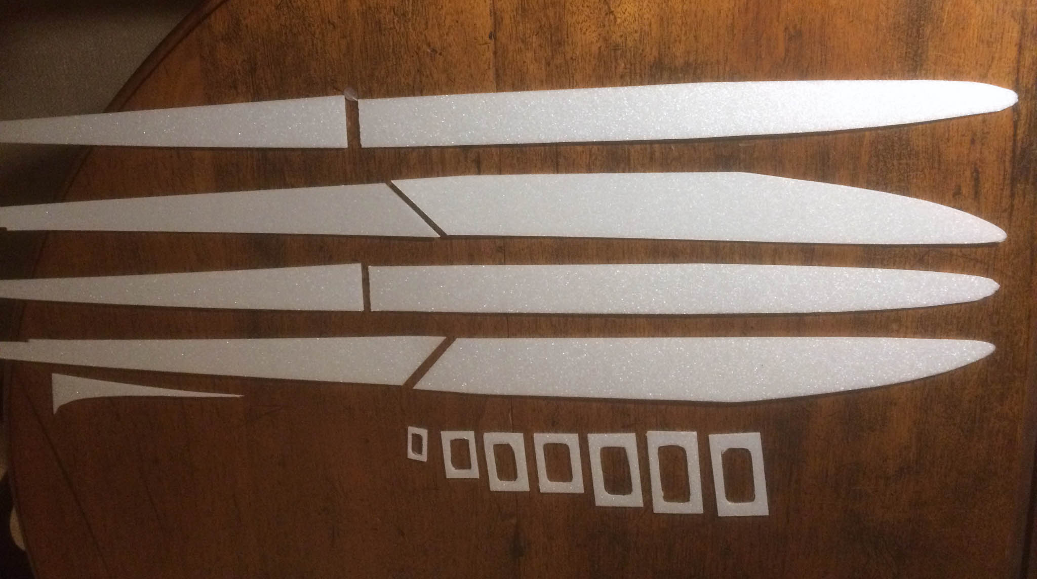

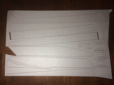

2mm depron (with apologies) - laser cut
some edges dodgy... had to run it through twice

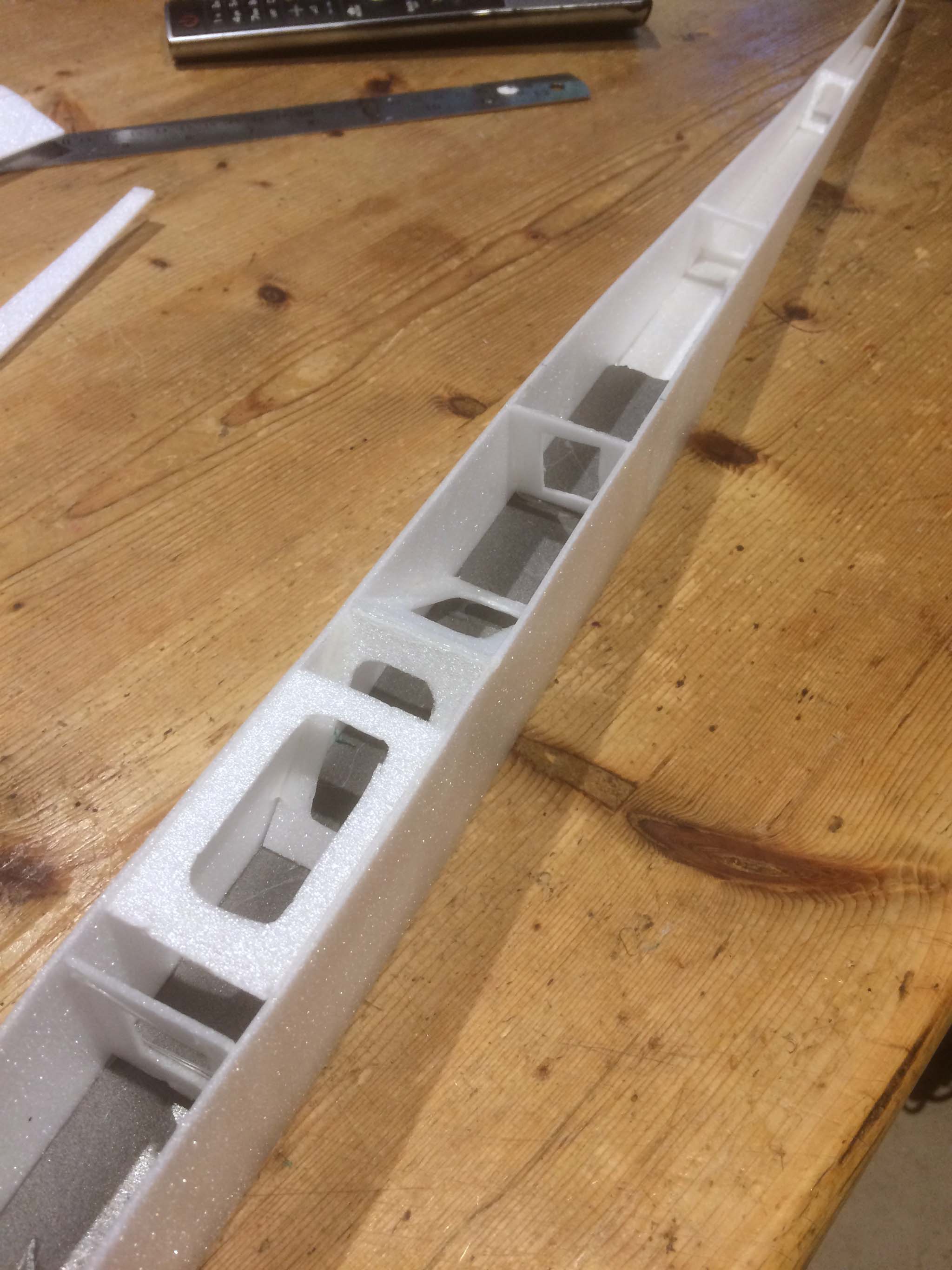

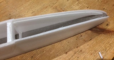

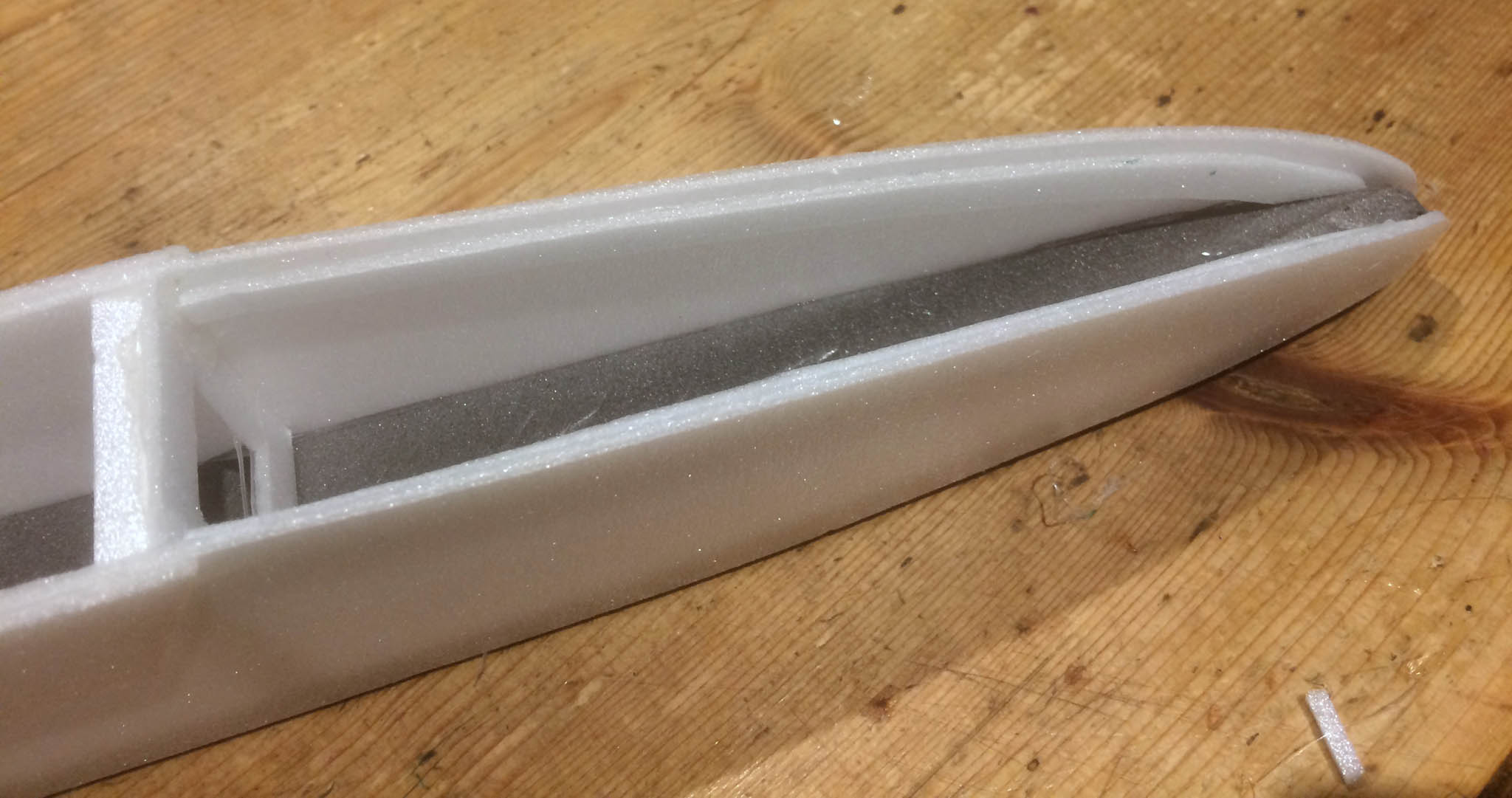

I use some of the formers horizontally - stops fuz being crushed on launch...

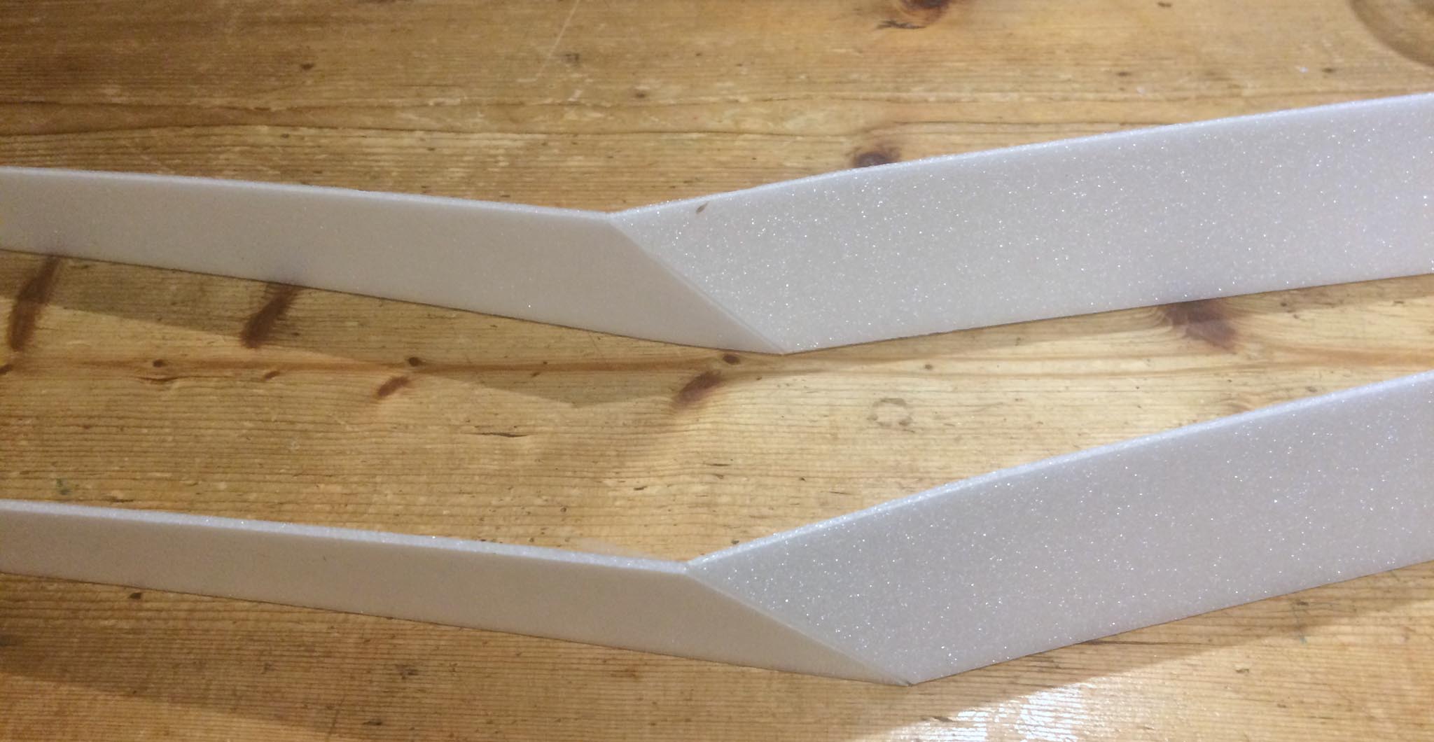

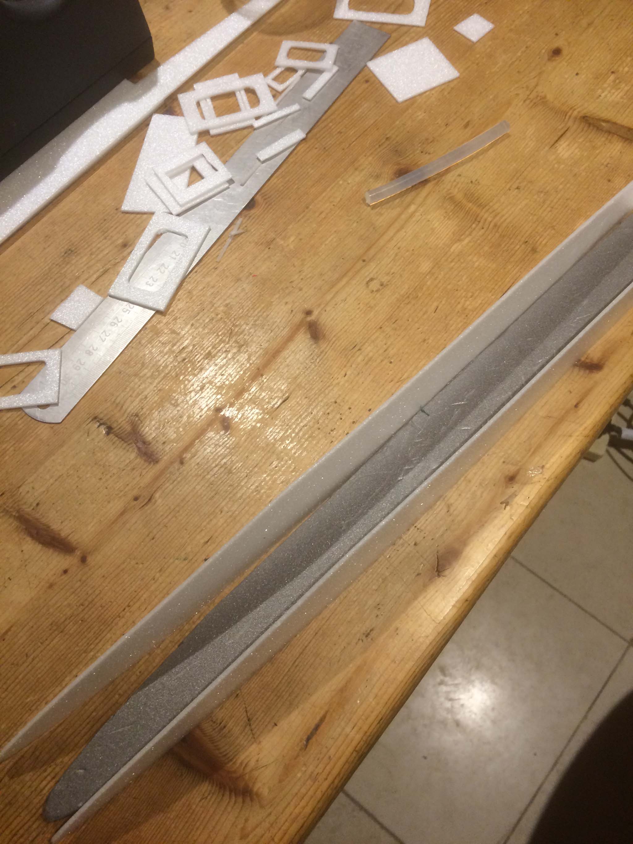

Apologies for grandmothers / sucking eggs etc

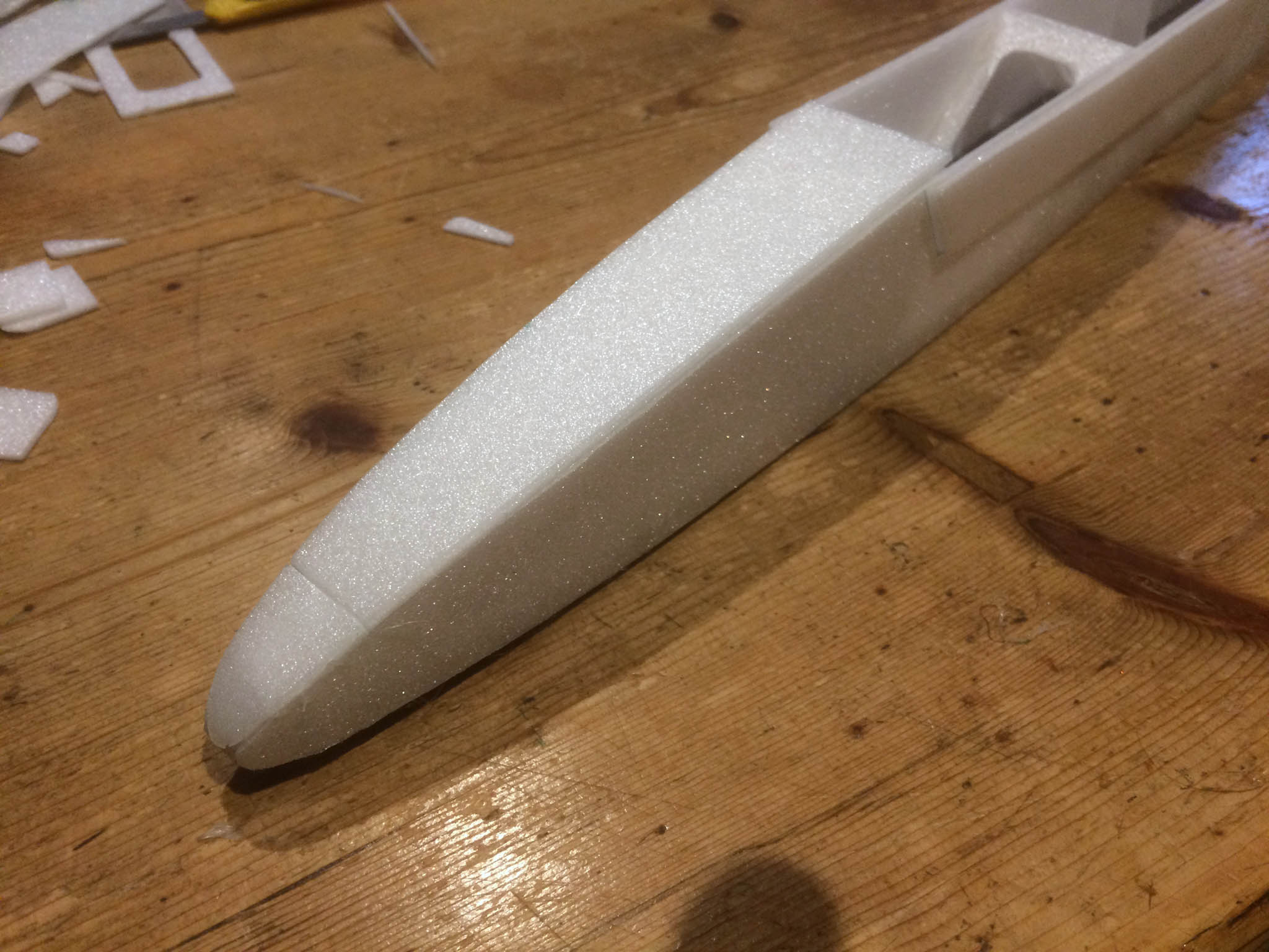

I decided to make this version with a 6mm front floor to protect from bumpy landings / keep weight forward - though not of the other 2mm versions of the fuz have had a problem so far
Important to get sides to line up so I sellotape, open un and squirt in hot glue
Pretty straightforward build - with depron / hot glue best to glue, put on flat surface - and then move. This has the advantage of making joins true but stopping things getting glued to the table!
If this happens don't pull up but rotate horizontally which unsticks. Pulling up vertically just removes large chunks of depron
I put in formers - sometimes a few extra ones diagonally or horizontally - stops crushing of fuz when you launch
Hot glue is very heavy and either dries quickly (bad) if too cool - or burns and shrinks the depron if too hot (bad!) - best solution is to glue in small sections - and put on firm surface to make sure it's true. Easy to pull in an unwanted curve with 2mm depron
Spot welding works surprisingly well and certainly better than putting too long a line of glue which will solidify and, importantly, not make a solid join + heavy into the bargain

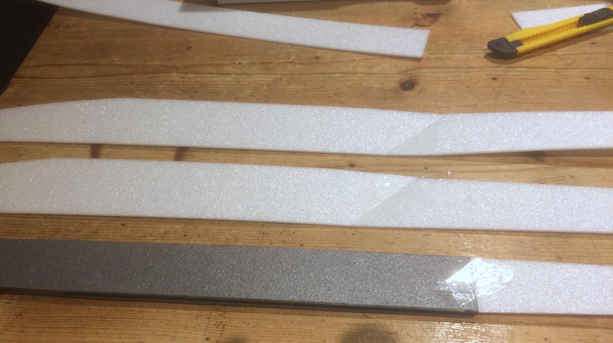

Laser cutting doesn't produce a straight cut but a slightly bevelled edge which can be useful - and lookswrong if you glue it the wrong way - e.g. fuz hatch / top rear sheet of fuz etc (and have less surface area)
Keep off cuts as sometimes useful - here to support the double layer that makes the front hatch
Hot glue allows you to (easily) build in a curve when gluing two surfaces
At rear of the hatch I have spot glued a small piece of depron at 90 degrees to the former - not much weight but far stronger - this former could easily be lite ply on a normal model but this works fine - This the 4th Zeitgeist this size.
I'm not promoting depron above balsa - but given this is the kitchen table and builds have to be fast and furious it works for me!
