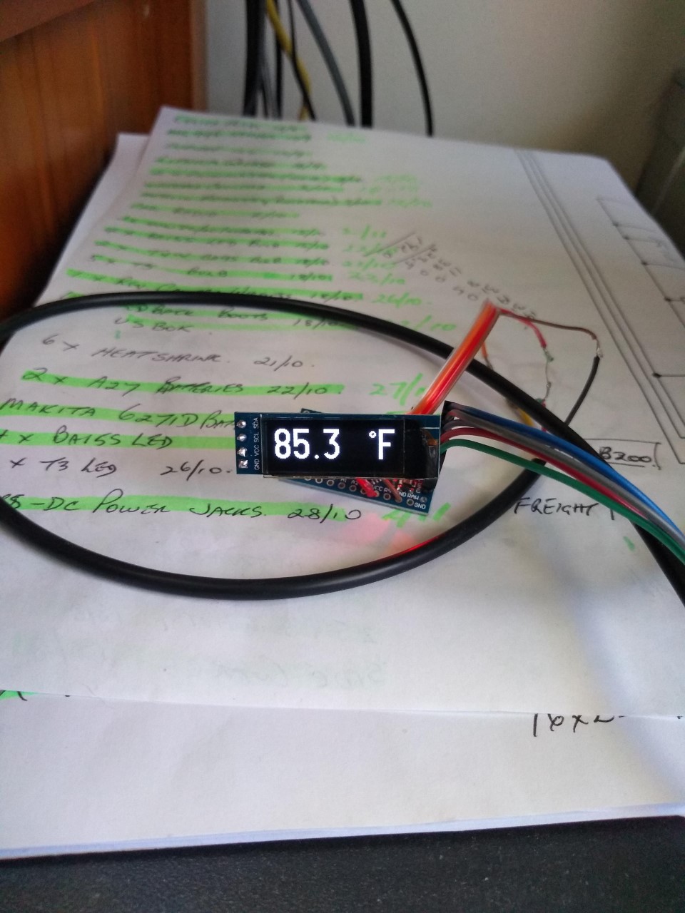

Recently did some revamping on the '78 Celica with clutch, water pump, radiator etc.
After a check run down the road, noticed the original temp guage reading a bit high.
A check with the multi and a temp probe showed that the temp was fine, just a bit out on the guage.
This has a bi-metal type regulator for the guage voltages which I replaced many moons ago but made the stuff up of positioning it in a rather hard to access place.
Well, set and forget, so should be no problem but during the above refit, must have bumped the settings.
To save all the ripping out again, decided on a 128 x 32 Oled and DS18B20 temp sensor in the dash where the air-con button used to live. RAC never ever worked properly and was abandoned yonks ago.
Anyhow, couple of pics of the yet to be completed and fitted guage, code etc.

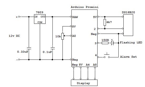

Wanted to add an alarm level trip to the above and the update delay time for the display, under certain settings, would not allow correct "blink-without-delay" timing.
So went for the simple answer, added a flashing type LED. :)
This latest version also has the ability to adjust the alarm trip level at any time with a button press and via a 15 turn pot.
I think that'll be enough for now.
Cheers Jorgo

/*128x32 Oled temp guage with alarm flashing type LED.....Celica 9_November 2020
  7809 9V regulator feeding into RAW terminal Arduino ProMini
  A4 ...SDA
  A5 ...SCL
  Flashing 3mm LED on pin 3
  DS18B20 waterproof temperature sensor assy 5V, neg and 4k7 resistor from 5v to signal....
  Temperature signal into pin 2
  Setup switch to enable a 15 turn pot to adjust the trip level during setup
  Note that the Wire.h library doesn't seem necessary.....it was included in the original code from Julian Ilett (https://www.youtube.com/watch?v=MHogSbRPa28)
