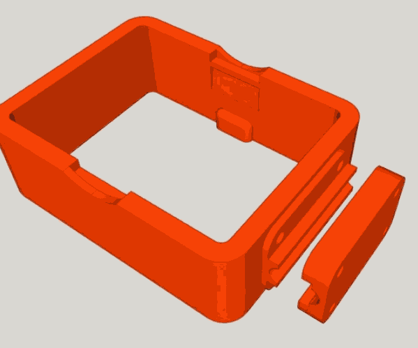

I found this one on Thingiverse. https://www.thingiverse.com/thing:1148788
I could maybe design one with some 'mounting ears' and a backplate to locate the pin connector in the right position? You need some extra-long header pins to get a reliable connection, I found, when I made my single channel transmitter. You can find some pin headers on Ebay that are longer, thinner, double-sided and even gold-plated. They are more like the connectors you find inside the module bays of quality transmitters.
