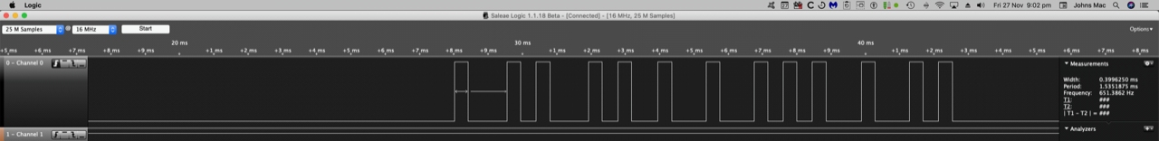

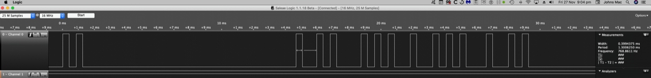

A plea on behalf of one of the Lemon module beta testers:
Could anyone post a trace of Multiplex Evo PPM please? firmware is v2.6
Cant find anything online
TIA

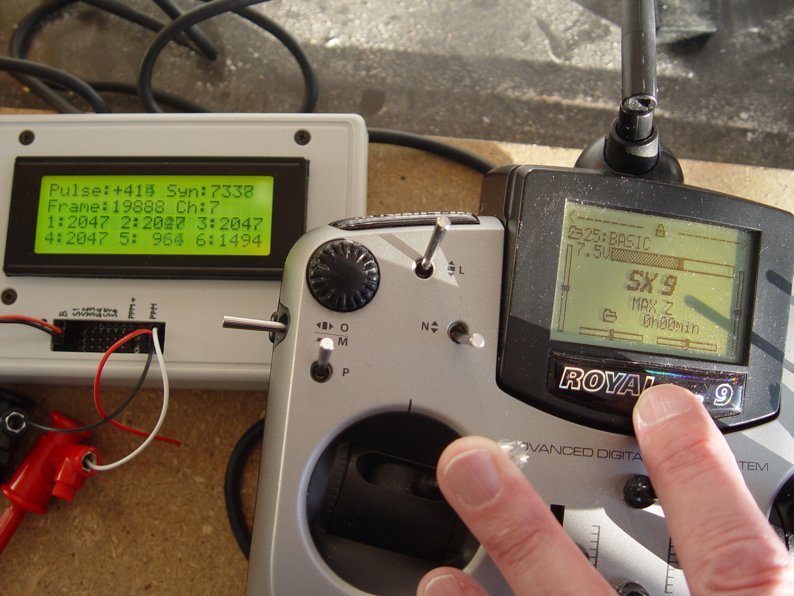

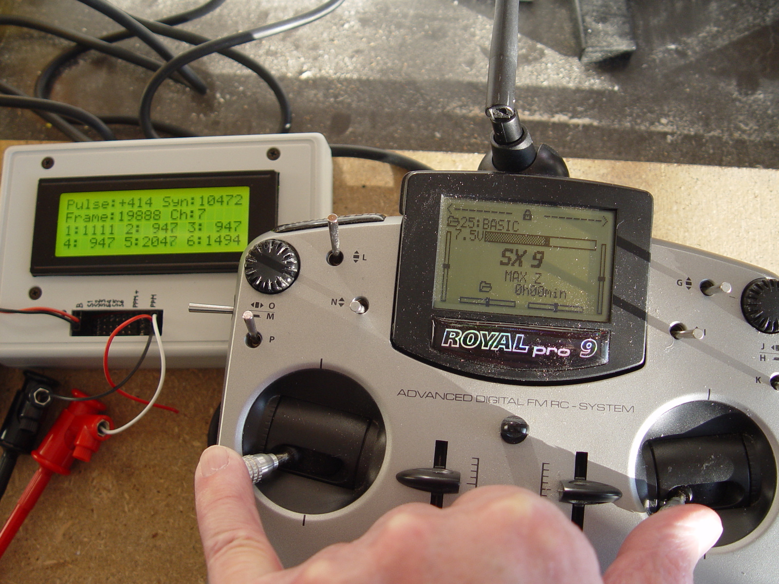

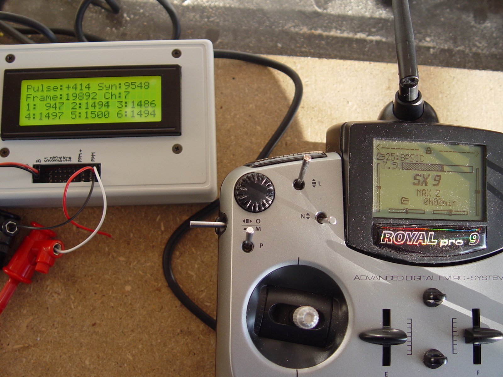

Re: Multiplex Evo PPM scope trace?
As promised, the ppm stream from my Royal pro/SX, hooked up to a pulse meter. The only way I could get a reading is by connecting ground on the meter to the signal from the Tx, and signal in on the meter to the + 7.2V from the Tx (due to the trainer/student cable I was using, which only had those connections available).
Now I should mention that this is the outcome of the Tx in regular 2.4 GHz transmitting mode. Once you change to student mode it all becomes different, and you get to choose between MPX and UNI modes, this to allow older Tx to function as teacher.
As you can see in the top picture, the neutral is just about 1.5 ms (ch1 is the throttle on safety switch).
The middle picture is all sticks in the top-right corner (note that MPX has fixed end points, not affected by the trims, except throttle).
The bottom similar with all sticks in the bottom-left corner.
The frame rate is constant in all three pictures, the sync pulse is changing.
Hope this helps, cheers,
Max.
