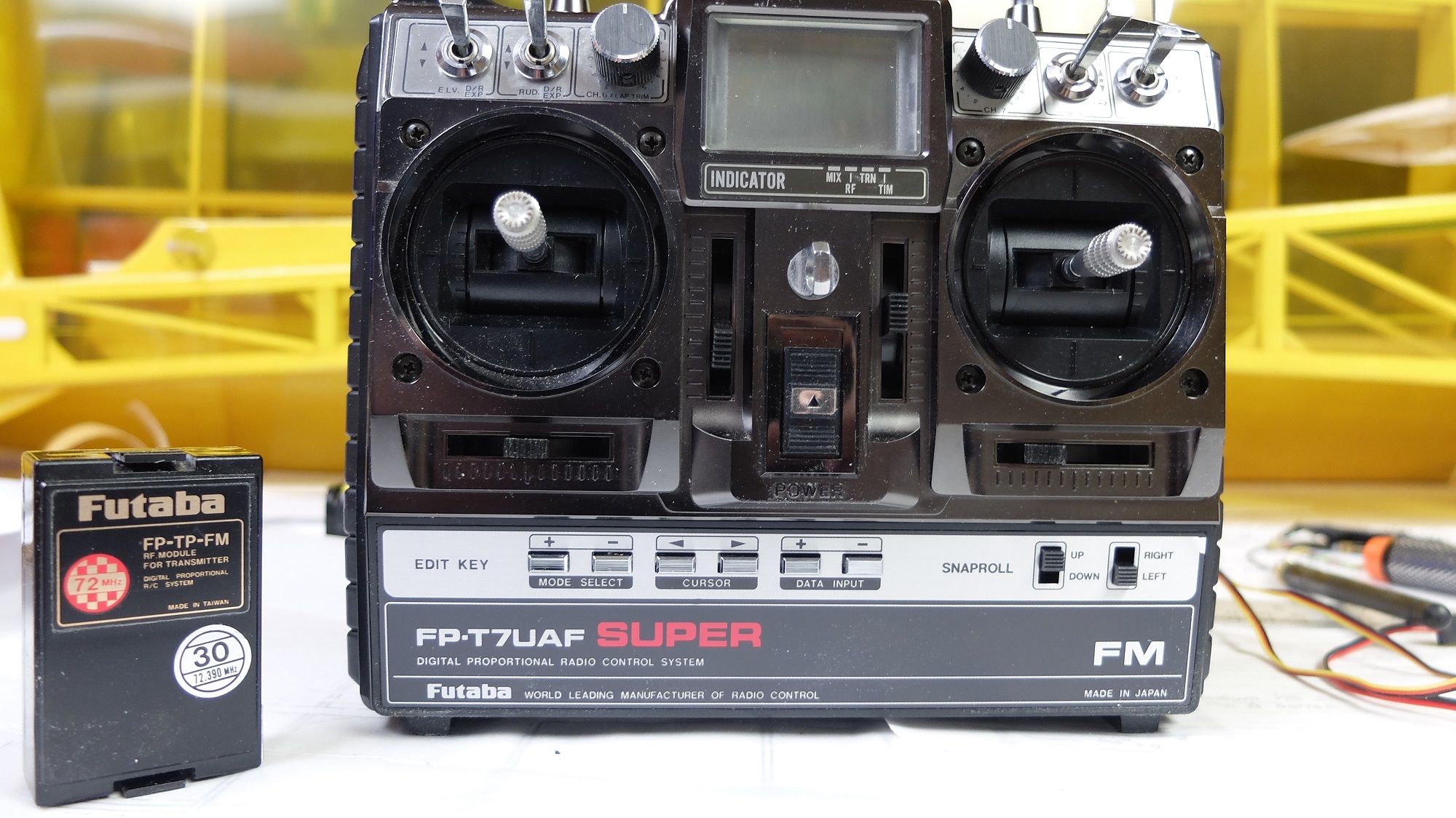

I have this older but still functional Futaba transmitter that I would like to put a FrSky XHT module in. I have never changed over a standard transmitter in the past and do want to mess it up (i.e. let the smoke out)
Although it is on a still legitimate 72MHz frequency channel most clubs in our area frown on their use due to "age" and being on 72MHz.

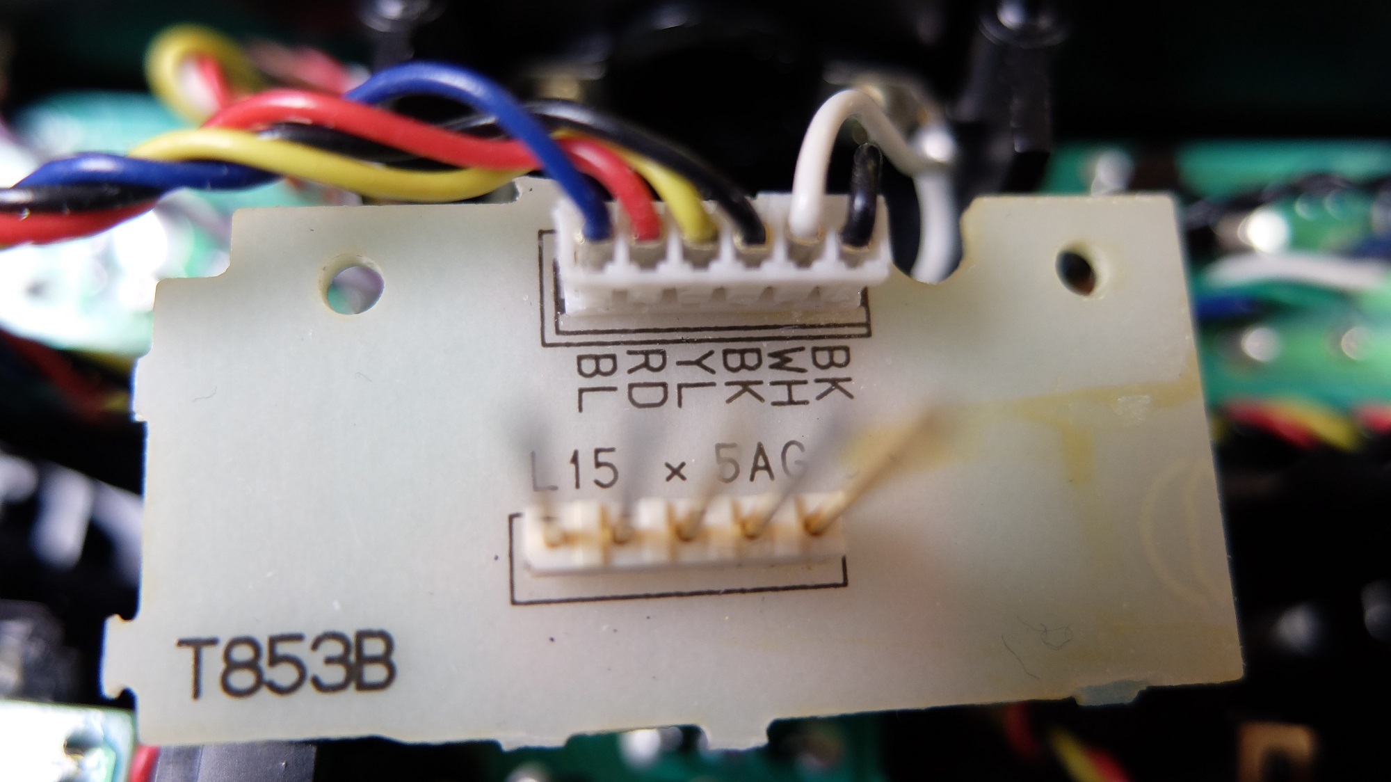

I removed the back of the transmitter to locate the board & contacts for the plug in module and found the T853B board where the module plugs into.
I am sure the blue wire is the PPM line, Red positive, I do not know what the yellow wire is for??, Black is ground, White is the antenna and the other Black is also ground.
Questions What is the yellow for? Should I remove it or leave it in place as the XHT module leaves the pin vacant?
Should I snip off the white wires for the antenna or can I leave them in place as the XHT has no connection to that pin either.

Re: Futaba FP-T7UAF transmitter conversion
Mike, look at this thread:
viewtopic.php?f=62&t=91&p=171&hilit=Fut ... e+pin#p171
Thanks Wayne.
Looks like I can simply connect the XHT PPM, Positive and Negative wires and leave the rest alone.
Thought there would be more to it than that.
Some manufacturers use additional pins for functions such as channel check (is frequency clear before transmitting), RF signal strength, telemetry, etc. Best is try the simple approach first - I'm sure it will work.
Hi PhilPhil_G wrote: 20 Jan 2021, 10:40 Is that a standard Futaba module? if so I'd find a DFT which would just slot in, job jobbed![]()
Yes that is a standard Futaba module. I did look around for a DFT plug in unit to no avail. When I press the order button I get a message saying either out of stock or discontinued. Swap meets have been on hold for some time due to Corona. I thought I would try the XHT board for now.
In the mean time I did connect my spare XHT to the PPM, Pos. & Ground leaving the yellow and white wires in place and it did bind to the V8R7-II receiver and the sticks operated the servos. I was not sure if doing this I might cause damage in the long term to what ever the yellow wire was doing with the old module.
