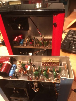

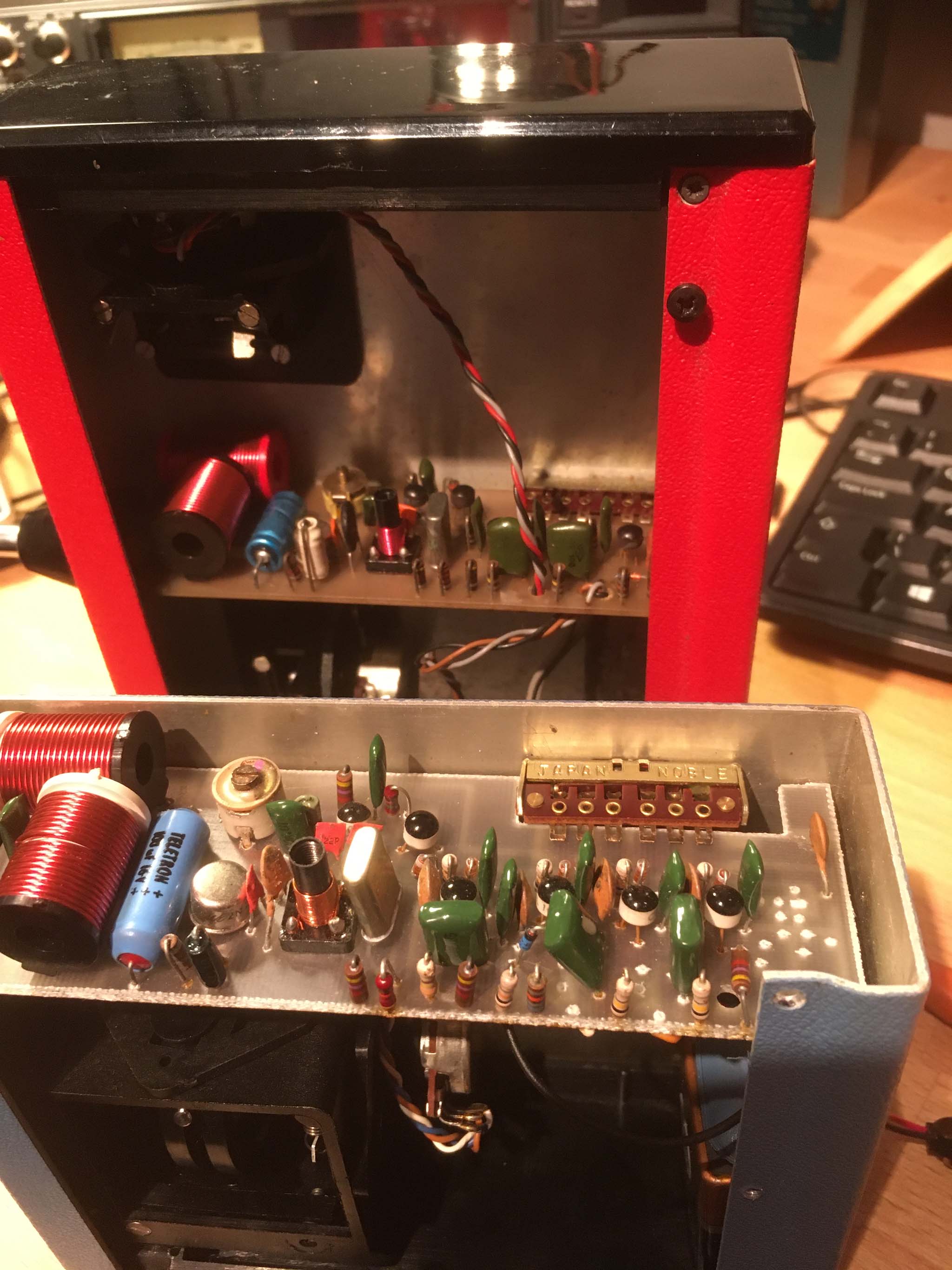

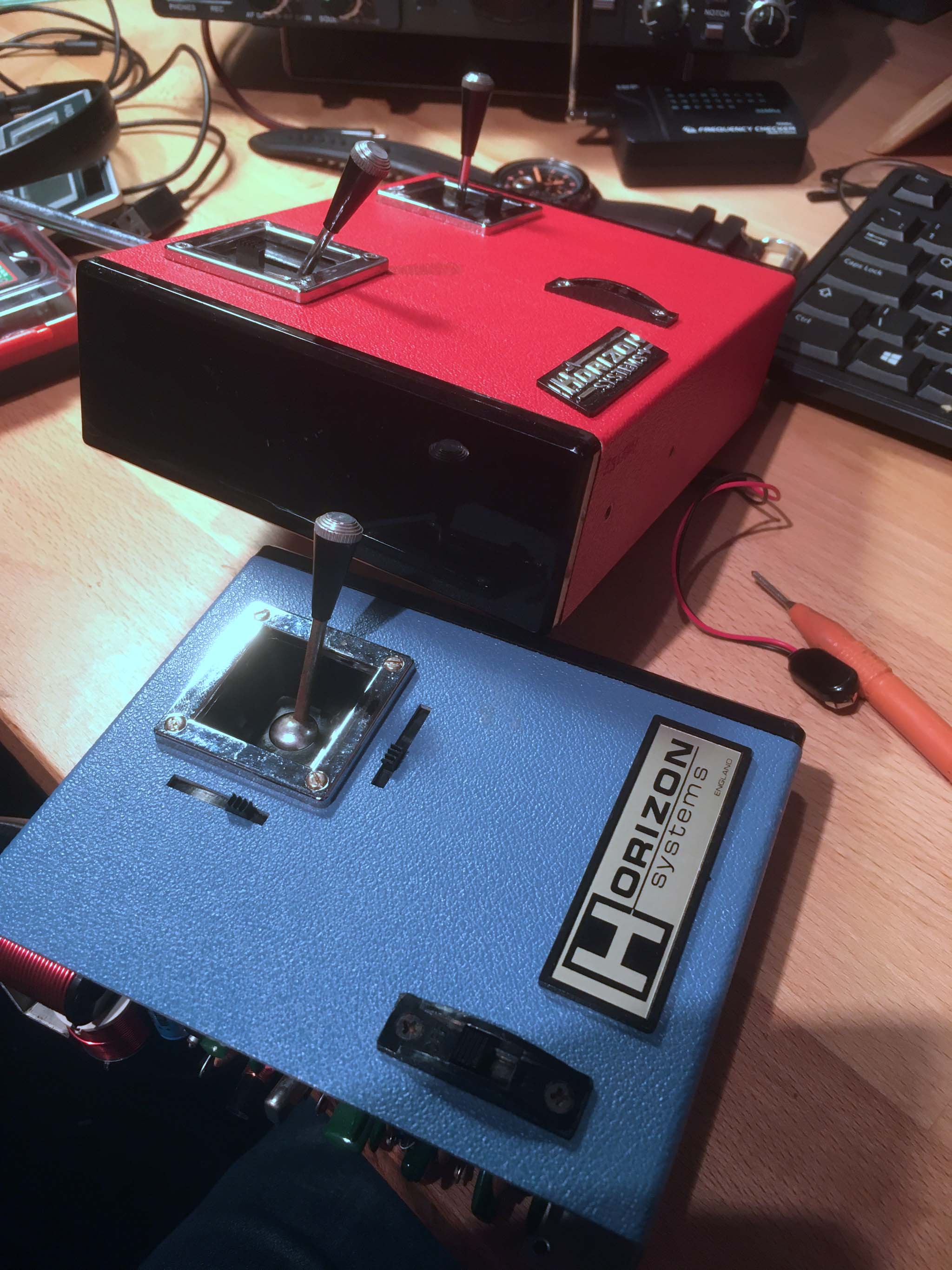

Two Horizons. One twin stick in red. One single stick in blue. Both with the identical problem. Both generate RF. However when listened to on a Communications receiver they simply squeal. A clue. The red oneWorked for the first second when connected to power but quickly descended into the squeal from a strong digital pulse. I’m wondering if it’s faulty capacitor(s) as I understand these are often needing replacement with age. Or maybe the odd transistor? Most of the transistors are BC108’s . It would be nice to get one of them working again on 27 As I have a nice original receiver and two servos. Otherwise the red one will be converted to 40 and the blue one to 35
Both have identical circuits save for the odd slightly different component. Thanks guys!

Try powering it from a bench PSU and leaving it switched on overnight, give the electrolytics a chance to reform.

The blue one was called a 'Chindit' and was (later) also available as a kit. Its usually a red case painted blue, dont scratch it!
They were unreliable back in their day so personally I wouldnt bother, I'd just convert them. You can fit a V8R4 inside the Horizon rx for authenticity!

To be honest the single stick stick quality is rubbish. I need to repair it. Stuart M has a red cased version and I’m sure that will have a Macgregor stick unit which In my opinion is far superior.
My 4 channel Horizon has Macgregor sticks and is one of the earlier versions.
