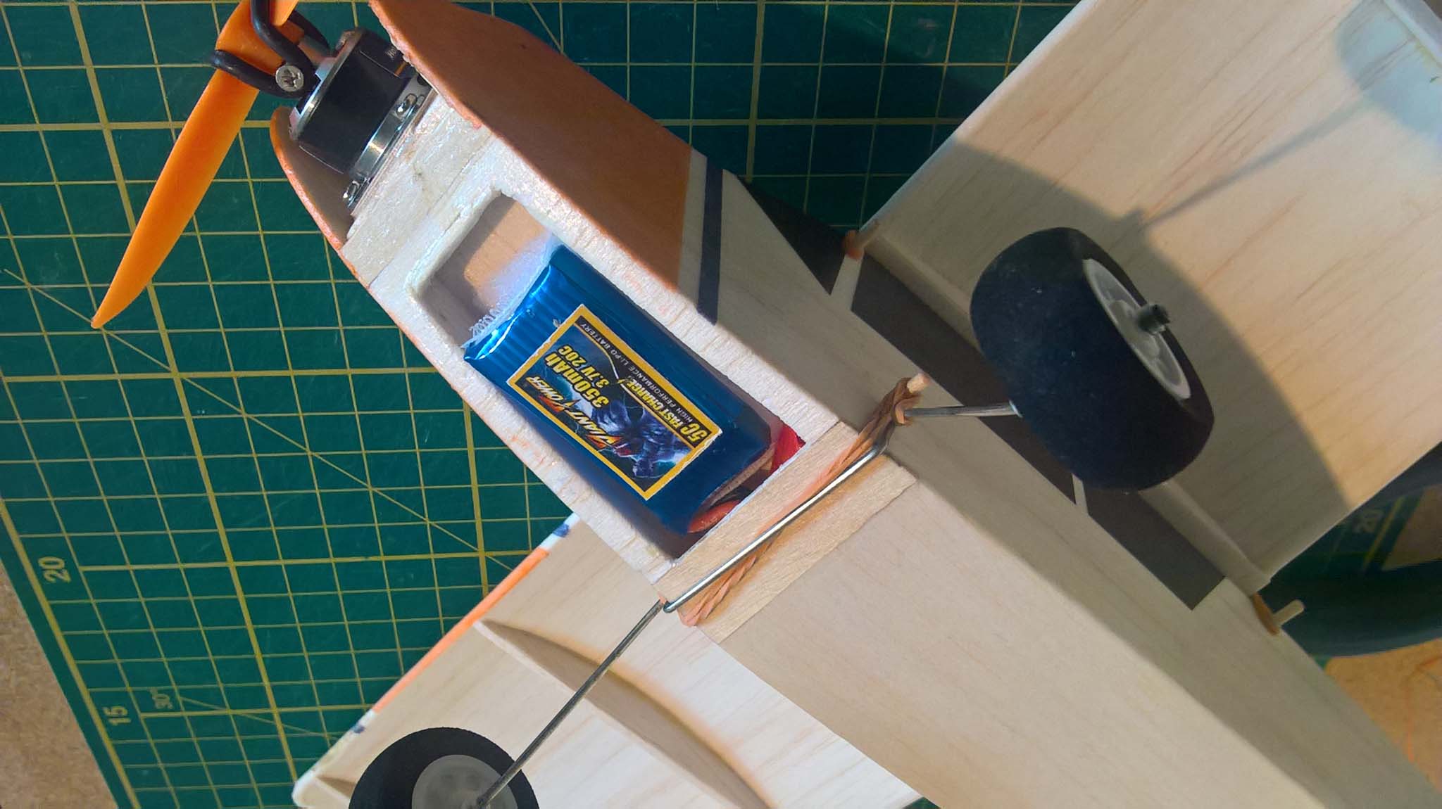

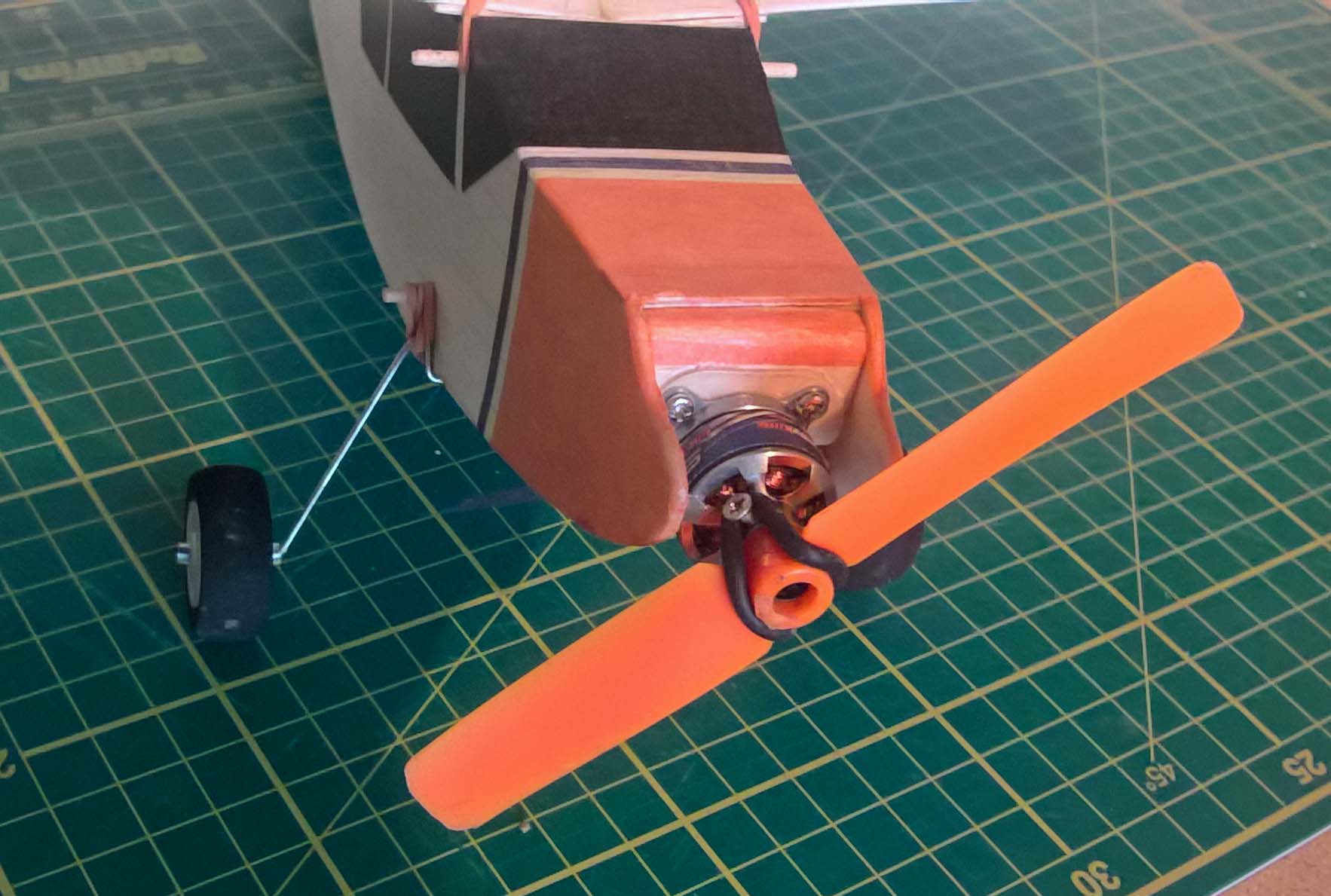

Tobe suggested this 1S setup for small models, and is what I used in my Pageboy with 15" span:
https://hobbyking.com/en_us/hobbyking-1 ... 200kv.html
https://hobbyking.com/en_us/hobbyking-x ... oller.html
For the propeller I used:
Gemfan 4" inch 4025
Looks like these GWS propellers are the same on Hobbyking and available in various colors like Gemfan:
https://hobbyking.com/en_us/gws-ep-prop ... s-set.html
Hope this helps,
Carl
