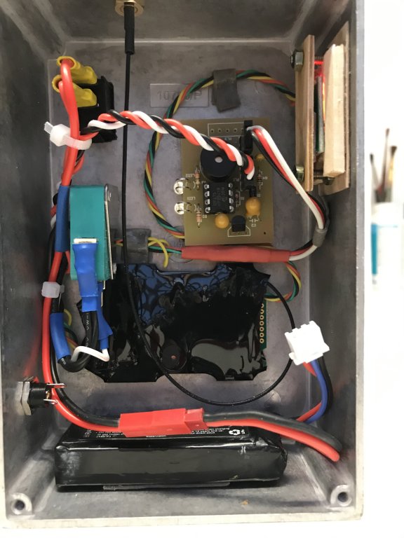

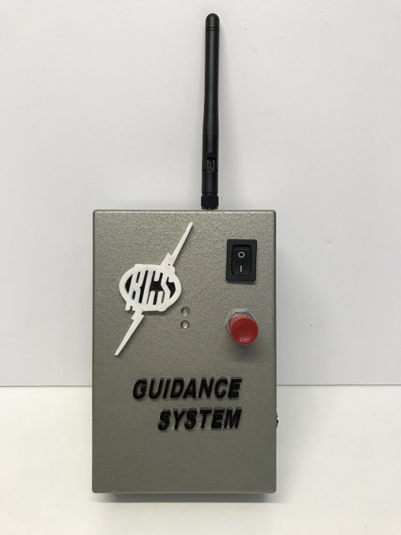

Here is my RCS replica Single channel Transmitter
This has been built with Phil Greens encoder and a FrSky XHT 11 R/F module and V8 receiver.
Many thanks to Phil Green, Roger Macey and those members on the Forum who answered my questions and gave guidance
RCS Single Channel Transmitter

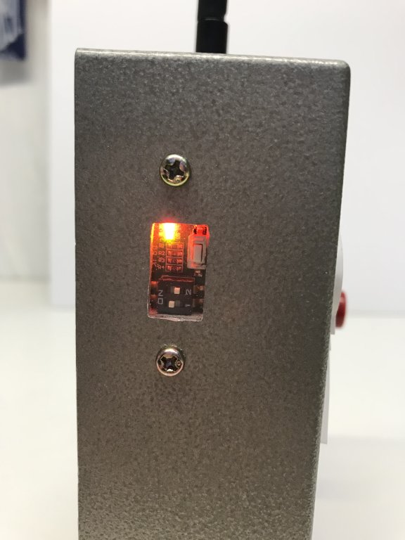

I for got to add, I made a frame for the binding board and mounted it on the inside of the TX behind a celluloid window with a small hole to allow access to the switch.

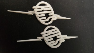

Where did you get/ how did you make the RCS logo?
- Posts: 21
- Joined: 09 Dec 2020, 10:42
Re: RCS Single Channel Transmitter
Hello - It was made by Roger Macey, he has posted his RCS TX and how it was made, It is a few postings below mine. From his posting I have copied the relevant paragraph.
The RCS Badge was created originally in 2D (*.SVG format) using Microsoft Excel Insert Shapes, and working from whatever old pictures I could find, then converted online into 3D (*.STL format) using Selva3D, and finally printed on my “toy” Da Vinci Mini 3D Printer, followed by a little sanding here and there. I know it’s not 100% true to the original badge, but looks OK from a distance !
The GUIDANCE SYSTEM was from a local specalist print company, it was lazer cut and the letters pressed out. - Fun sticking them on

I too want to add my congratulations!
Is the .stl file for the RCS badge available anywhere or would Roger Macey allow you put it on this forum?
- Posts: 406
I posted the stl. file of my RCS badge I made some time ago in the 3D print section.
viewtopic.php?f=72&t=1215&p=10271#p10271

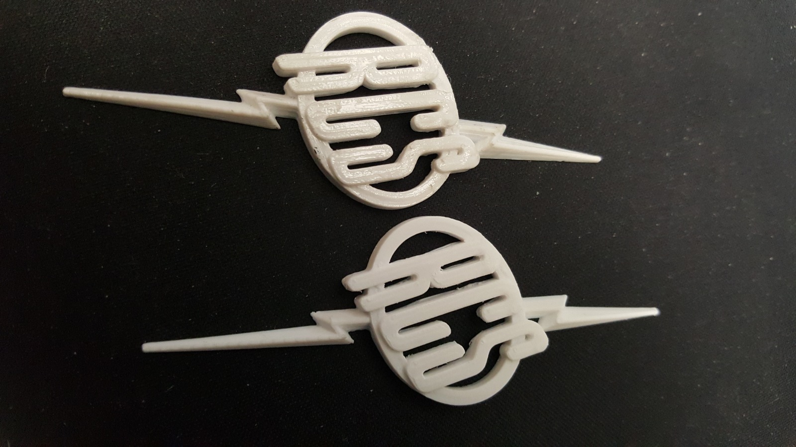

- Posts: 589
- Posts: 589

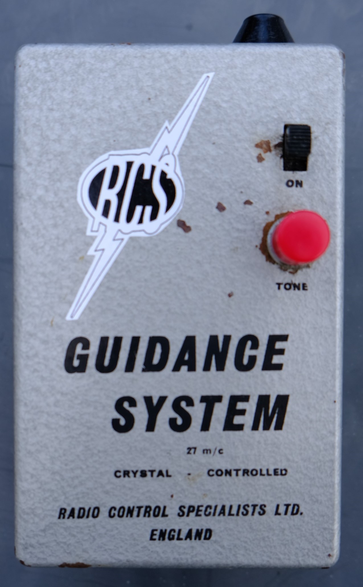

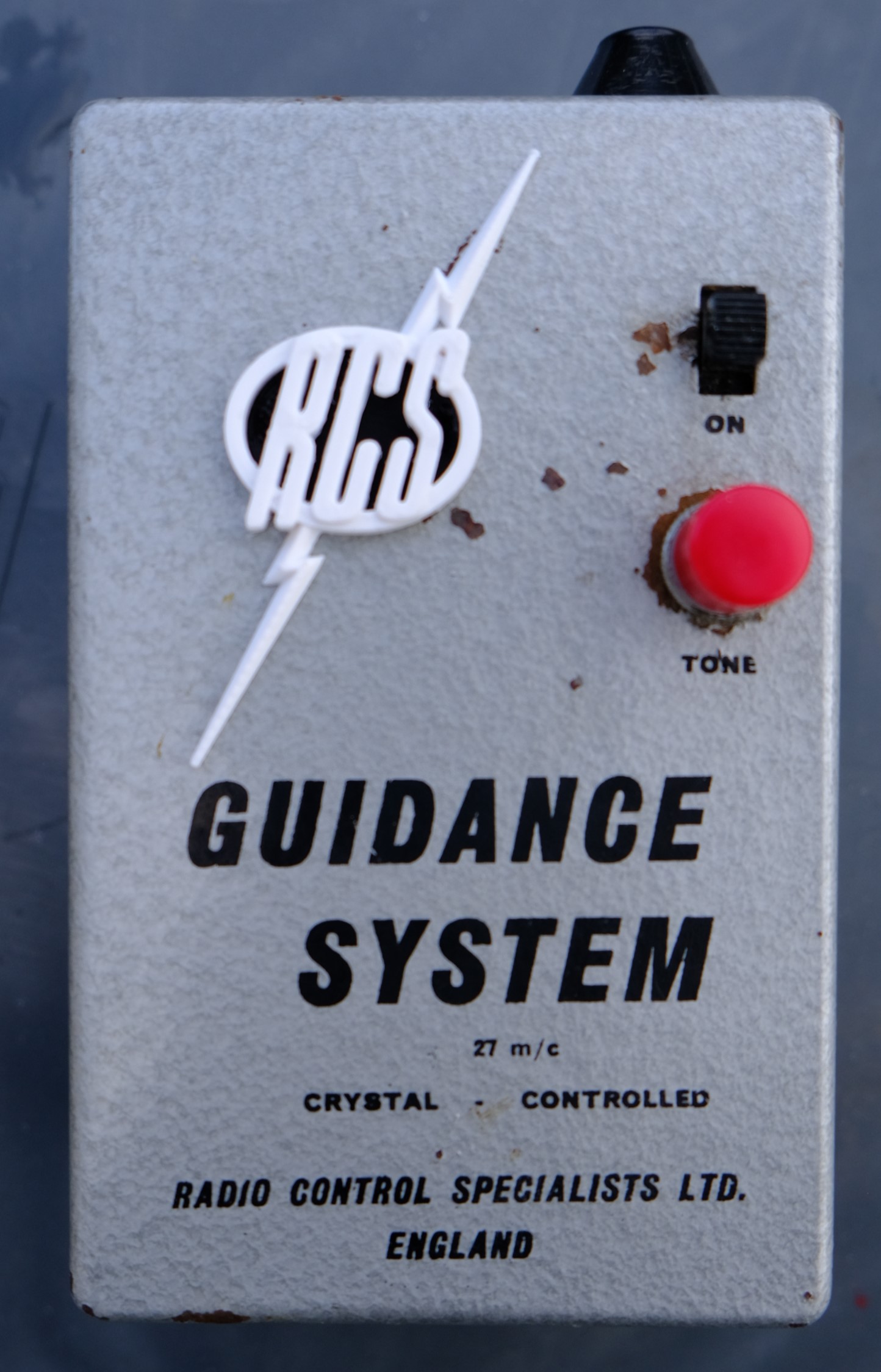

Here is a before and after, as you can see I had a sticker based on the files on the forum and compared to the 3D badge, there is a noticeable difference in the overall effect of the Tx.
