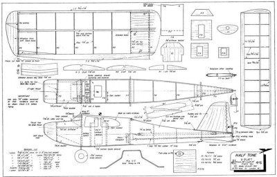

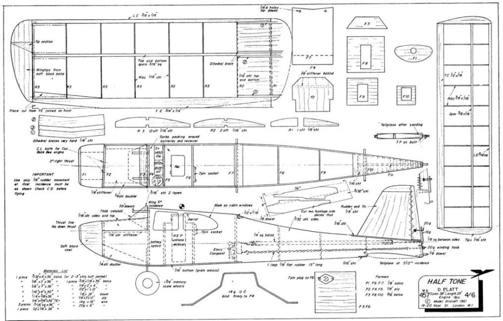

I printed off the plans from OZ - https://outerzone.co.uk/plan_details.asp?ID=5673 - then made templates by gluing the relevant parts to thin cardboard (in my case, a cereal box).
Given the material I was going to use, I had to make a few mods to the structure.
  • fuse sides and formers would be 5mm foam board
  • fuselage top & bottom would be 2 mm foam board that I had brought with me
  • the tailplane would be a single sheet of 5mm foam board with a bamboo skewer to reinforce the LE.
  • the wing would be a single sheet of 5mm foam board on the bottom with 2 mm foam board top sheeting.
  • The wing spar would be a bamboo skewer top & bottom with a shear web from 5mm foam board

Shaun wrote: 04 Apr 2021, 10:13 Great little plane.. I featured it as an RCM&E free plan back in 2017.
Flys on rudder, throttle with e-power.
Shaun,
Did you stick with the 1/8" rudder movement as shown on the plan? Clearly there is plenty of rudder authority!
Posts: 1232
Re: Dave Platt Half Tone
I had more Wayne. I seem to remember I flew it on a 1+1 converted Mac G propo/3 position throttle set. 1/8" would be a good starting point for bang bang rudder.
