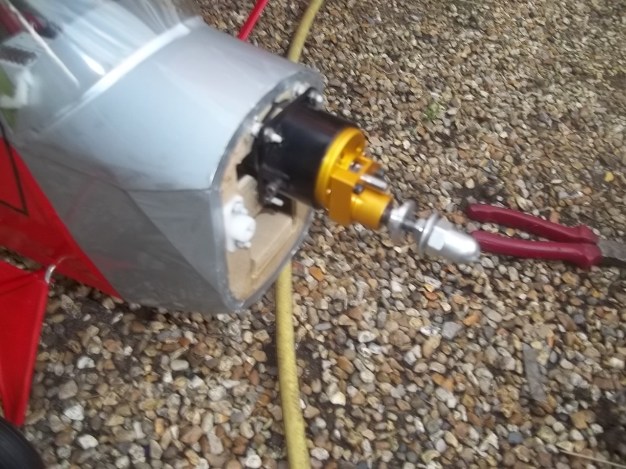

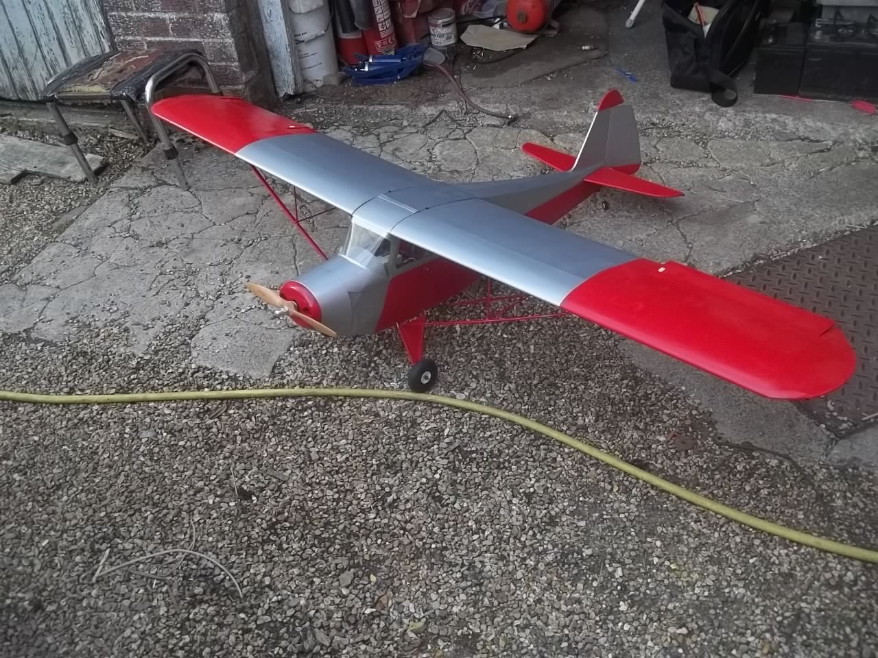

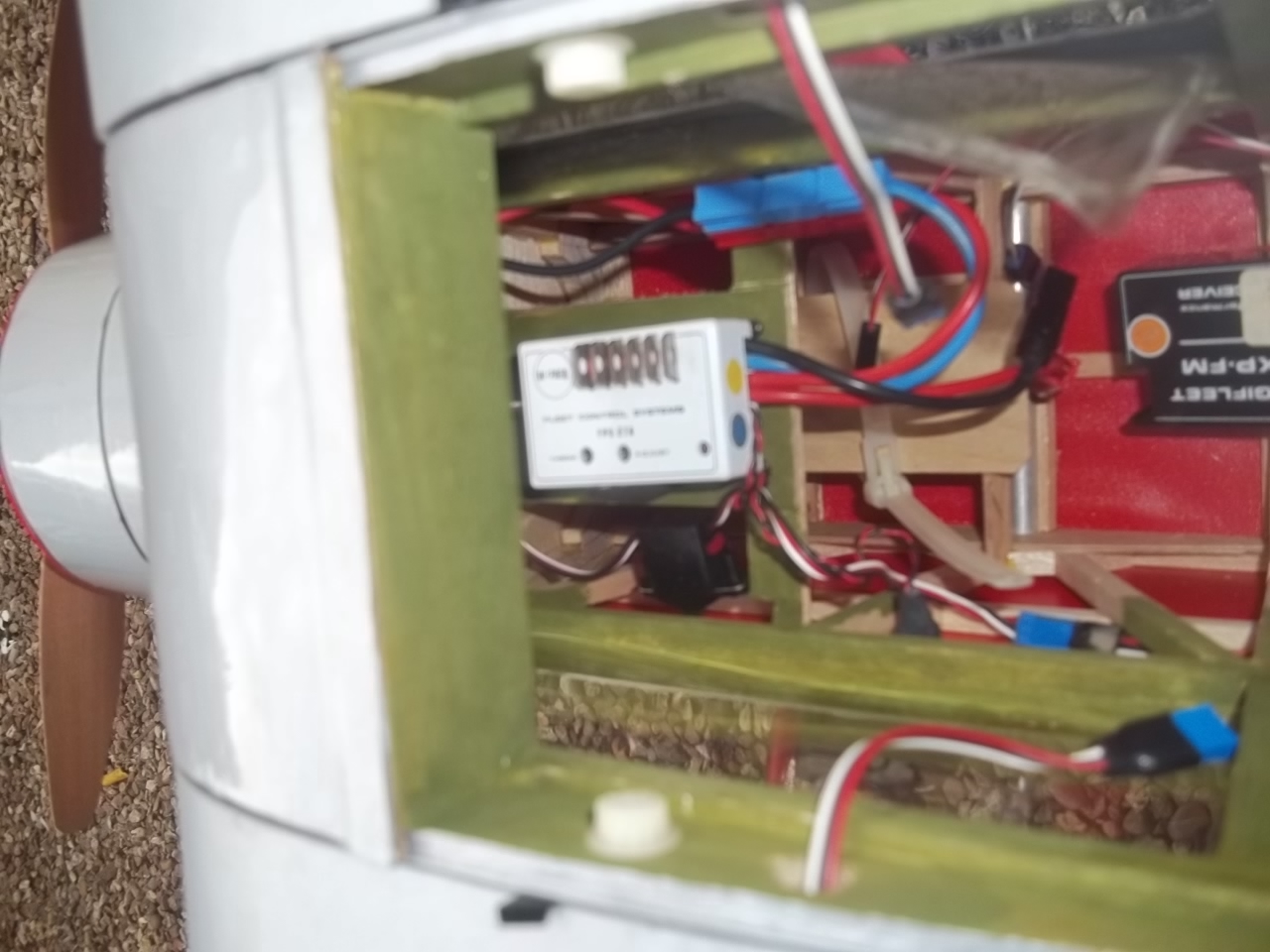

I have acquired a rather nice Aeronca with an Astro geared brushed motor that is set up for Nicads, is there anything available to protect the lipos I will use to fly it on? Google has not helped and struggling to find a 3/4s brushed speed controller for lipos. the plane has a Fleet brushed ESC and I would like to use it if possible, I buggered up a good lipo pack before flying a brushed motor plane! Any help and advice will be gratefully received

Thanks for the replies, I already have ESCs and brushless motors in the shed that would power this plane but would like to use the original power set up, much as we like to use our original radios but would need to use my lipos, I went through the nicad, buggy motor, microswitch set up many years ago when electric flight was mostly just a dream and don't want to recreate that. My radio does not have telemetry, I have to fly a single stick with throttle conversion, a friend gave me a RC LI-PROTECTOR but research has shown this is for brushless motors assume from the time when the early ESC did not protect your lipo from over discharge. I was just hoping there would be something suitable/ similar for brushed motors. I have already converted another model, a twin, that came from the same source to brushless and lipo. I just would like to use the original Astro set up. Thanks once again for your advice and help!

You say you are having trouble finding a 3S/4S brushed ESC, but if it's the standard Astro 05 geared motor I wouldn't advise you to use a 3S or 4S Lipo, but take Martin's advice and use a 2S Lipo. My original Astro 05 was always run on either 7S or 8S NiMH, I don't think it would take more cells and a 2S Lipo is an equivalent voltage. If I remember it used to take around 35A and give around 300W and the standard Fleet FPS-36A ESC was a good match. If you can't find a suitable ESC, I've probably got a Multiplex 40A ESC that is NiMH/2S Lipo compatible in my spares box. Most Astro motors/ESC were as efficient as modern brushless motors, so if your Aeronca is under 5lb, it should fly fine with a 2S 2200mAH Lipo.

My money's on it being an Astro Flight Porterfield Collegiate.
