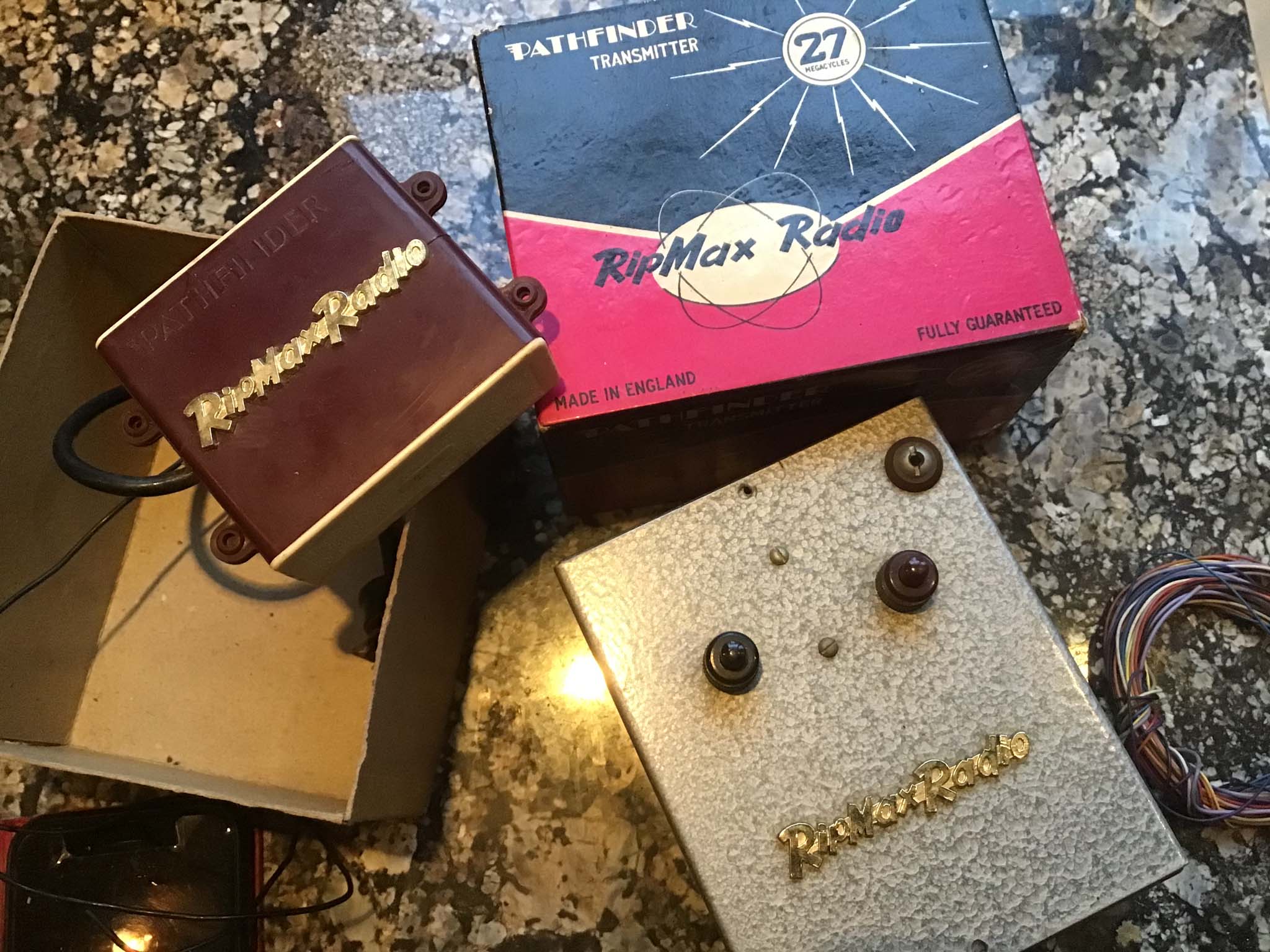

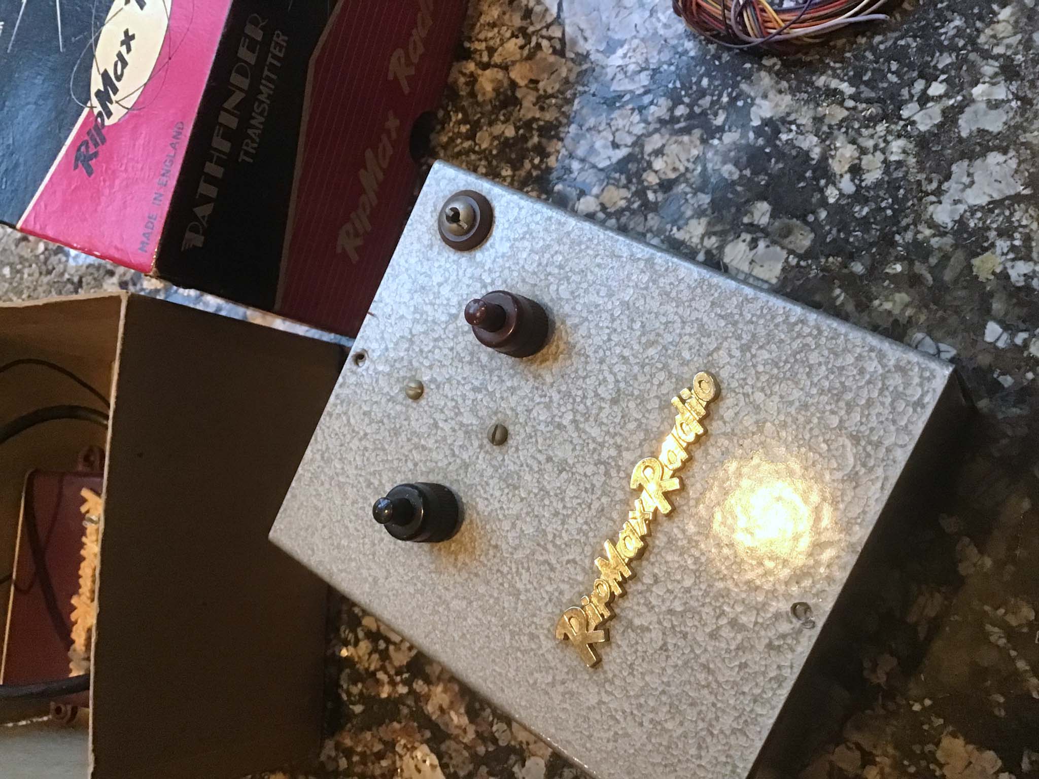

Well I have been very fortunate having been given a Ripmax Pathfinder Valve Tx and Rx. The Tx is still in its box.

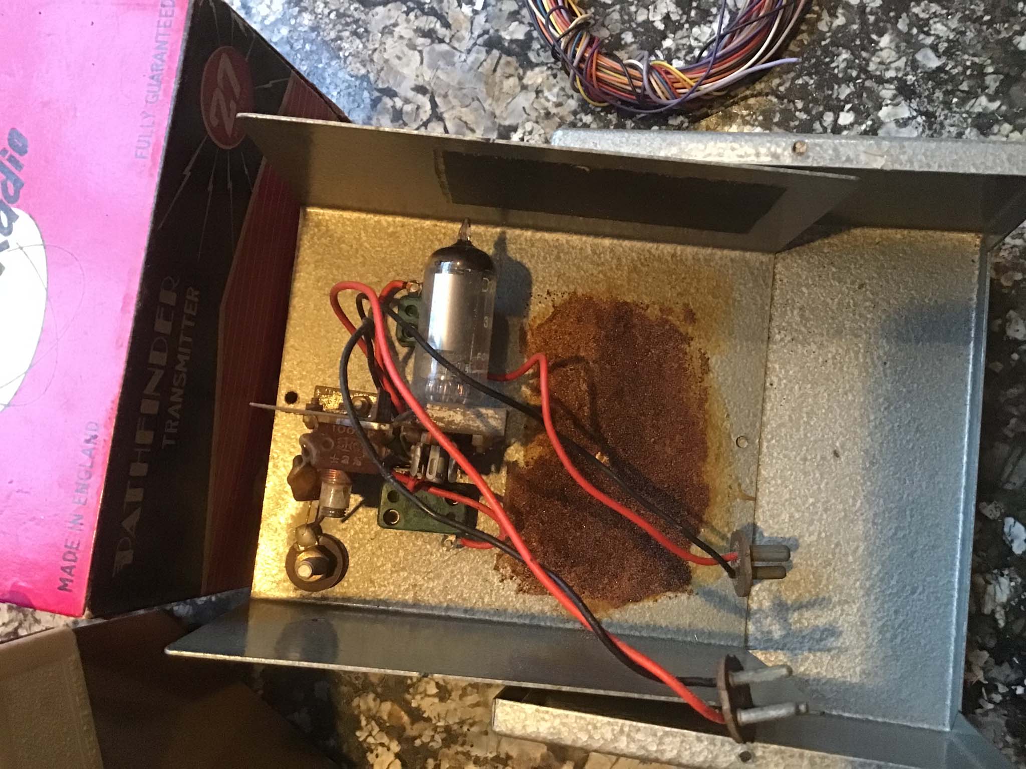

I am flummoxed by the transmitter . It has two push to make buttons on the front and a curious connection for what can only be the aerial.
Perhaps one of the push to make buttons should stay locked down. In other words the on off switch. But it doesn’t! And neither does the other. I’d be really pleased to hear from somebody who could tell me how this set would be operated. Whether the aerial connection was for a long wire feed to the antenna itself. Or simply a fine wire whip the antenna was poked in the hole?

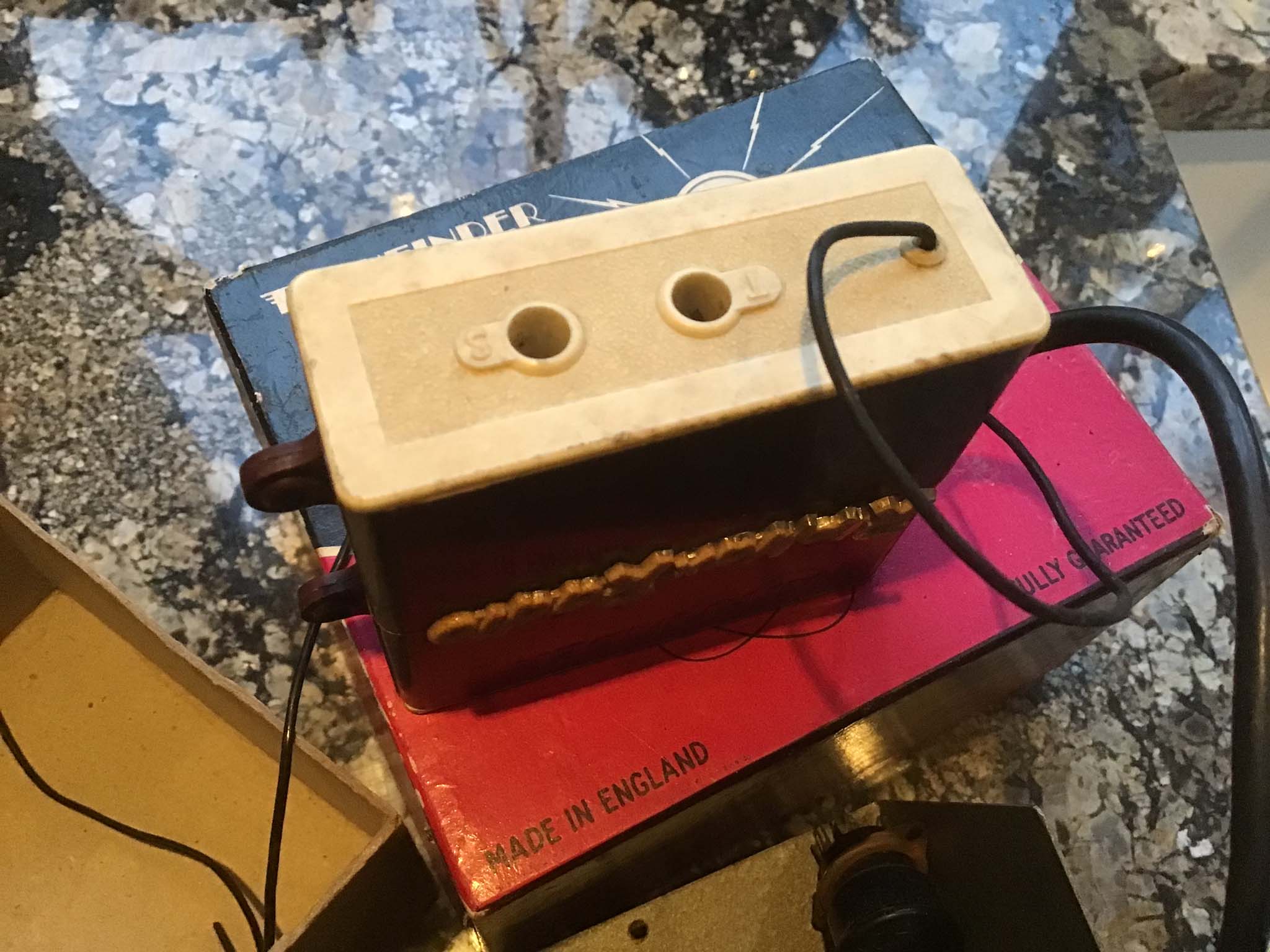

Now the receiver is completely sealed and I’m sure I read somewhere on this forum that this was something to do with making it tamperproof. And if you did manage to tamper with it your guarantee would be void. There are two holes on one of the long sides these are clearly for adjusting core slugs. With a non metallic screwdriver I assume.

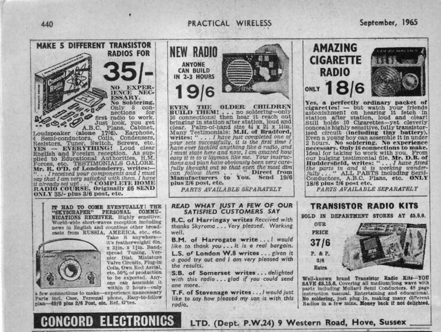

Back to the transmitter. Does anyone remember practical wireless magazine and all of those weird and wonderful adverts in the back? I’m absolutely sure there was one particular advert that was for a radio control system that looked just like the Pathfinder with two push buttons on the front. It didn’t bear the Ripmax name tag but otherwise looked very similar. I have a feeling it came under the title “boffin projects “ I remember my mum laughing at this!

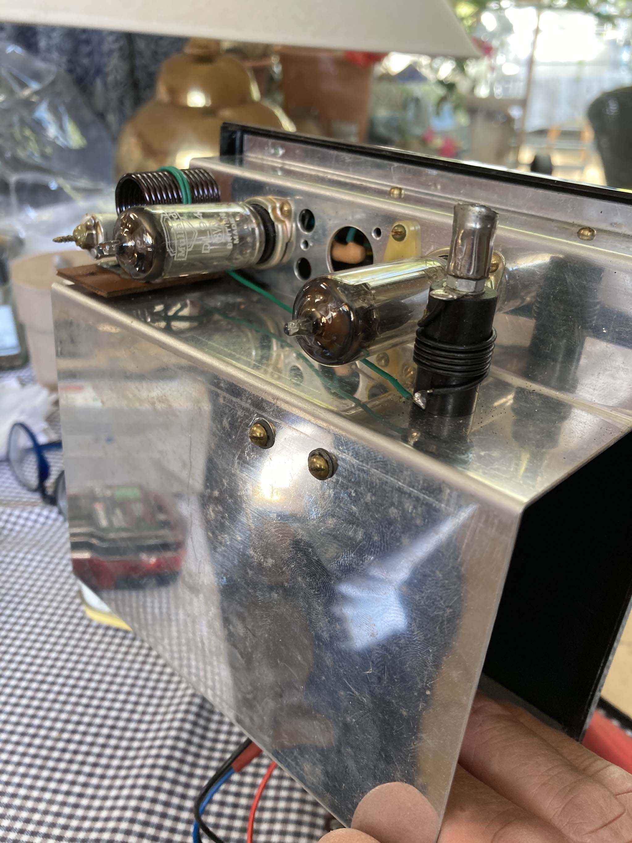

This was the first RipMax Pathfinder.
Antenna was a 36" piece of 12g piano wire.
Left hand button was known as the economy button which turns on the valve heater so you would be ready to radiate a signal when the right button was keyed. Both buttons are non latching. I seem to remember that the instructions suggested you stuck a cork on the end of the aerial so you didn't blind your modelling mates.
HT was 90v, LT was 1.5v.
Valve 3V4
Tx was designed to be hand held in operation and never resting on the ground as the capacitance effect would significantly affect the radiated signal.
The rx had a single 3V4 valve. Batteries were again 90 v for the HT and a 1.5 v for the LT.
To open the RX you needed to cut around the glue line under the badge. Rx antenna should be 30".
RX output wire key..
Black - common neg
Orange - LT +ve
Red - HT +ve
White - relay common
Green - N/C
Blue - N/O
Brown - unused
Your Tx is nicer than mine. Mine is missing the gold badge.

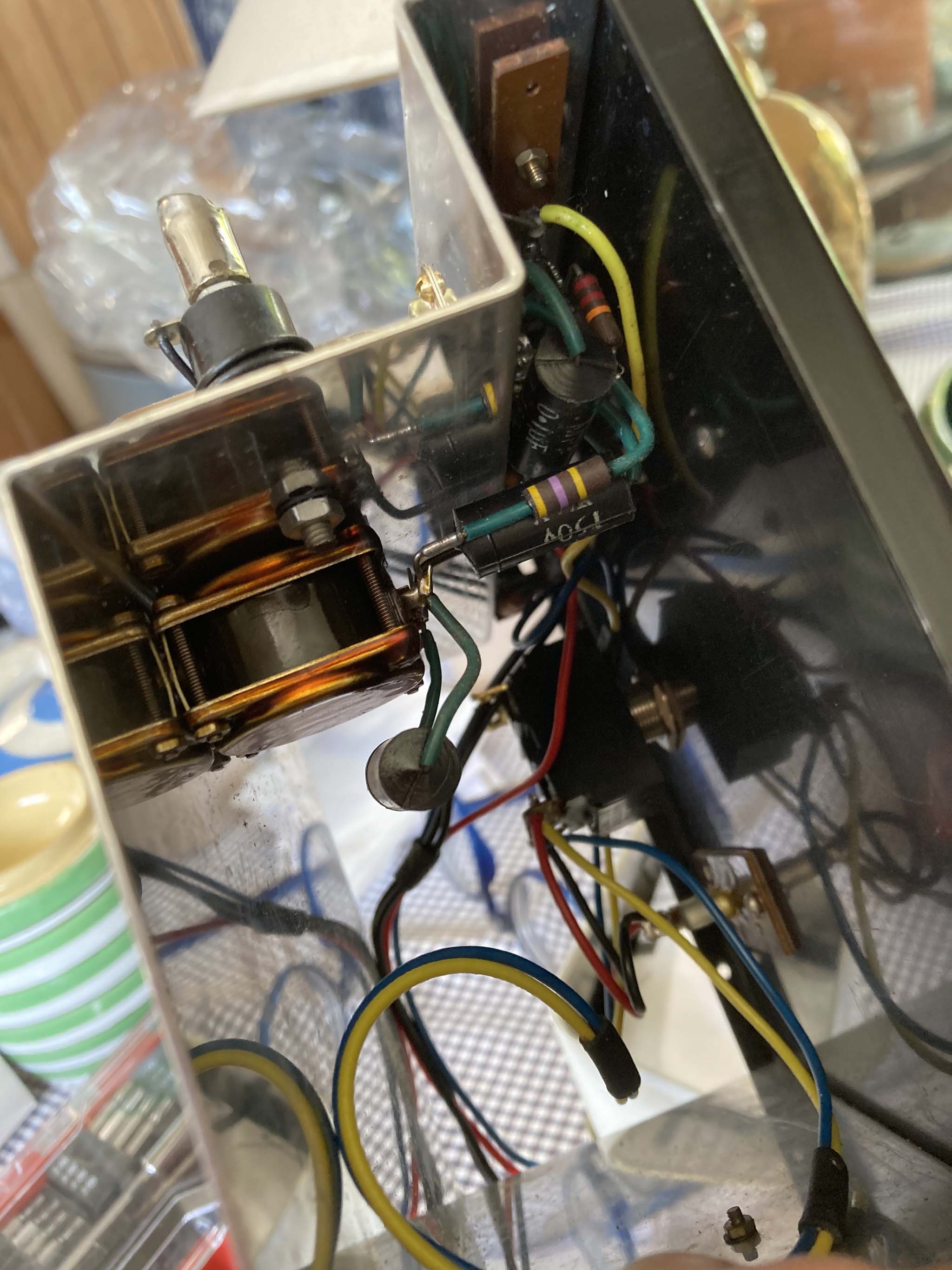

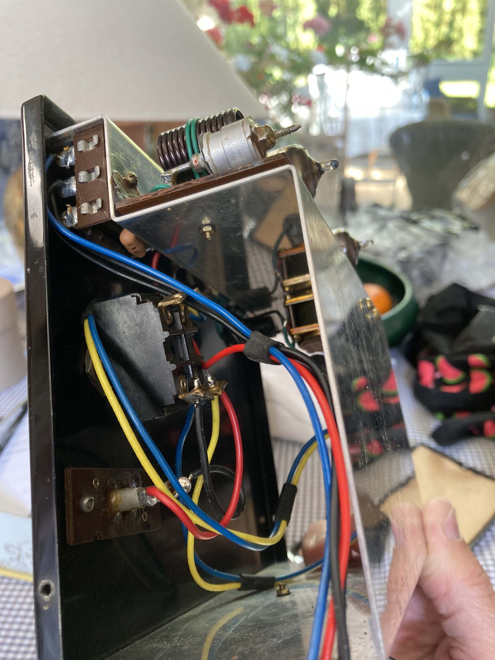

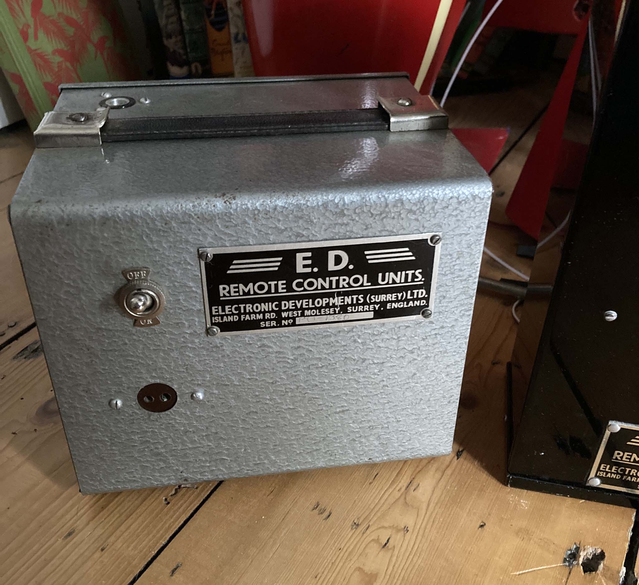

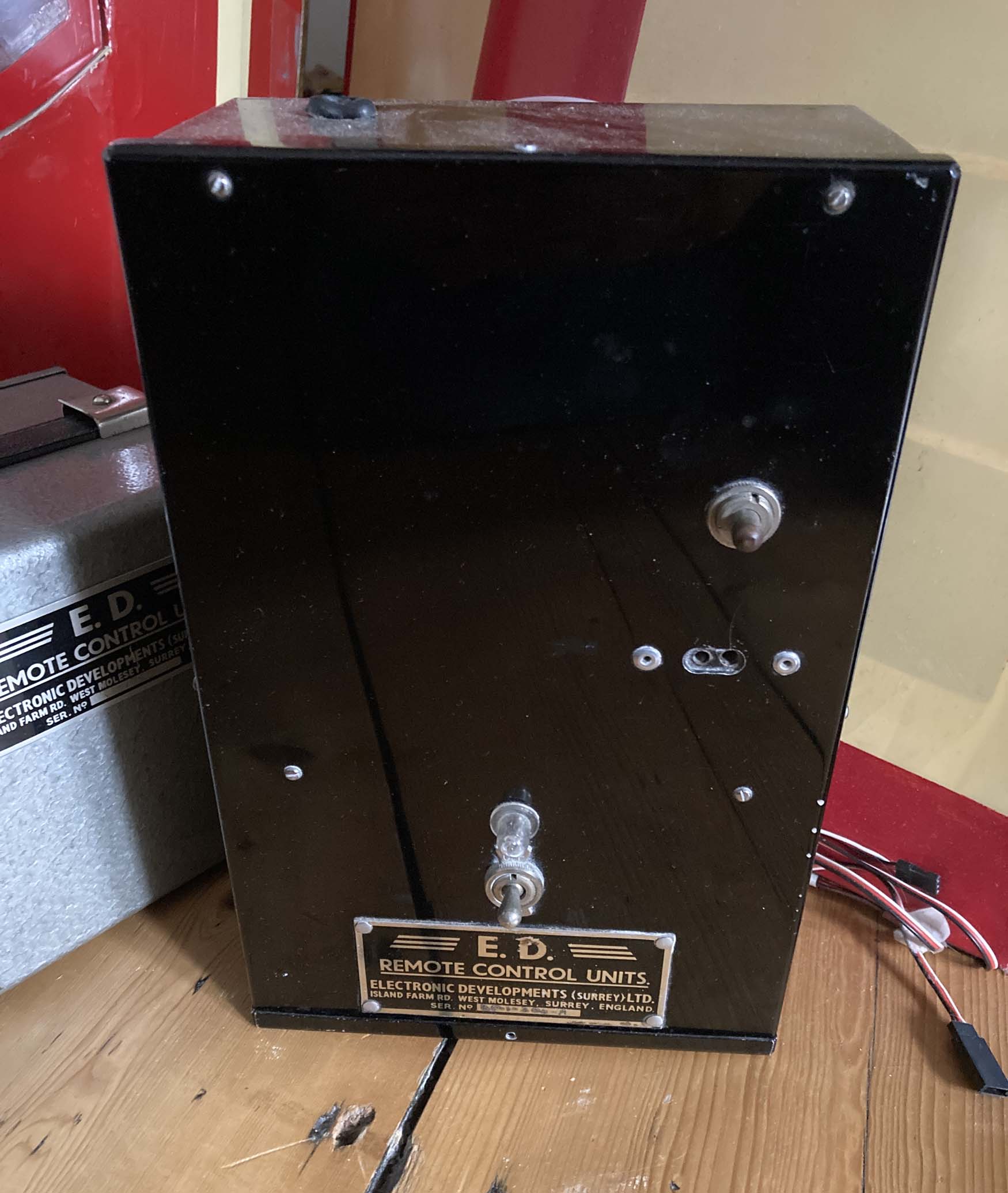

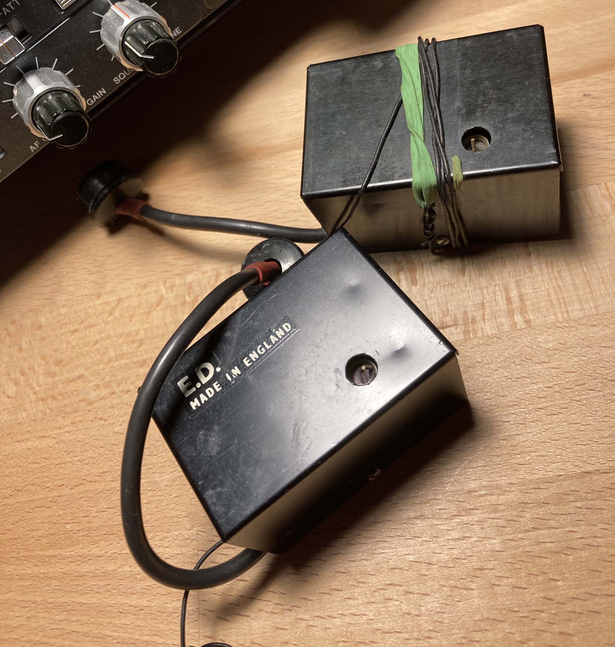

Progress to owning ED? .... well I had a massive stroke of luck and very grateful I am to to be the recipient of what could be a Black Knight Tx ? And two receivers all in stonking condition
Maybe Black Knight for Black Magic ?

Great stuff you getting some ED, somewhere I've got the review and circuit diagrams for the ED RCI, but I found the RCM&E review of the Black Knight. And you only need the 130V for the earlier MK1, 2, 3, 4 and Everest floor standing Tx, you don't need such a high voltage for the PCI!
