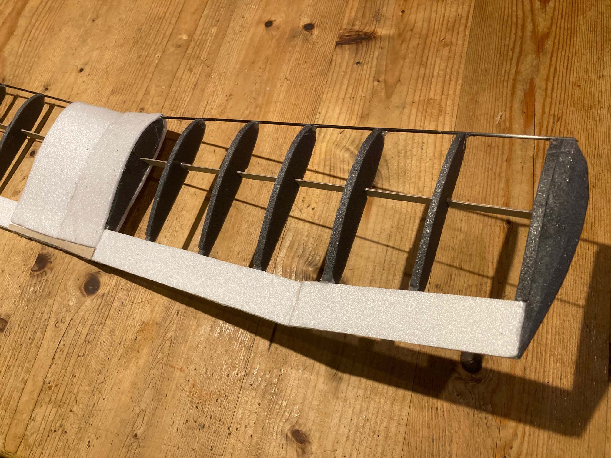

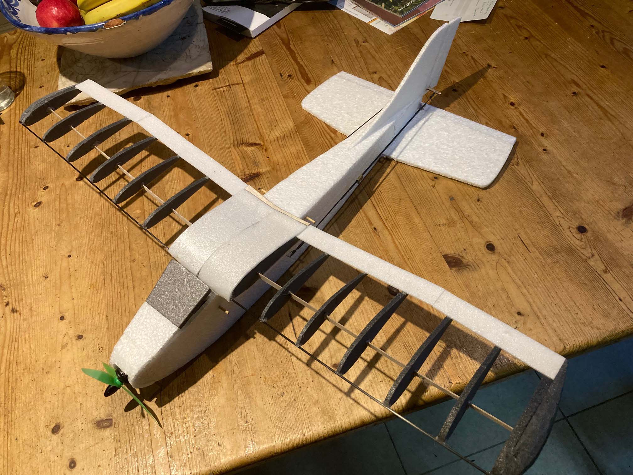

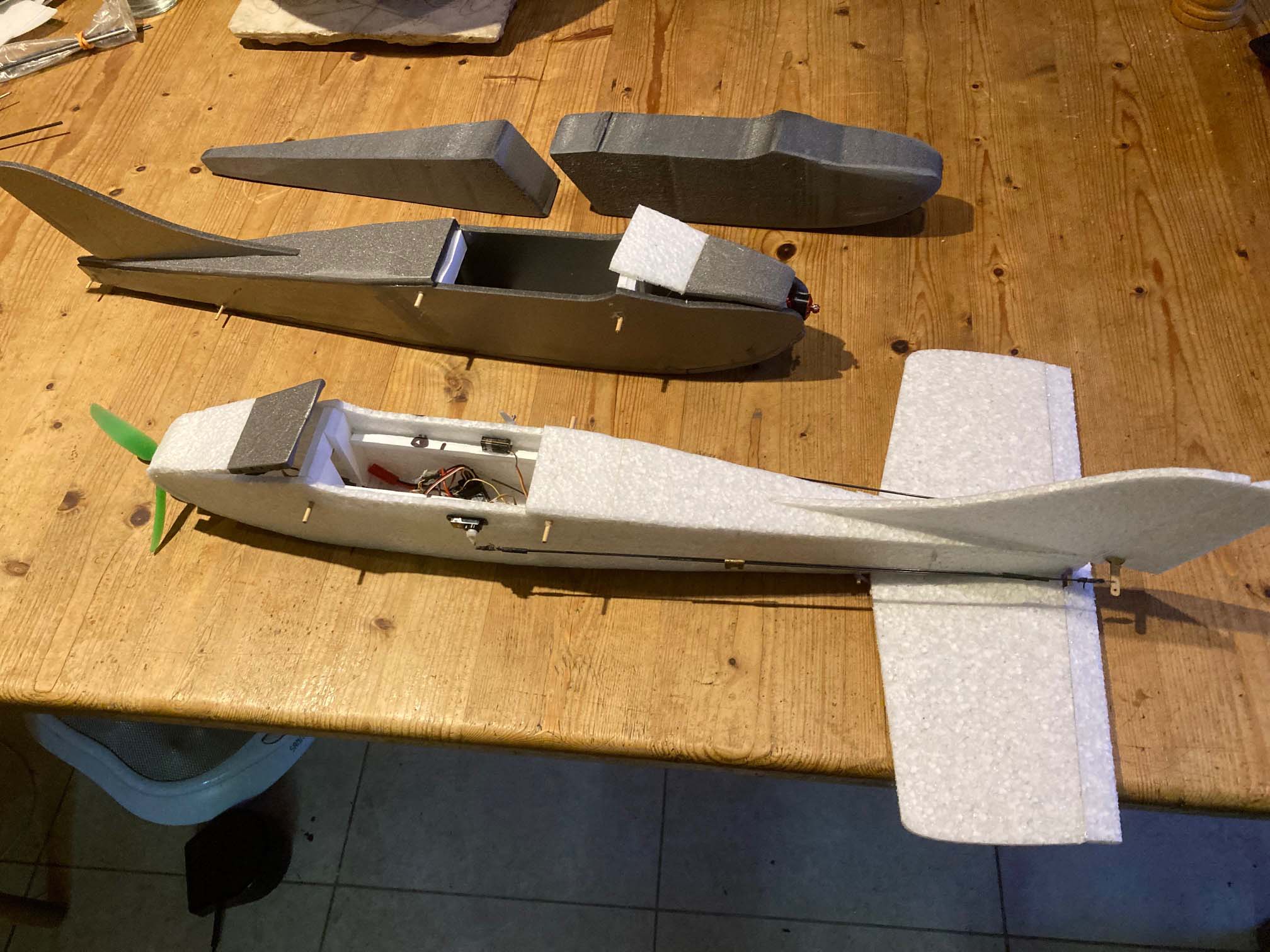

I have been building variations of Mini Robot - 28" and sadly not in balsa (no build space except kitchen table and asthmatic son)
Tried EPP version - white - (which was finished pre-Ponty as had hoped to come) / 6mm depron - grey / black foam (that used to be blue)

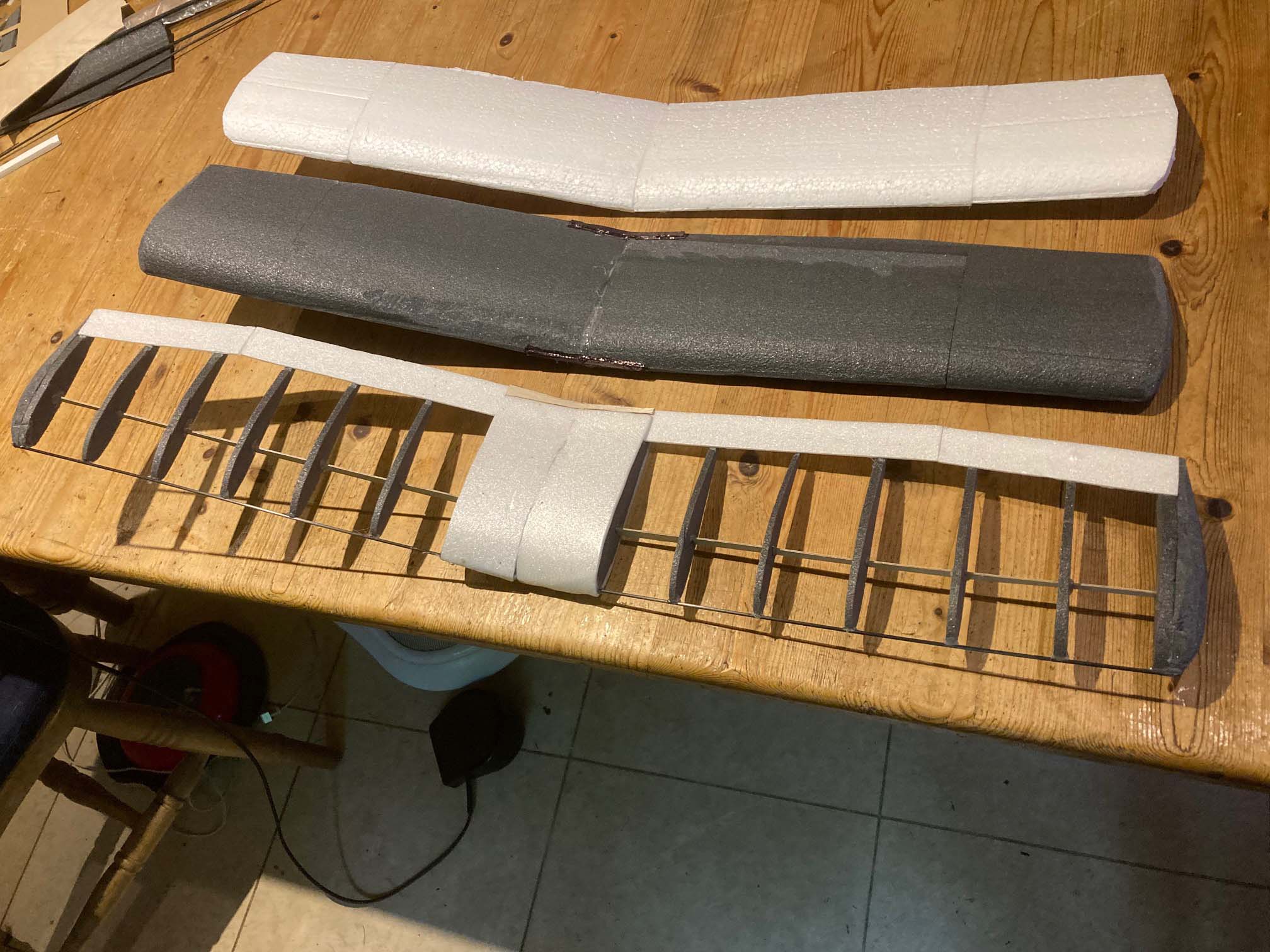

Built up wing is 1/64 ply main spar and will be covered in doculam (clear) Might do black foam wing in red solarfilm as have end of a roll
All needs a bit of tidying up
RC is a jumper lite with s/c compound emulator EPP version has elevator / 6mm depron is rudder only
Also going to build a 2mm depron version with WL toys module - to fly rudder only - hoping it will be light enough

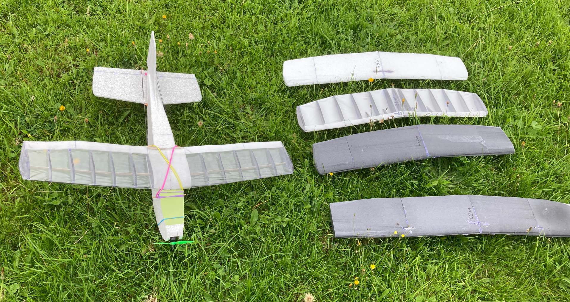

In order to be a Tobe raffle hopeful this the Mini Robot flight from today (= within a month after Ponty)
The four wings on the right are experiments
Foam - 19 gms - short ply spar
2mm depron over 6mm ribs - small area of LE underside is double surface - 38 gms
Blue (black foam) - 48 gms
Blue (black) foam extended wing - 62 gms - have yet to try this one
Foam on the M Robot was 49 gms - ply spar - double surface TE
The three wings I have tried all pretty much the same - a calmer day would help
Had to fly from the top of the slope as so turbulent behind trees at the bottom
I used Pascal Langer's S/C emulator and in the spirit of the event no elevator and fixed throttle setting (too much)
Fairly tricky as you can see - mixture of turbulence, too much throttle and poor piloting...
Will try again from a flat field and throttle on a switch
I remember the original with s/c and a DC Spitfire 1cc as being much more sedate

Nick, I'd definitely consider that a success - well done
