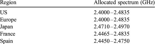

Lack of knowledge is not a valid defense or excuse so here I have included a chart showing how 2,4 GHz is allocate around the world.

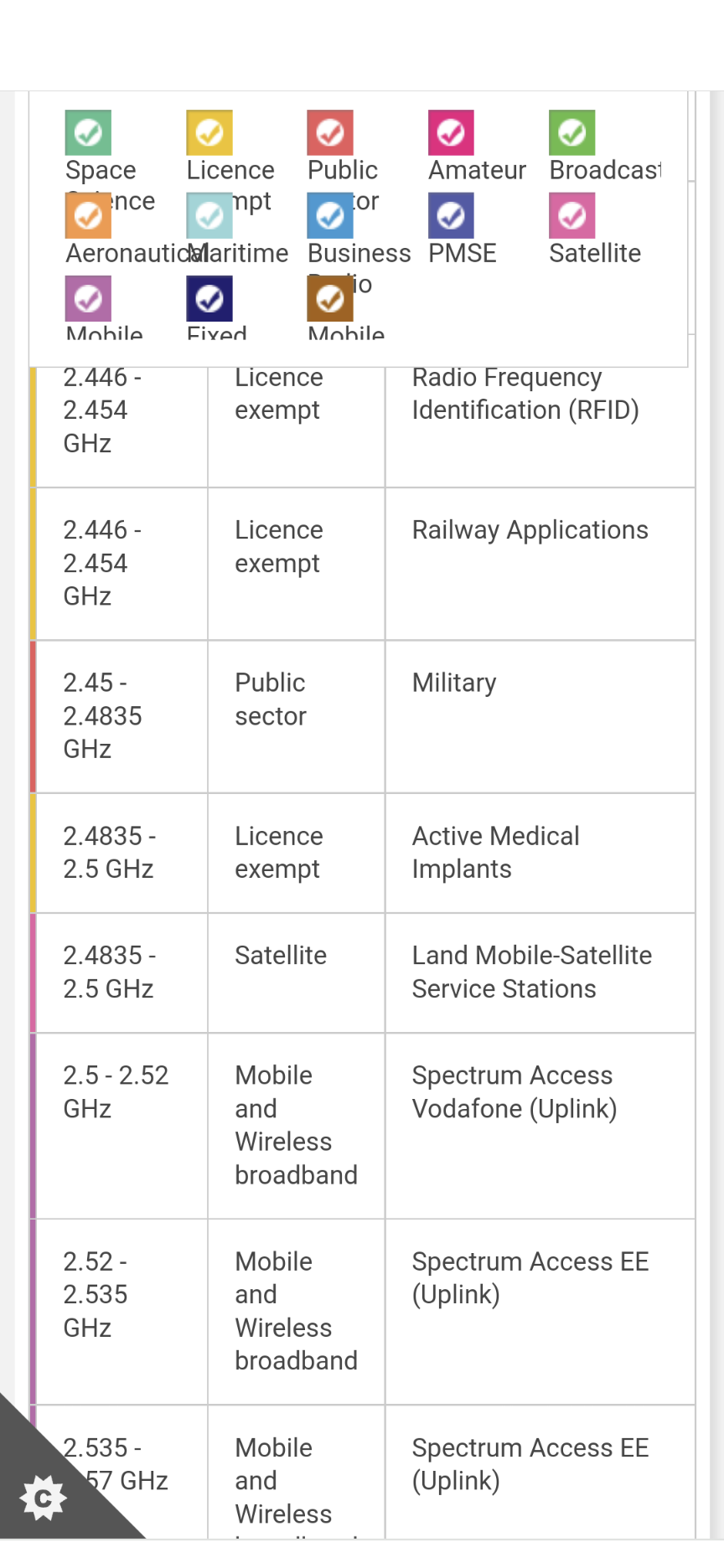

I wondered who the 2.4835 - 2.5 GHz has been allocated to and its primary users are active medical implants and land/satellite base stations. Even if Ofcom don't check up on us, we'd better make sure nobody is nearby with a medical device like a insulin pump or insulin monitor for diabetics (unfortunately this includes my daughter) or monitored heart pace-makers (a few as my club) if using a transmitter out of band.
If you want to see who frequencies are allocated to, Ofcom has a nice website checker:
http://static.ofcom.org.uk/static/spectrum/map.html#

I love Ofcom's chart but they are by sure not intended for color blind people!
Concerning medical implants communication fortunately every message/ packets of data has at the end a check code so unintended signals are just disregarded. Actually every packet of data is sent so many time per period so at least one will reach destination w/o interference...but no doubt we should avoid to interfere.
Today in medical devices we have started to consider "radio signal pollution" and I'm sure you could guess why!
Certification of medical implants software defined with some kind of remote functions could cost in the range of several 100 millions $...

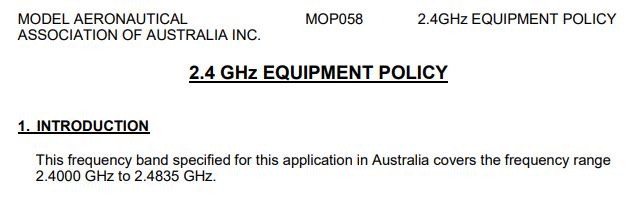

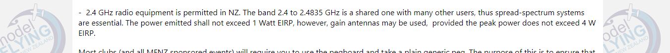

Re: NRF24 project - a word of warning!
For those of us in Australia, our 2.4GHZ band is:
& in New Zealand:
