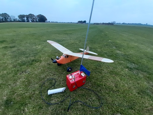

With the perfect still and grey skies of yesterday, I simply couldn't resist test flying my latest conversion...... A Tri-ang ground based transmitter.

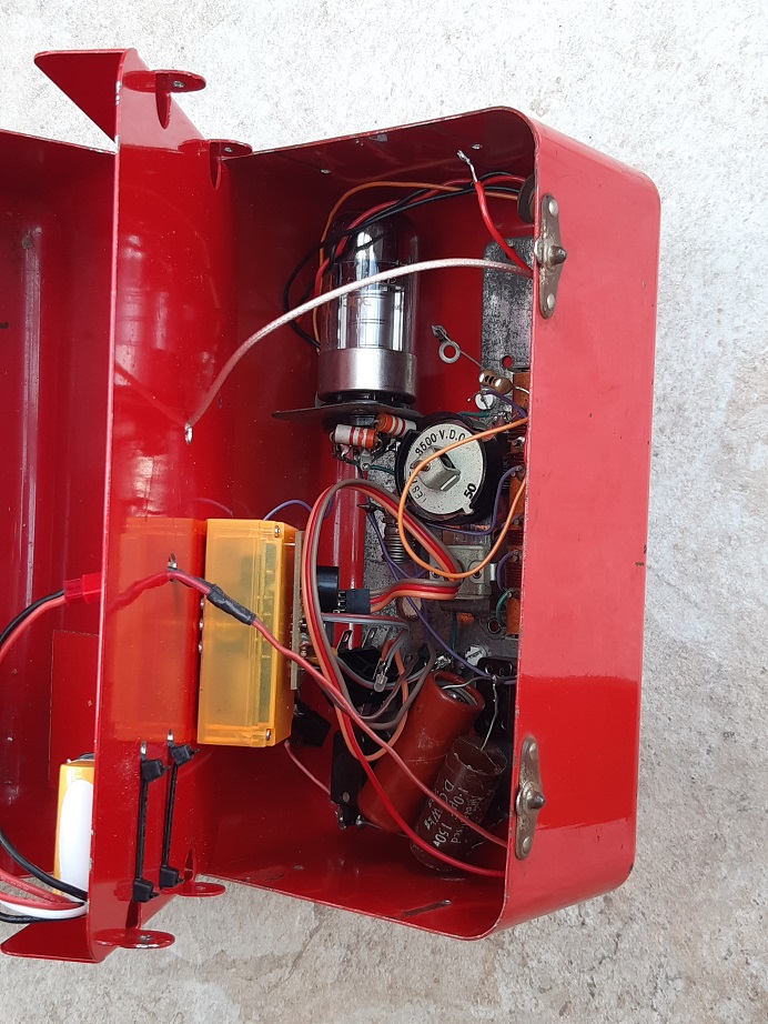

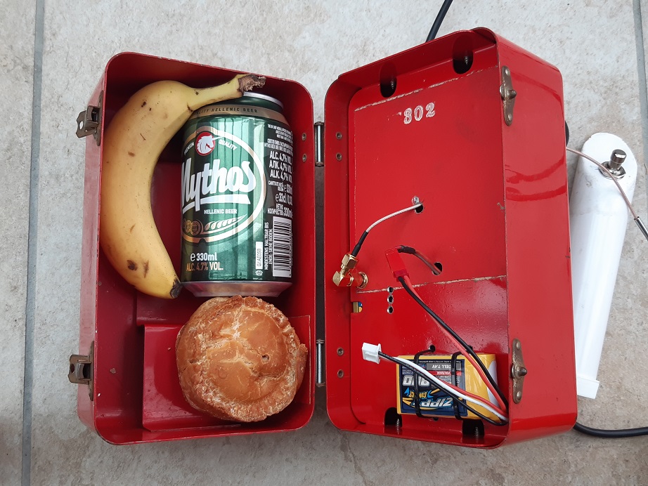

The tranny is "50s" and model is my venerable Hep Cat from the early 40s. The conversion uses an Orange JR compatible plug in Tx module and Phil's standard single channel encoder though there is so much room in the box that (for posterity) I have left all the original electronics in there and there is still room for my lunch!
Presumably because of it's proximity to the ground, ground-range is potentially an issue at only around 250yds but because of the fact that the model is very stable and flies very slowly and the conditions were perfect with absolutely no wind, I decided to risk it and had two flights with no problems, both times landing on it's wheels back on the strip........ So one way and another, you can't get much more "retro" than that and it was a very enjoyable outing, :P

The perfect lunchbox, if you keep it on the valve will keep the pie warm, a dual function Tx well done Paul

250 Yards ground range ? That's at least three times what I used to get from a Terrytone Tx. The air range often seemed to drop to zero as soon as model left the hand !
Just revel in the nostalgia of 'Guided Free-Flight'. Success is landing in the same field a takeoff. You can scoff the pie until it circles round again. :D
