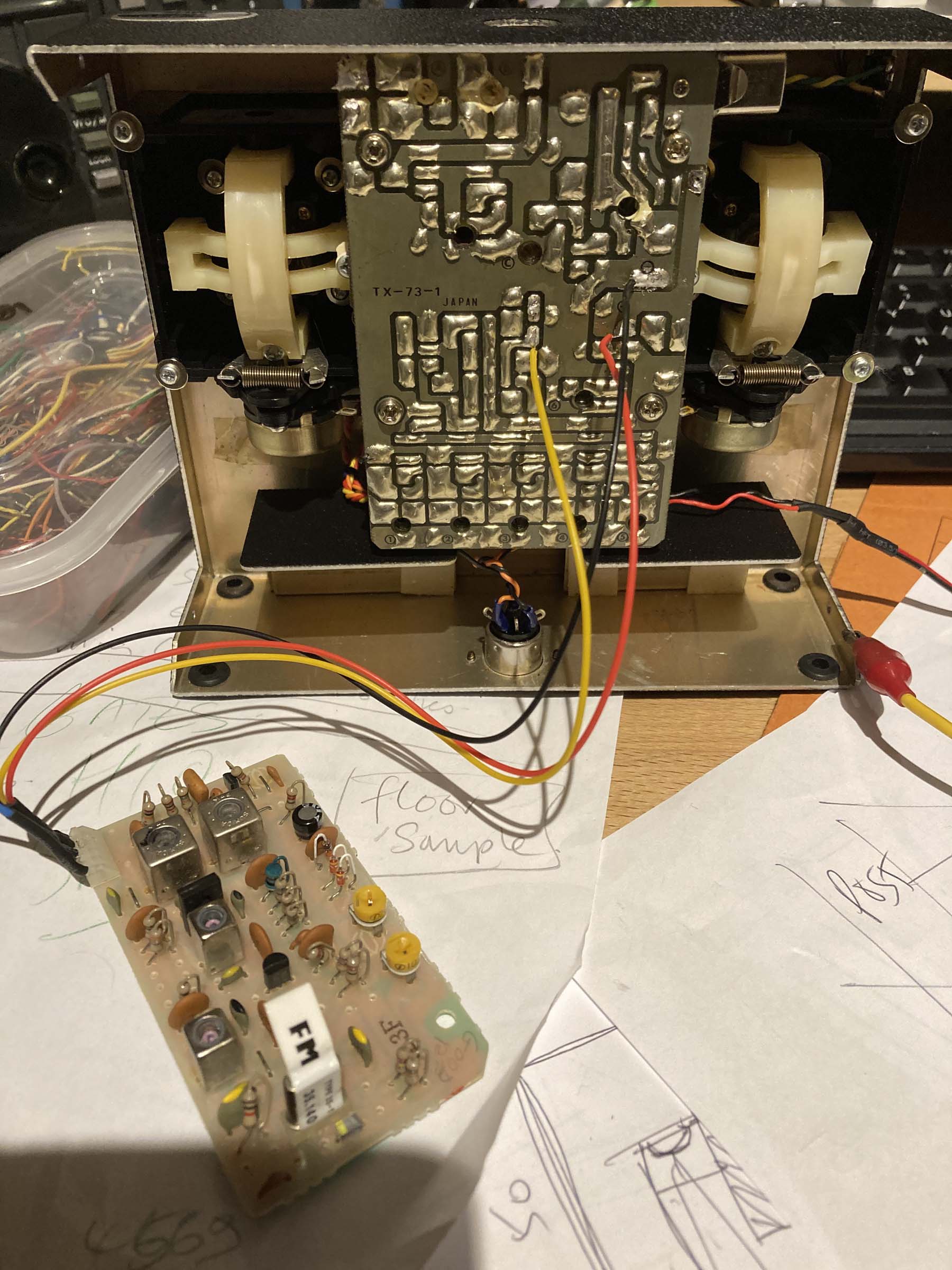

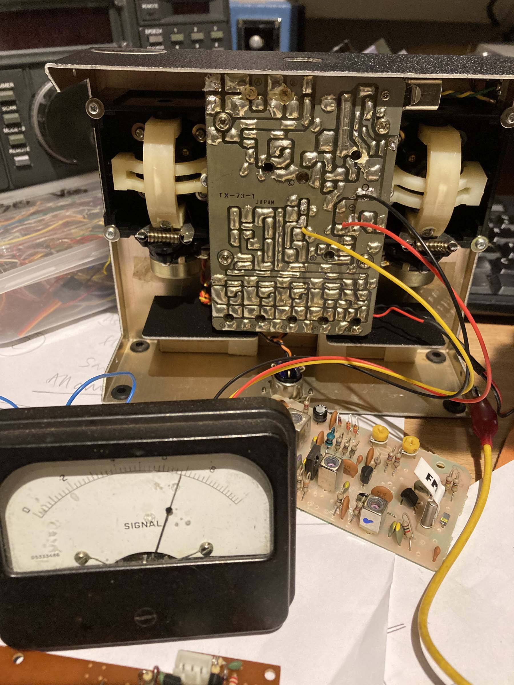

I’m a bit stumped here chaps. Smashing MRC transmitter to convert to 35 MHz FM. Using an old Futaba Challenger RF stage with a stonking output. Likewise a stonking PPM signal too.
The receiver is clearly picking up the carrier but the servos are not moving. Any suggestions would be gratefully received. Tired now and off to bed

False alarm - brainwave - ppm signal must have been off the wrong side of a diode I’m guessing - it’s a lesser signal according to the amp BUT the servos have sprung into life . Success :P

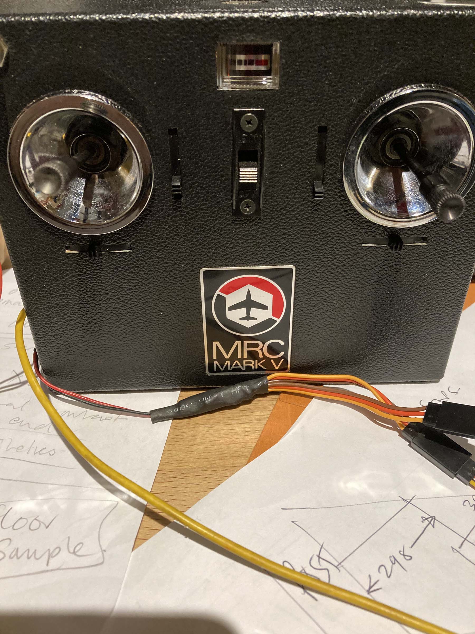

that MRC Tx looks to be in top nick
