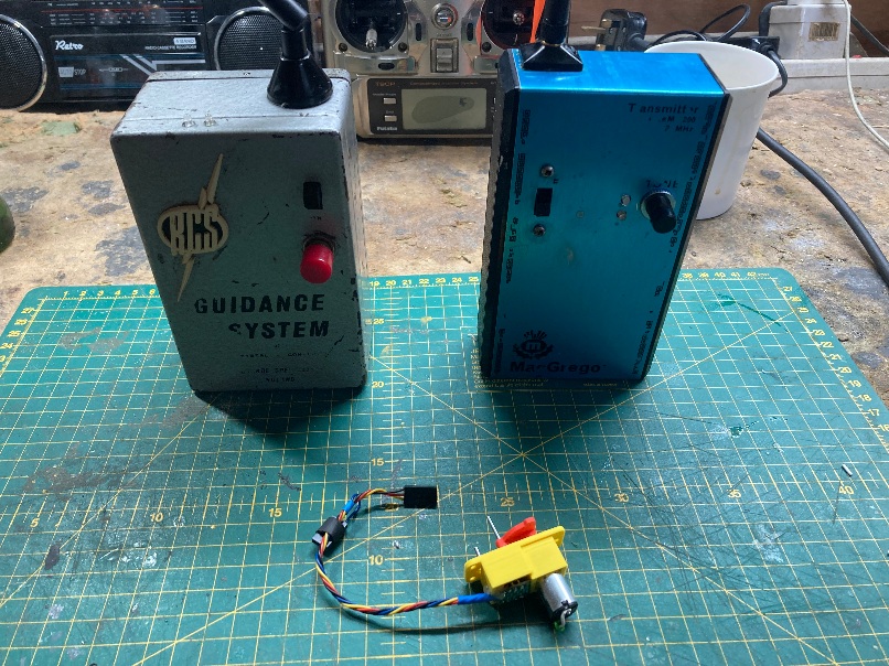

I’ve got the bug now so converted 2 tx
RCS and macgregor mr tx

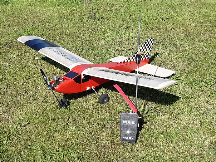

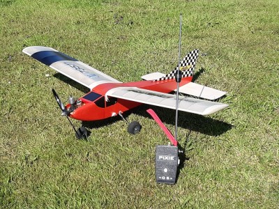

Hi Darren,
Yes, I built both a Mini-Robot and a 3D printed OS Pixie just last year. The Pixie uses Phil's "emulator" and a Lemon transmitter module and there is a Lemon receiver in the model. The whole combo has performed faultlessly from the start though the model is perhaps a bit underpowered with a Mills.75. It can just about do a roll but hasn't enough oomph to do a loop. It's a lovely model and I really enjoy flying it, I have a DC Merlin ready to go in it but haven't done it yet

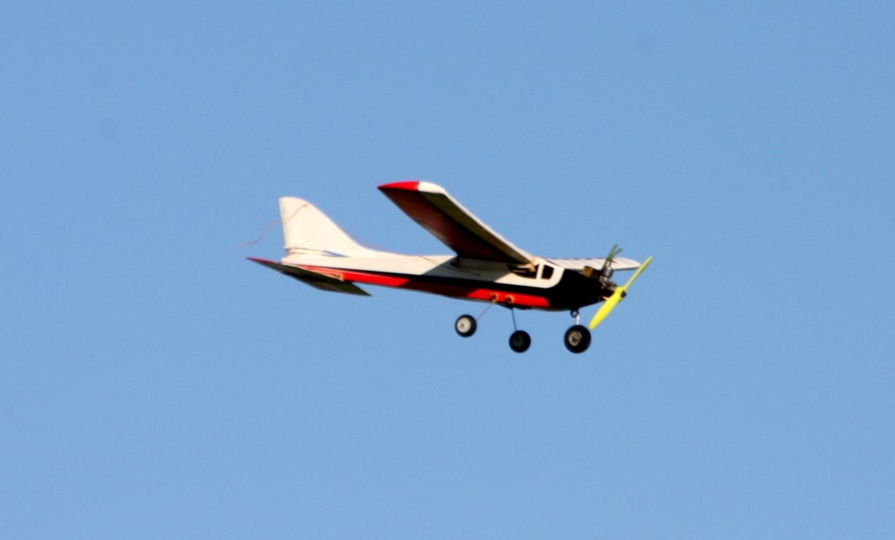

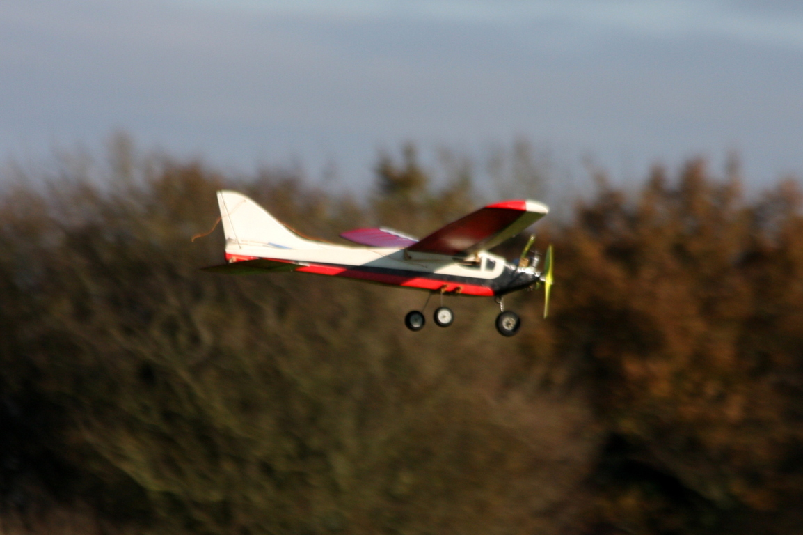

I built mine back in 2015, to celebrate the 50th anniversary of my first successful RC flight. I thought I'd posted the video on here somewhere, but can't find it any longer, so perhaps it was on the "old" forum...
Originally I flew it with a rubber driven Elmic escapement, but the output shaft was very worn and sloppy. Also, the length of the rubber band was a bit marginal! I've now replaced the Cox "Golden Bee" with another Cox .049 (also with the big tank) that gives a more reliable engine run. I've also replaced the escapement with a mini-servo using one of Phil's excellent S/C to servo adapters, so that I can still use the single channel transmitter and receiver.
It is a regular at Ponty, but is a "light winds only" model!
When I built this one, I used spruce spars for the wing, as the original balsa ones were notoriously weak!
