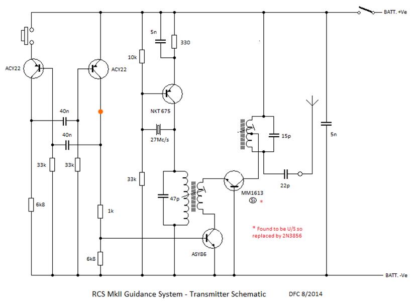

I'm thinking ACY22 transistor off the tone button bust?
(Diagram courtesy of NORCIM website)

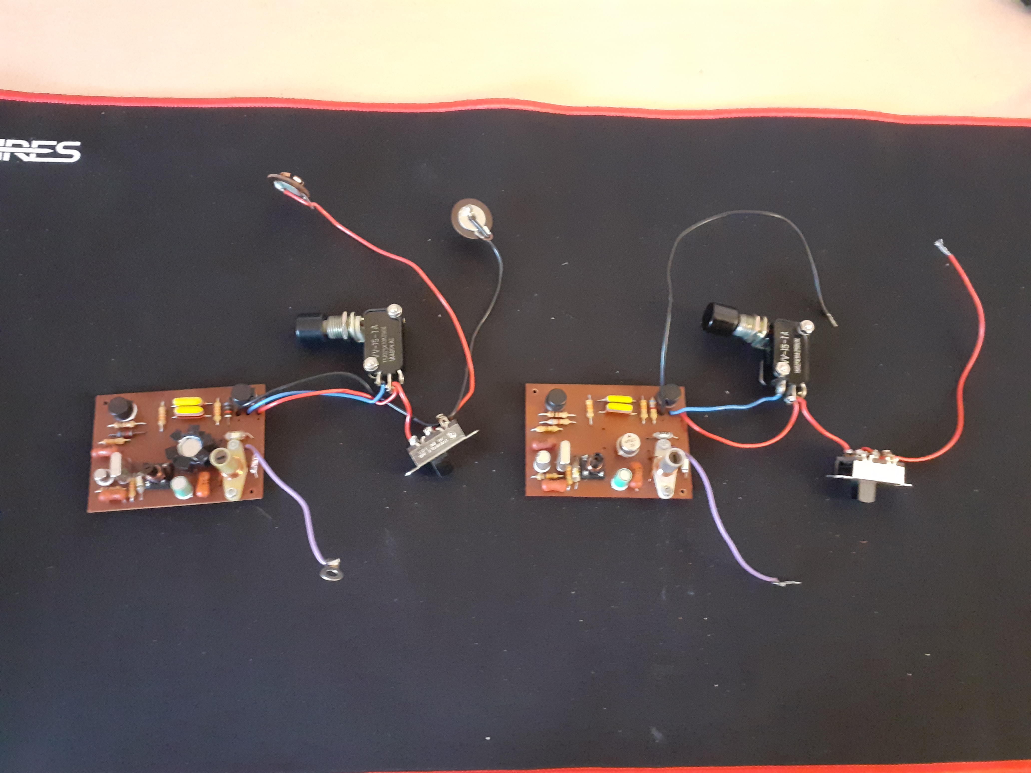

Here's the little fellas side by side for testing.

Push button removed and replaced with another push button. Still no joy.
I'm still thinking the transistor near the switch on the schematic but I'm not 100% certain of its job.

The two transistors on the left of the circuit diagram are a multivibrator that generates a tone when the button is pressed. The one immediately to the right of them is the crystal oscillator that generates a low level RF signal (27 MHz). The one on the extreme right is the power amplifier that boosts the signal up to the required level for transmission. The transistor at the very bottom modulates the output by switching the power amplifier on and off and is driven by the tone generator.
The problem is that without even basic test gear (VHF radio?), you can't tell if its actually radiating any RF signal. That could be down to the oscillator (dead transistor or duff crystal), the power amp (dead transistor) or the modulator (ditto). If it IS producing RF, but still not working, it will probably be the multivibrator.
If the relay clicks momentarily when the Tx is switched on, then it is probably producing RF, which leads back to the multivibrator or modulator. Again, without an oscilloscope, it could be quite tricky to determine which it is.
If you can find an old fashioned crystal earpiece (as used for crystal sets, beloved of children of yesteryear), you could try connecting it between the red dot on the diagram and ground. You should hear a tone when the button is pressed. It needs to be a crystal (high impedance) earpiece, not a modern (low impedance) earphone. The latter will load the circuit too much and stop it working anyway!
If you have an analogue voltmeter, you could try connecting it between the red dot and ground. With the button not pressed, it should read a high voltage. When the button is pressed, it should drop to about half that voltage. That would indicate that the multivibrator is doing its thing, but it might not be the right frequency, mark/space ratio, or a multitude of other things, but at least it would indicate that it is working. It may not be working properly though. To test the rest, you need at least some kind of radio capable of tuning to 27 MHz - or one of its harmonics - or a field strength meter.
Without any of this, you are searching for a black cat in an unlit cellar!

Thanks Peter, I really appreciate that, it will give me something to go on. I am actually enjoying the process as I'm learning as I go, albeit on a very basic level...
