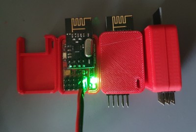

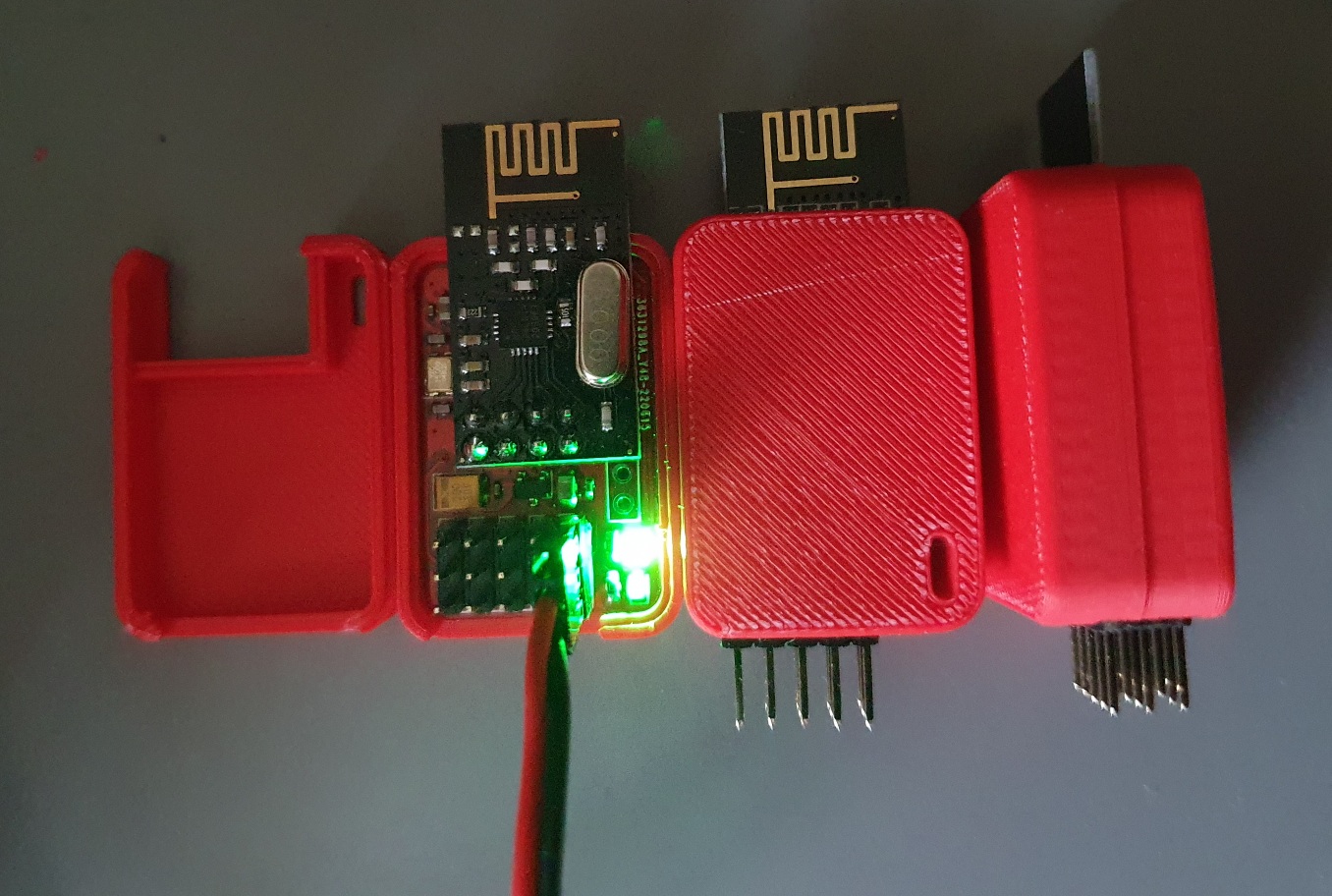

The Rx is intended for to run on 4x1,2V NiMh or from a 5V BEC
The Rx shown here is a 4 channels with the included 3D printed case.
Size:
23 mm x 50* mm x 14 mm - horizontal pins
23 mm x 43* mm x 14 mm - vertical pins
Weight 10 gr.
* 10 mm is the extension of the PCB antenna

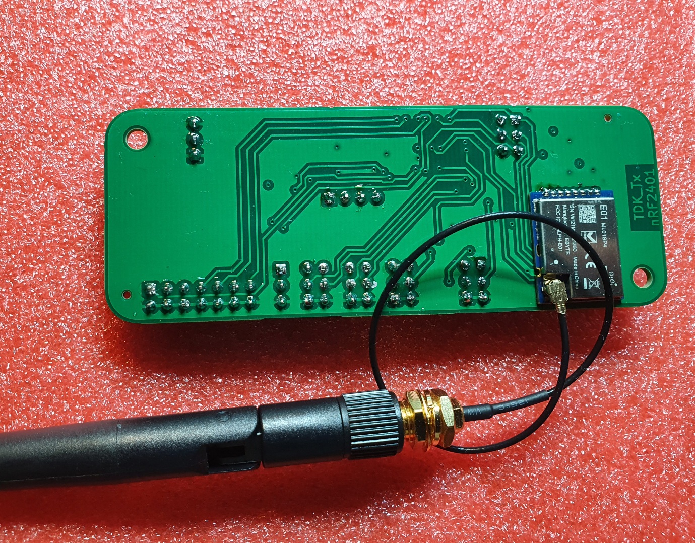

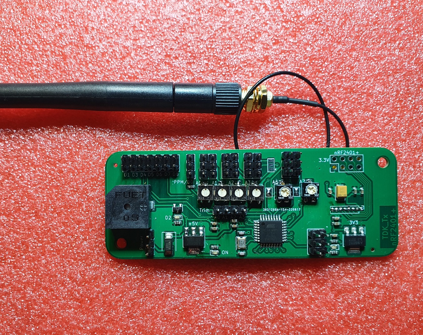

Here my latest encoder board and basically it follows the earlier ones...
What you see is a 6 channels encoder with the nRF24 module that matches with my 4 or 6 channels Rx
There are however some minor differences which are most noticeable if it is turned around....What you see is a 6 channels encoder with the nRF24 module that matches with my 4 or 6 channels Rx

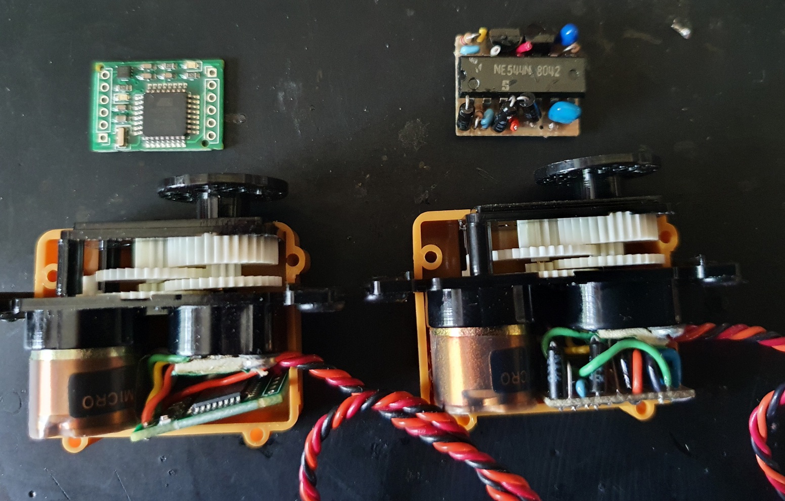

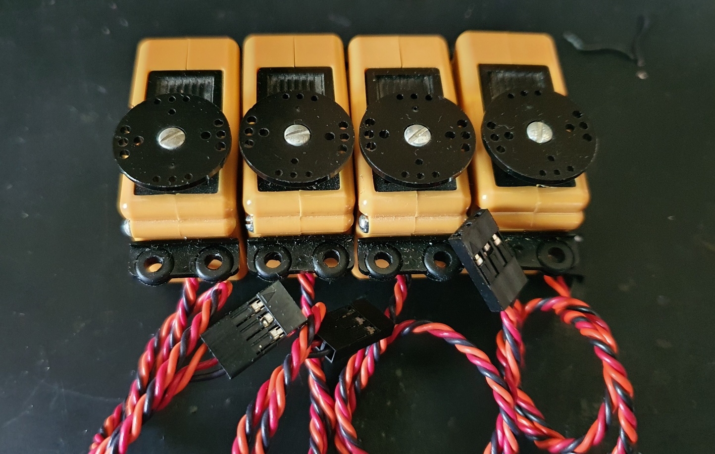

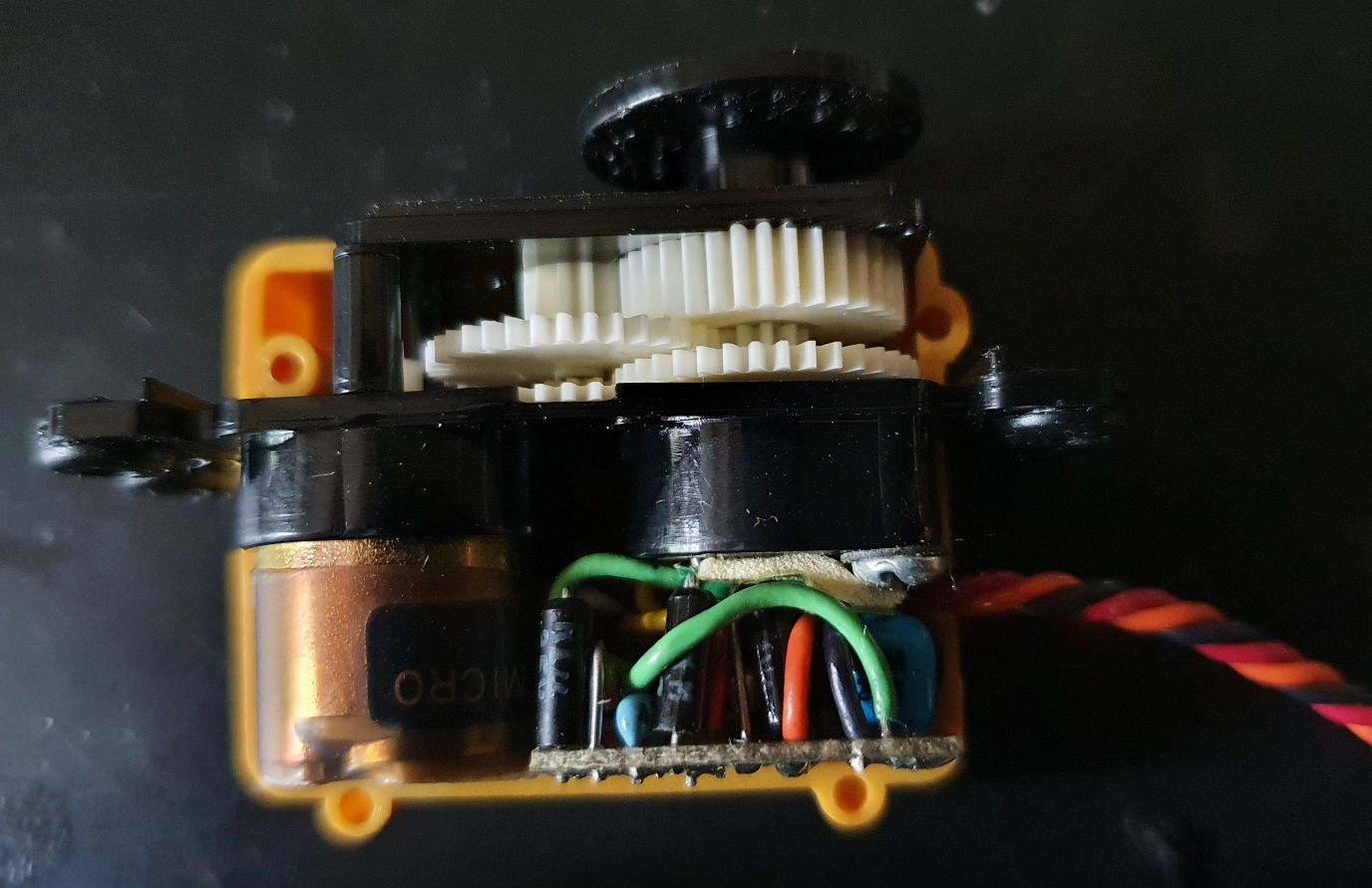

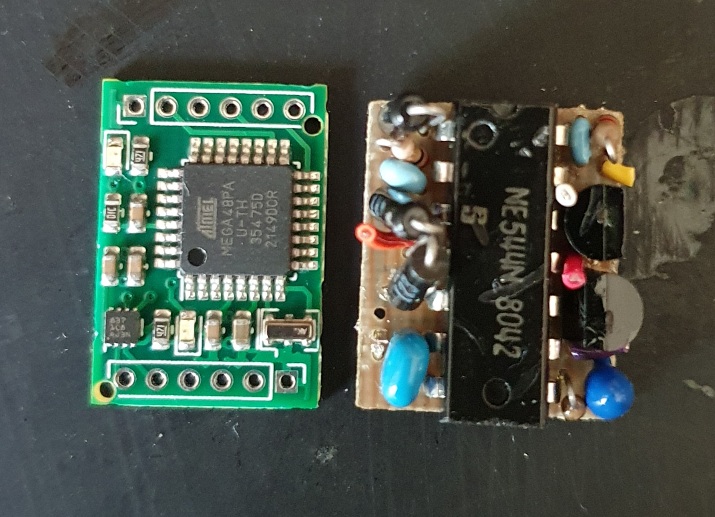

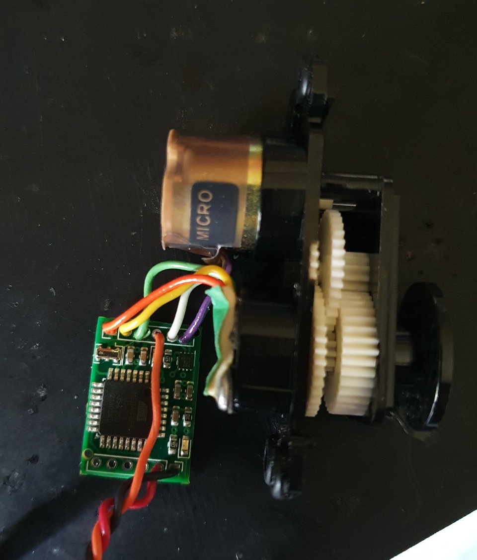

....and here is the "new" servo amp shown together
with an old board taken from an old Kraft servo.
The board uses an Atmega48PA with a DRV8837 and given life from a sketch by Mike. The board has 2 LEDs one on D13 for programming purposes and one that lights up at 1000uS - 1500uS - 2000uS

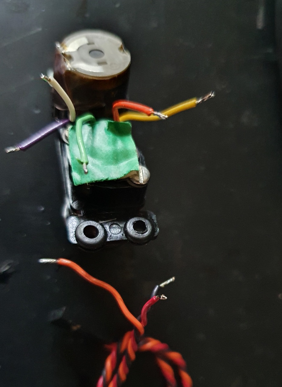

In the follow photos I will try to show the process to retrofit an old servo, I'm using the original internal wires as the lead to the Rx by just crimping on a new connector. ...and if it is not on YouTube....

Re: From Tobe's skunkworkshop
Most impressive Tobe, very sweet indeed.
Have you noticed any change (improvement?) in the speed of the older servos when fitted with your new amps? I have Bantams, Bantam Midgets, etc., etc. hence my interest. You realise Tobe that I'm going to have to live at least another 50 years just to use all the great stuff you've been turning out
- Posts: 712
Theoretically there should be a slight speed increase but if it would be noticeable...I sure second you on 50 more years! i need to go back to be a regular modeler and start being at the flying field more often so my pals would still recognize me!

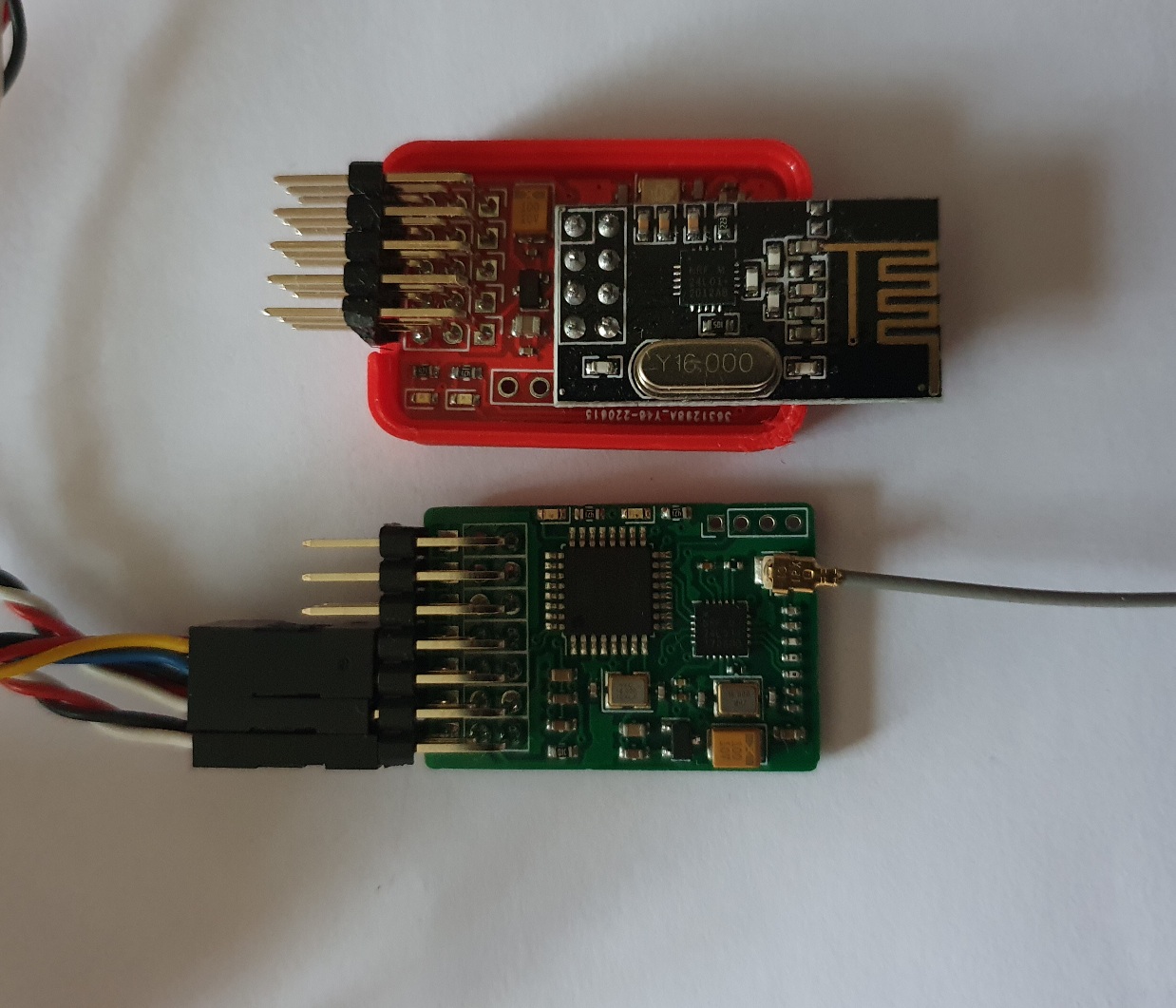

Here it's, a single pcb NRF24L01 receiver
Size wise it's 31 mm x 21 mm and weighs in at 8 gr.with antenna whisker and pin headers.
Compared with my earlier Rx it has gained 1 mm both in length as width.
The Rx is a 6 channels based on a ATmega88P.Size wise it's 31 mm x 21 mm and weighs in at 8 gr.with antenna whisker and pin headers.
