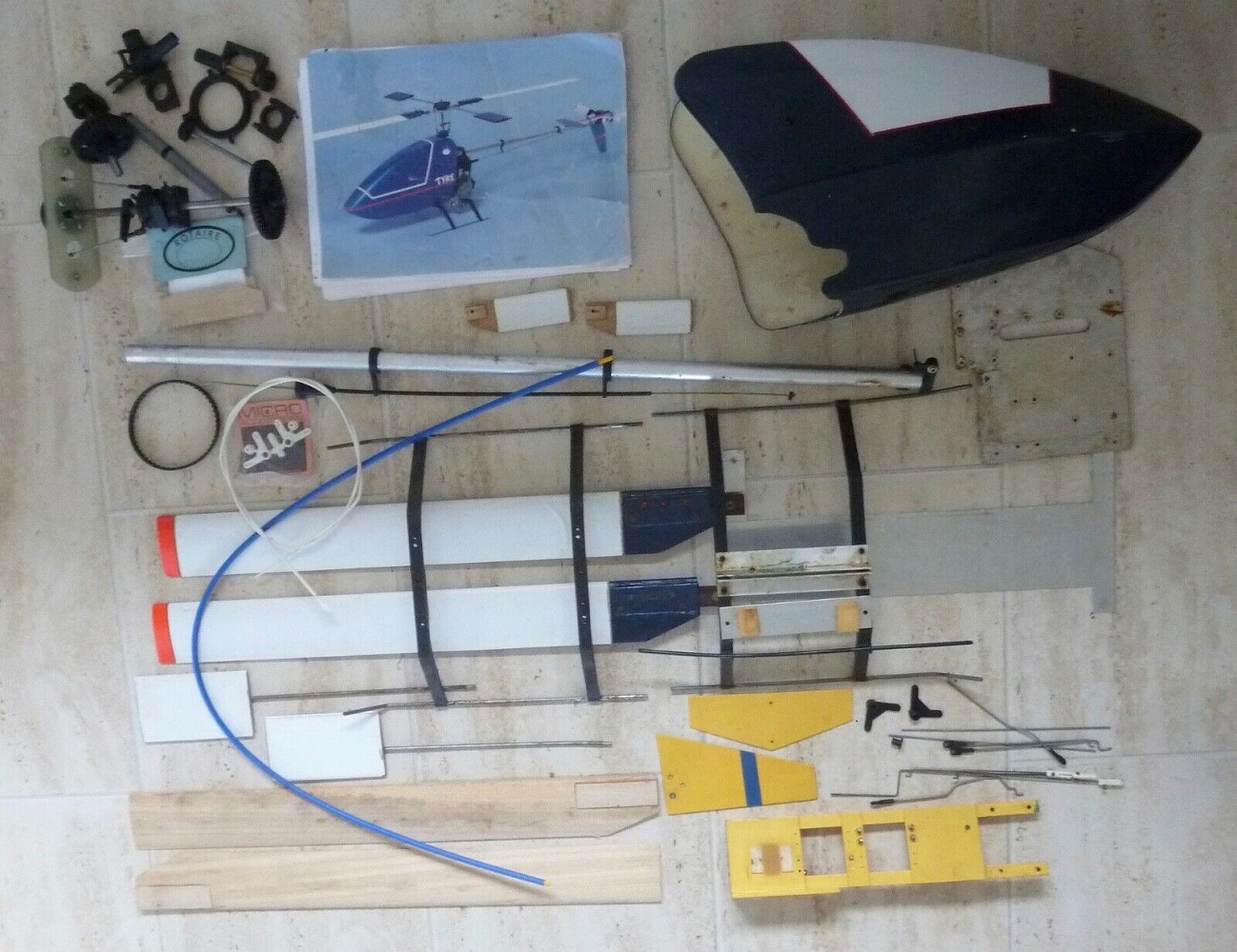

I've just about finished restoring an obscure English fixed pitch heli designed by a Tim Angel.
From the late 1980's - it was quite a few years behind the times but very cheap.
