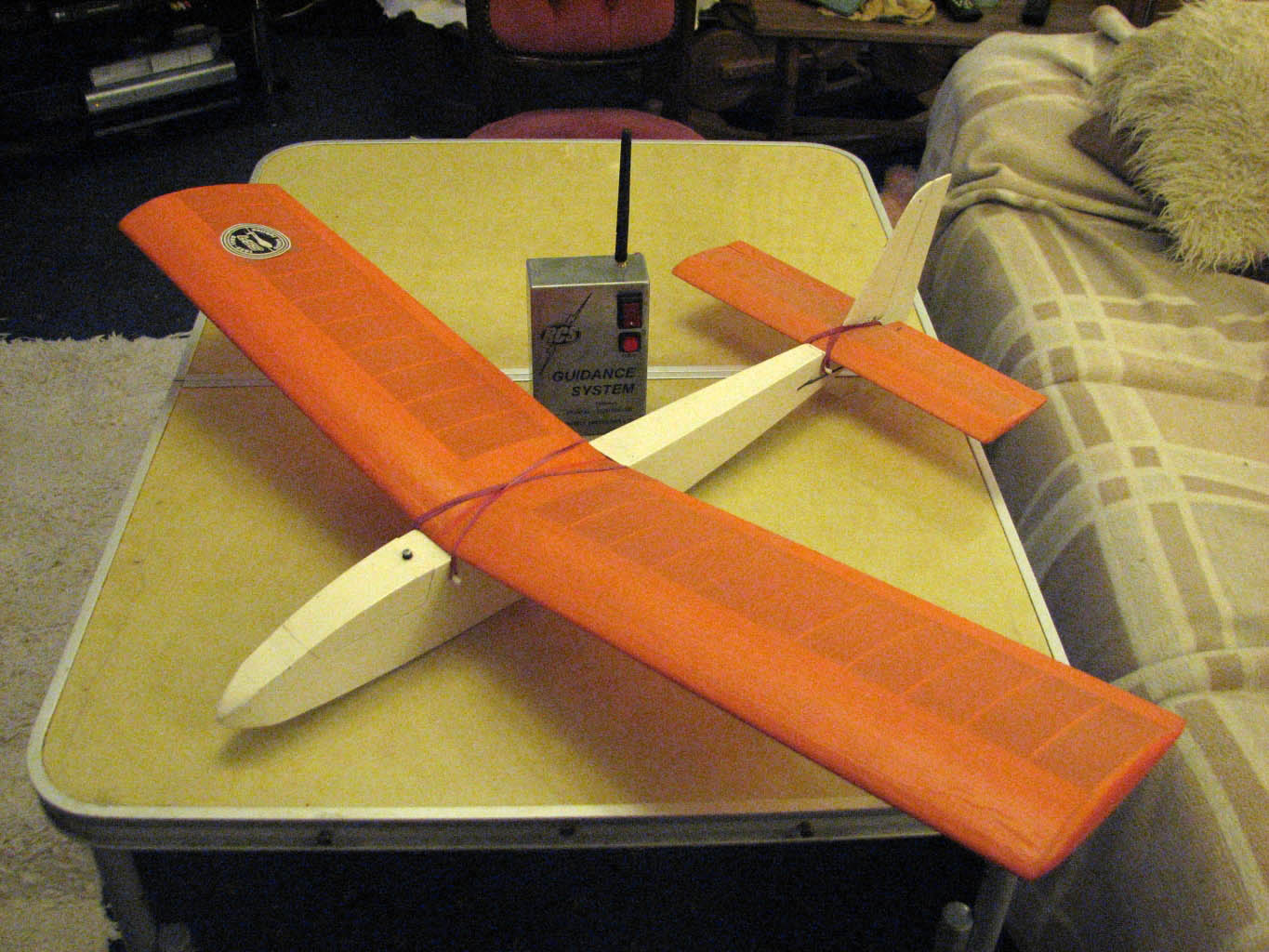

Re: 70% Impala build.
Postby Phil_G » Tue Mar 15, 2016 8:20 pm
Very interesting Al !
When I built mine donkeys years ago I drew it directly onto the building board so I never had a plan.
Couldnt photo-reduce, these facilities weren't available back then.
Lots of people have asked about it over the years but I've always had to say "sorry, there is no plan" !
I've often said, I've a few Impalas and I honesty prefer the smaller one. Its handier, its more agile, its just nicer than the 52" original.
A 'Mini-Impala' would have made a brilliant addition to the Veron range, absolutely perfect S/C slope soarer.
They missed an opportunity there, I reckon a Mini Impala would have been far more popular than the Big Impala they did release.
Postby _AL_ » Thu Mar 17, 2016 12:07 pm
Your Impala was one of the reasons I'm building this one. Thanks to Ron I may now also have to build a Little V.....
Going through old magazines you can tell when scanning became an option as all of the reduced plans stopped appearing in the magazines or were partially covered with a logo or similar. Mid to late 80s by my collection. It's probably good they had the mini plans in the old magazines though or most of them would be lost now.
The funny thing is, in my youth I absolutely hated building. It was just something that got in the way of flying. These days I enjoy building more than flying though most of my builds are fiberglass & foam rather than balsa.
Slow progress but progress none the less. I should have the fuselage halves joined tomorrow. The rib templates are cut but I need to buy some long screws to sandwich the ribs for sanding to shape.
Al

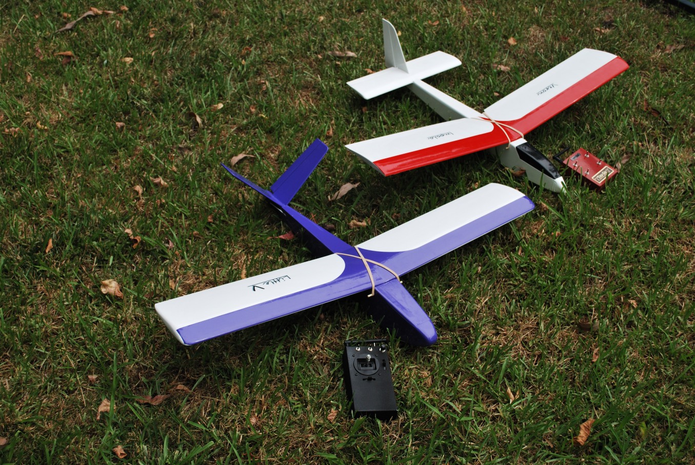

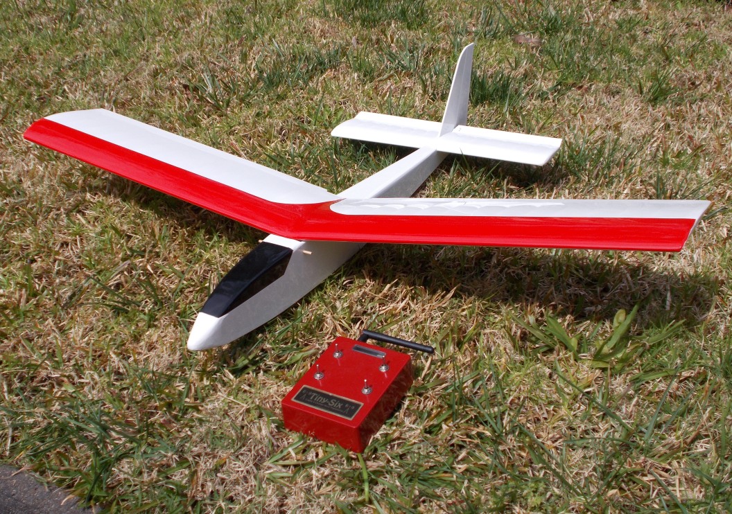

Just reposting the missing pics.
Impala is red/ white & Little V is Purple/ white.
Al

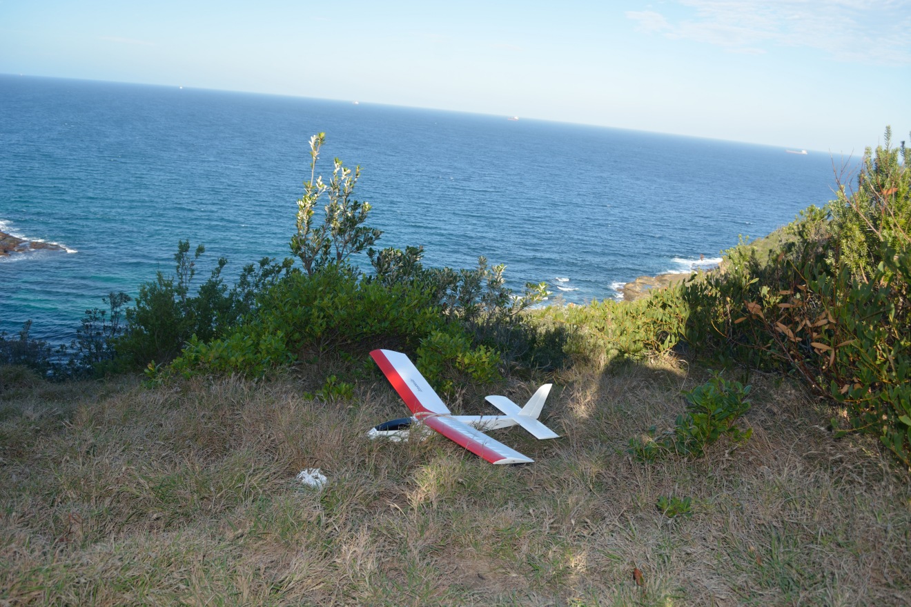

Impala on reeds at Turimetta beach on a nice sunny day.
If only every day was this good.
https://vimeo.com/198318460

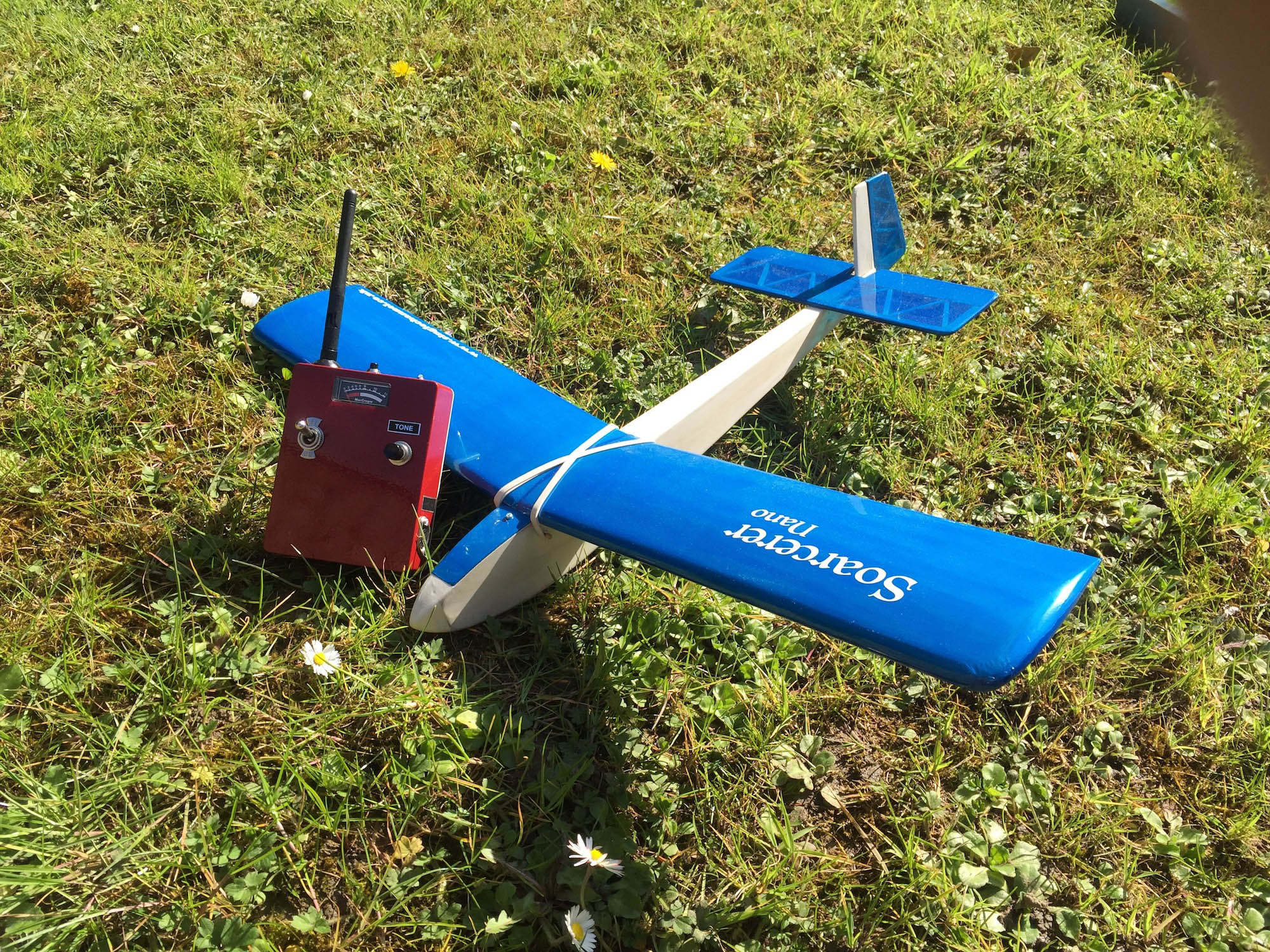

Had to include this little beauty here too
50% soarcerer.

That's really nice Ron. I'll build one myself one day.

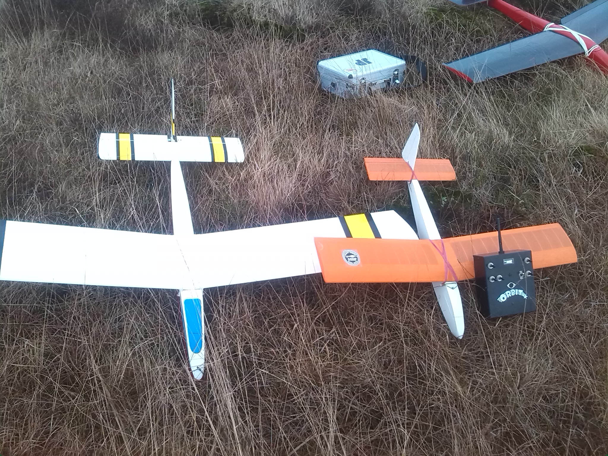

A short vid of me flying the impala today. The launch was ugly as I've moved it over to the GEM reeds & it was a bit out of trim.
https://vimeo.com/258384744
A pic before leaving.

Carl.
I'll have a look for a landing vid & get back to you.
Pretty much all of my costal spots are covered in shrubs with rocks at the base so no nice grassy LZ. At best it's a sandy beach landing at some.
All I do is wash off energy with tight turns or fancy stuff, then run long & low down the slope away from the LZ.
Then run back to the LZ either low down & in less lift, or back behind the slope. Then just pop & drop in to the landing point for a slow controlled crash. Most spots have a small grass area but generally it's more of a case of a gentle drop into a shrub.
