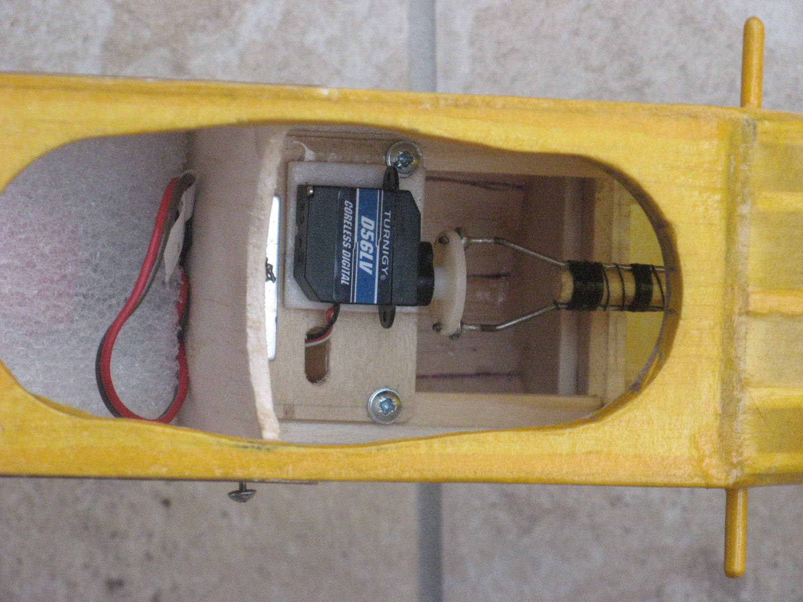

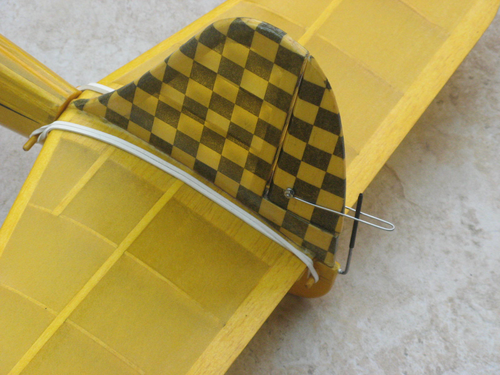

I have flown various rubber driven escapements sequential and compound and for me they all have one thing in common...... They are unreliable so that when it all goes pear shaped I was never sure whether it was due to , the escapement, interference or my mistake. Nowadays, for single channel I have "standardised" on Phil's emulator and a servo which, in either sequential or compound mode, behaves exactly like an escapement. You can rig it with a torque rod so it "looks right" but it is totally reliable!
