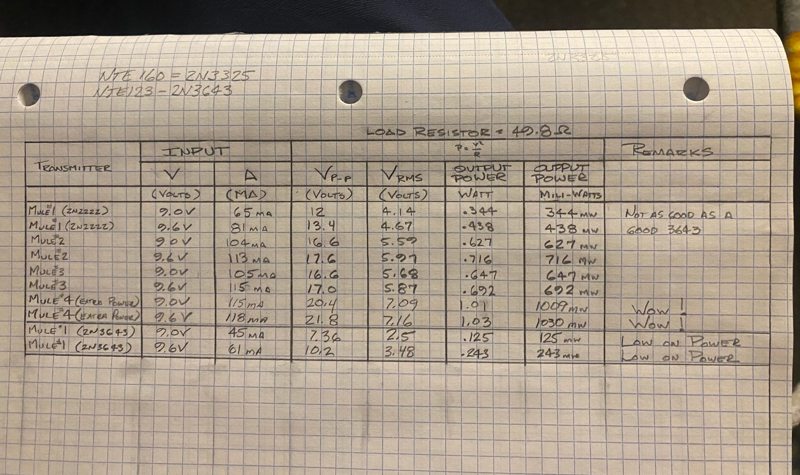

I have been troubleshooting some Controlaire “Mule” single channel radio systems. During this exercise I decided to try and measure power output of the transmitters. I built a test rig with a load resistor (49.8 ohms) and measured the Vp-p and Vrms across this resistor with my oscilloscope.
I measured all 4 of the mule transmitters and using ohms law calculated the power output. Mule #1 was measured with the original output transistor and a 2n2222 (since after measuring Mule #1 the output seamed low in comparison). Mule 4 is a “extra power” version one and it does seem to have extra power.
I have a couple of questions:
1. Does this seem like a valid method of testing?
2. Has anyone replaced the output transistor (2n3643) with good results? I was thinking of trying an NTE123, but if someone has found a suitable replacement It would save me some time figuring it out and I would appreciate it!
Thanks for your time!
Test results:

A whip aerial at 27 (or 35) MHz will appear to be far from a pure resistance. It will have a very significant capacitive element. This will be "tuned out" by using either a base or centre loaded aerial. IIRC, the Mule uses a base loaded setup. This means that if you simply replace the aerial with a purely resistive dummy load, you will get very misleading results.
Inductors, like the base loading coil, have an impedance that increases with frequency, so unless it is "tuned out" with an appropriate capacitor, you will almost certainly get a figure far lower than the actual power output.
You also risk frying the output transistor, though most radios were designed with enough heat-sink capacity to allow for short periods of operation with the aerial collapsed, for range checking purposes.
There is a very good "Whip Antenna Calculator" here: https://daycounter.com/Calculators/Whip ... ator.phtml
Simply put in the frequency, length and diameter and it will give you a pretty good indication of the characteristics of your aerial. For a telescopic aerial use the average diameter.
You can then produce a "synthetic" aerial, using the calculated radiation resistance along with a suitable capacitor which should give a better approximation.
Most of these older sets had fairly crude output matching circuits, so don't expect to necessarily get accurate results. You may do better measuring the DC input power to the output stage, or even better, just use a field strength meter to measure the relative power outputs rather than the actual power.
The field strength method is a far more relevant method, as - done carefully - it will take into account not only the actual power output, but also the efficiency of the matching network and aerial.
At the end of the day, what really matters is how much of the supplied power actually makes it into the ether, and that is what a field strength meter measures!

My first step was to use a field strength meter and compare the results and compare them to see if any of them were down on power compared to the others. While doing this I found it was very sensitive to the outside atmosphere (dogs, cats, buildings, etc). So I set the Mules up in the same place and tried to minimize all the other variables. I got the same results that Mule 1 was down compared to the others.
I figured the base loading might have some effect on my measurements, and originally thought since I was looking at relative powers they would all have the same chance.
I will look up the formula you gave me and see if I can approximate the antenna and see if it changes the readings much.
Thanks again for your time.
