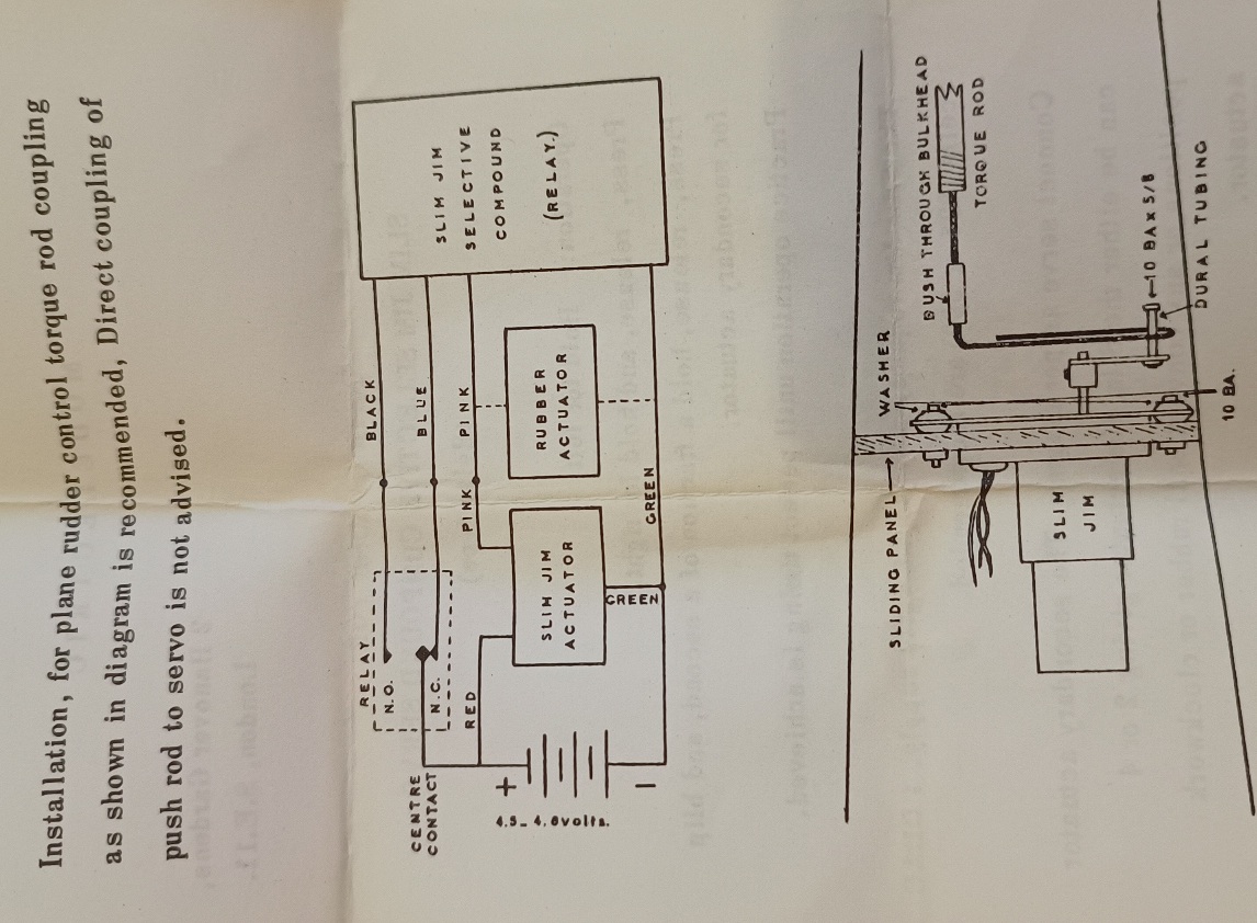

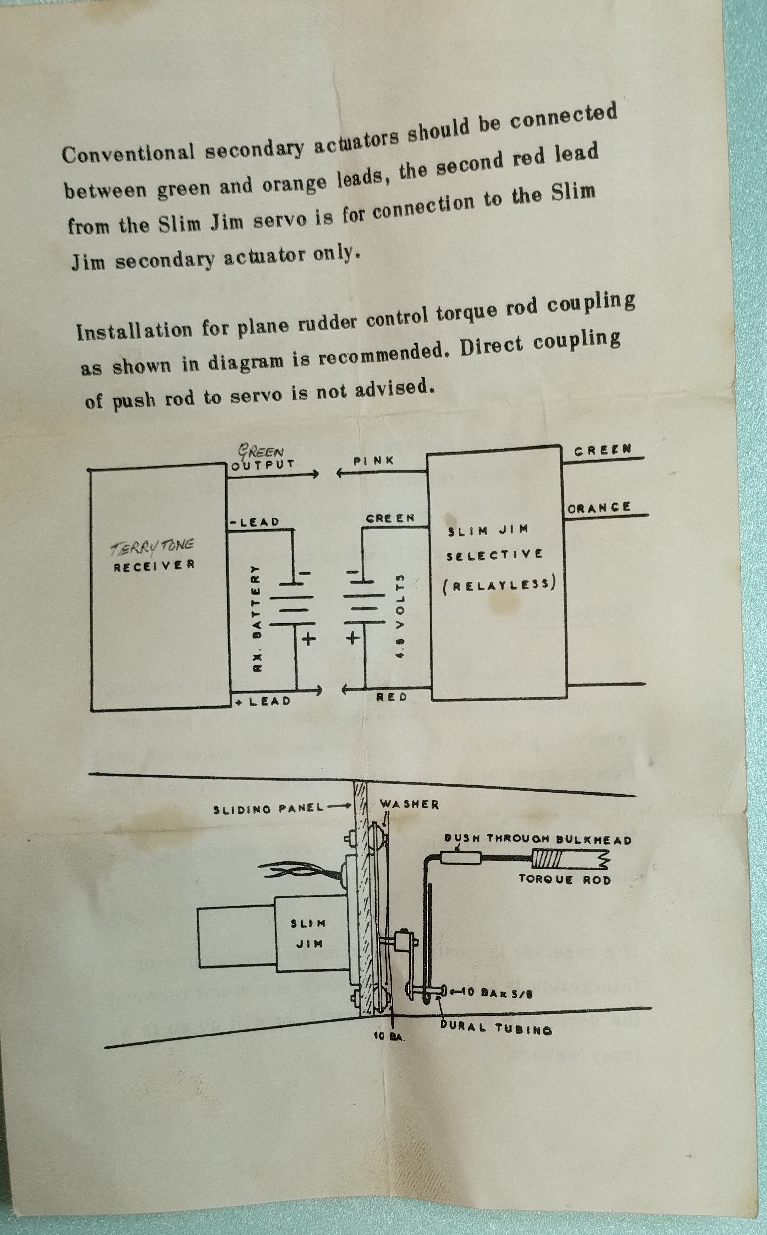

Re: Slim Jim servo instructions & Single Channel receivers
Slim jims were odd because you pressed once for left , twice for right. The opposite of all escapements such as Elmic.
There was a version of the slim Jim for relayless rx's

Resolved simply by moving the output crank (at either the motor or rudder) by 180 degrees on the shaft, Nest'ce'pas ?Shaun wrote: 13 Nov 2023, 13:27 Slim jims were odd because you pressed once for left , twice for right. The opposite of all escapements such as Elmic.

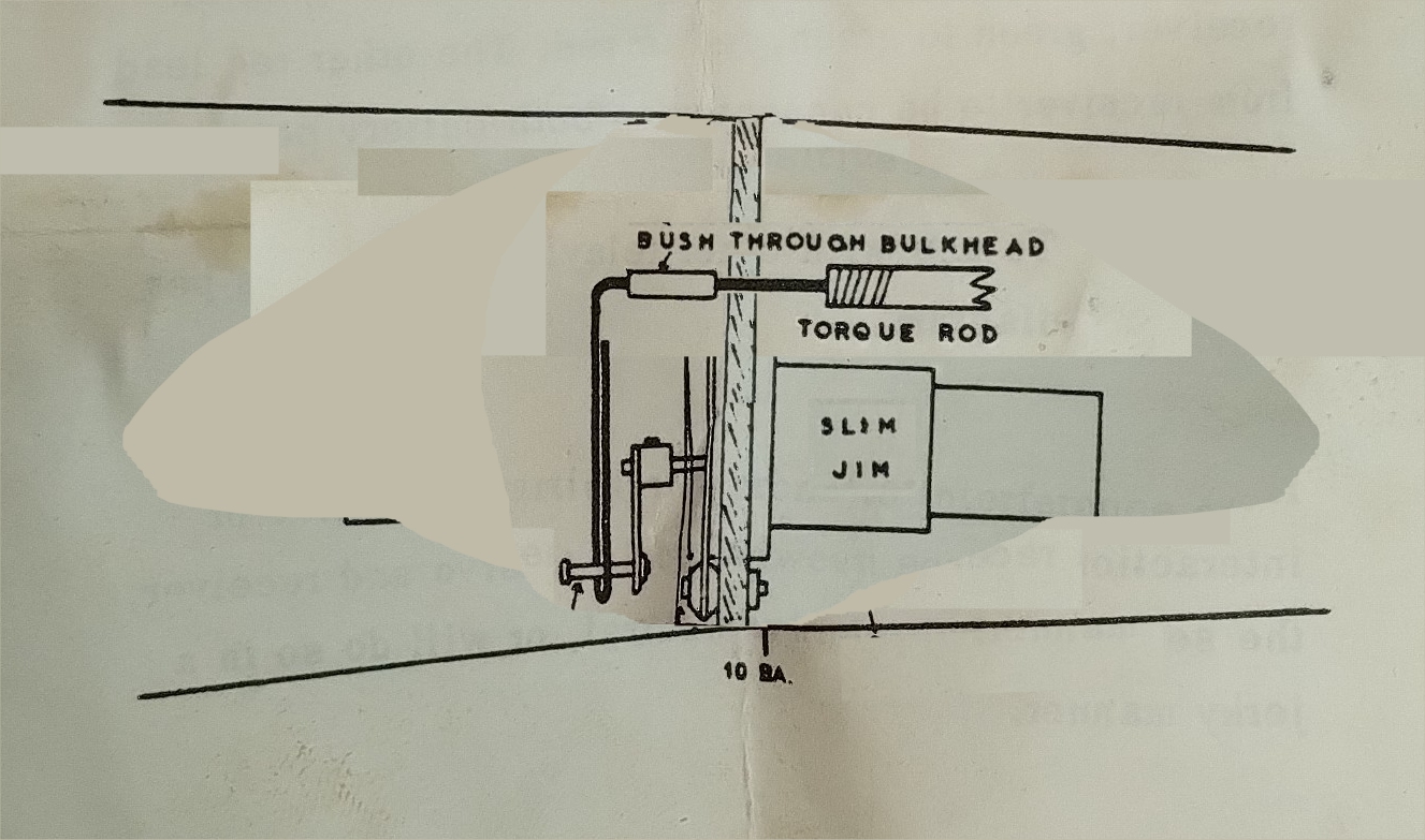

Yes ,they chose to be different.

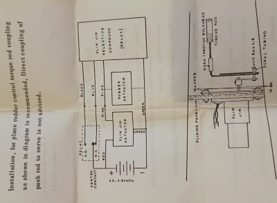

The slim Jim was intended to be installed like a traditional escapement using a torque rod (see diagram,) not via a pushrod. I seem to remember also that the output shaft had a flat on it keying the arm in one position. Moving the out put arm wouldn't change the direction of rotation. In a boat however you could easily change direction with a push rod. A few Japanese motorised actuators also used this key sequence.In fact one set up was. 1st press left, 2nd right, 3rd up, 4th down, 5th throttle change... No quick blip. I set one up to see and glad I didn't try it in the air. Not easy to get the throttle correct. ..

Hi Shaun, Thanks for the diagram, I am sure I can get them working from that. I will keep my fingers crossed regarding the receivers. Best wishes, Malc.

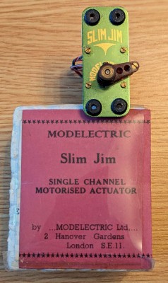

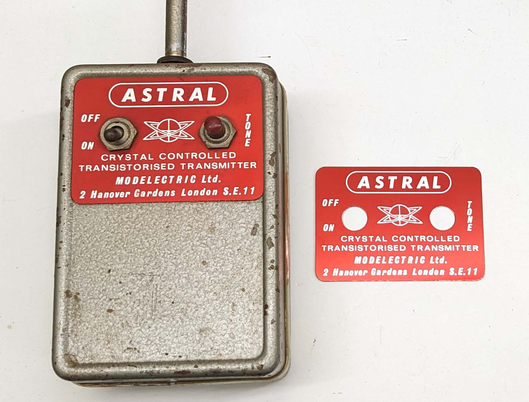

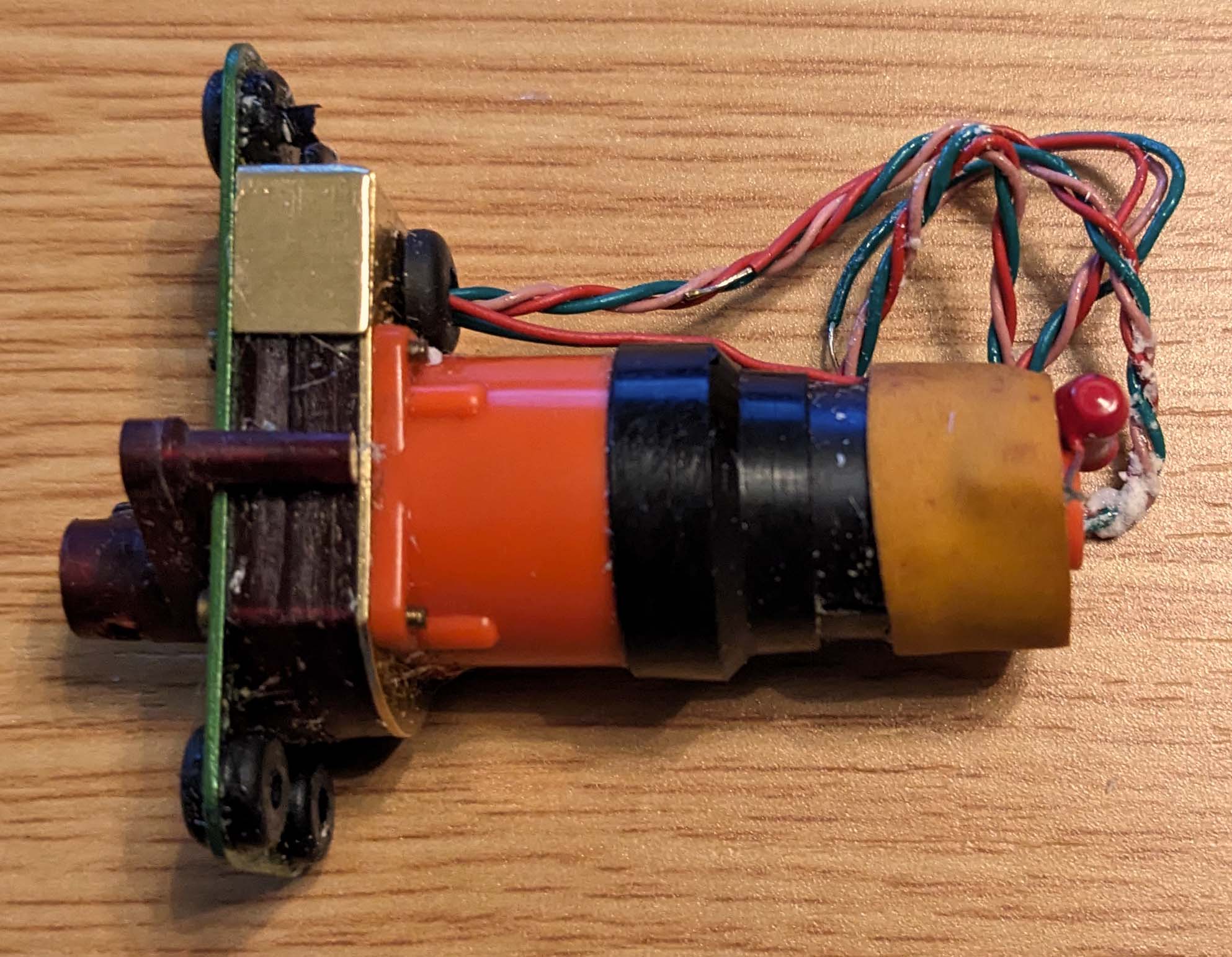

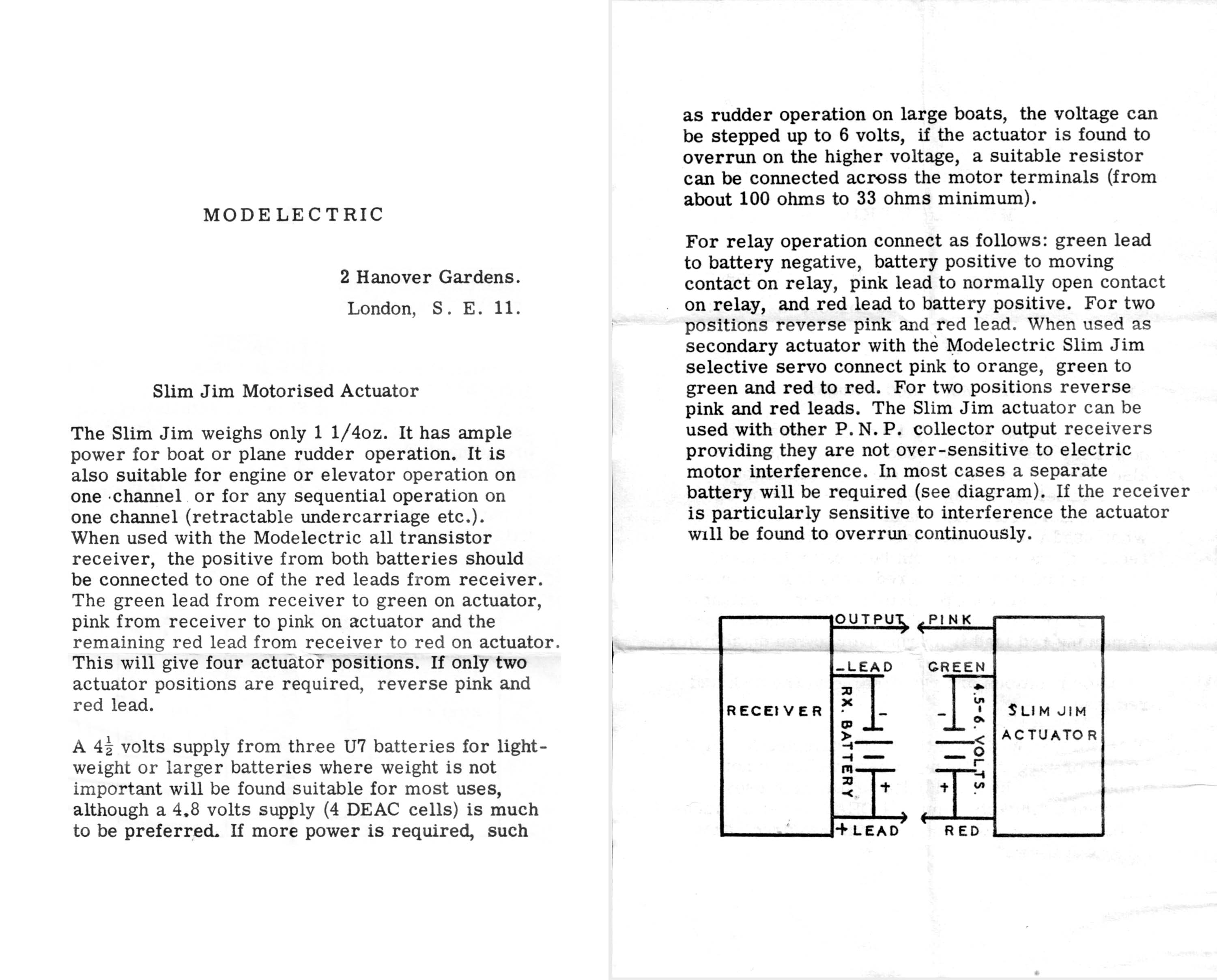

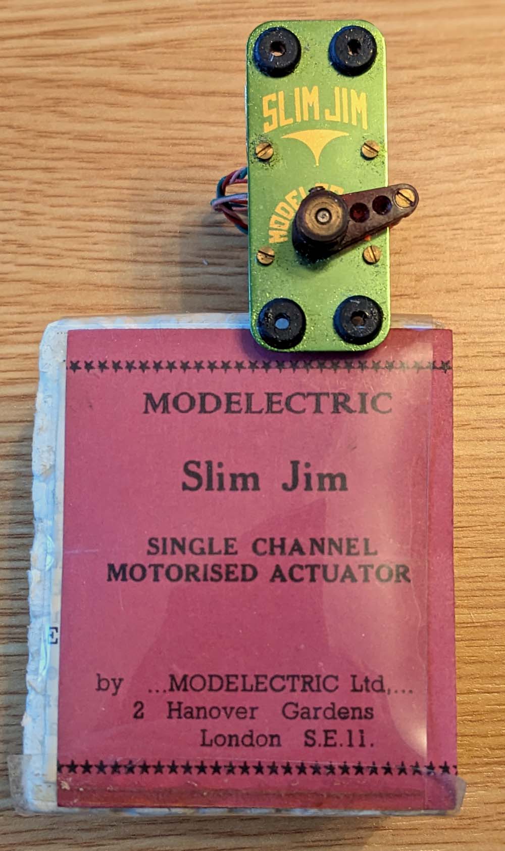

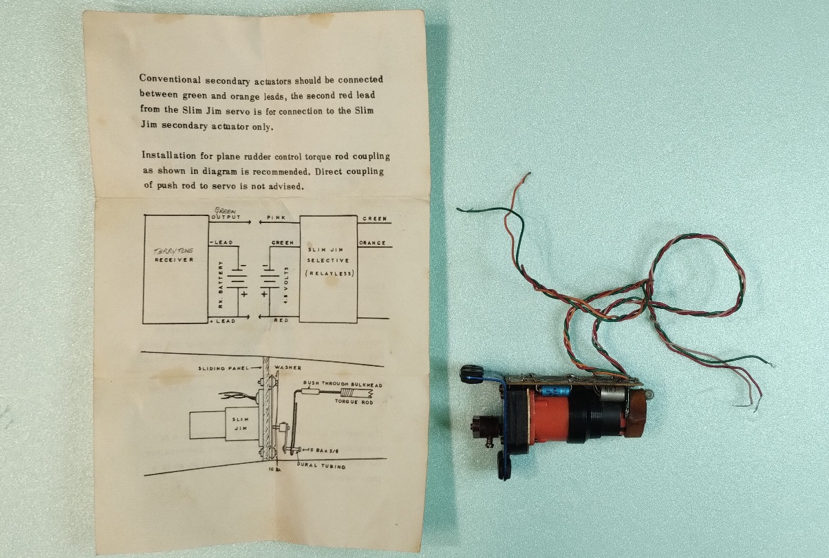

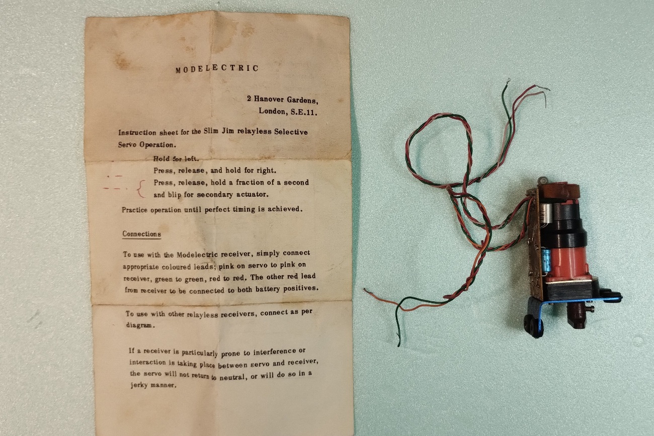

Shaun kindly gave me a Slim Jim to go with my Astral Tx a while back (both made by Modelectric Ltd), so here are some pictures and a scan of the instructions so you can all see what one looks like
And I found a spare label for the Tx on eBay recently, quite a bizarre find
