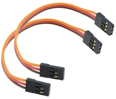

After many, many failures and three different crimping tools, I've concluded that I'm incapable of doing neat, reliable joints
I envy those who can but there comes a point where you're just forced to accept your limitations
Consequently I would rather graft on a standard servo cable, preferably replacing the whole lead or if thats not possible, extending
with a few inches of ready-made 'servo lead'. To this end I buy bundles of ready-made leads, these for example are female-female leads (in EE's terms, aeromodellers insist servo connectors are male) and snip them in half to make two 'adapters'. I usually go for twisted cable, though as PaulJ pointed out, you can split and twist the ribbon ones (I'd never thought of doing that!).
Re: Wiring connectors
Like Tobe, I crimp my own.
My experience with wire gauges - too light a wire and/or too heavy handed & you risk damaging/breaking wire strands within the insulation and adversly affecting current carrying capacity and vibration resistance, while too "heavy" a gauge can deform the insulation such that the crimped end doesn't fit correctly in the connector housing. I typically use 24swg. Practice, practice
However I also have a stock of the leads Phil showed above. FYI, they are commonly used in quads and FPV applications between the Rx and flight controller.
