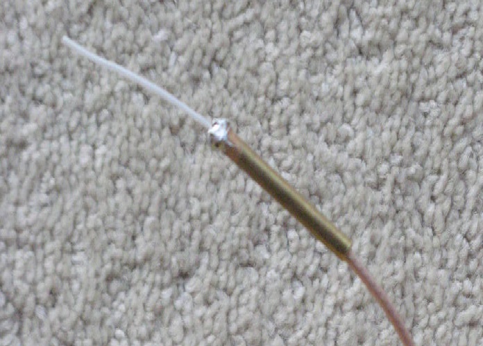

What Martin described so eloquently is this, which I posted in "another place" way back......

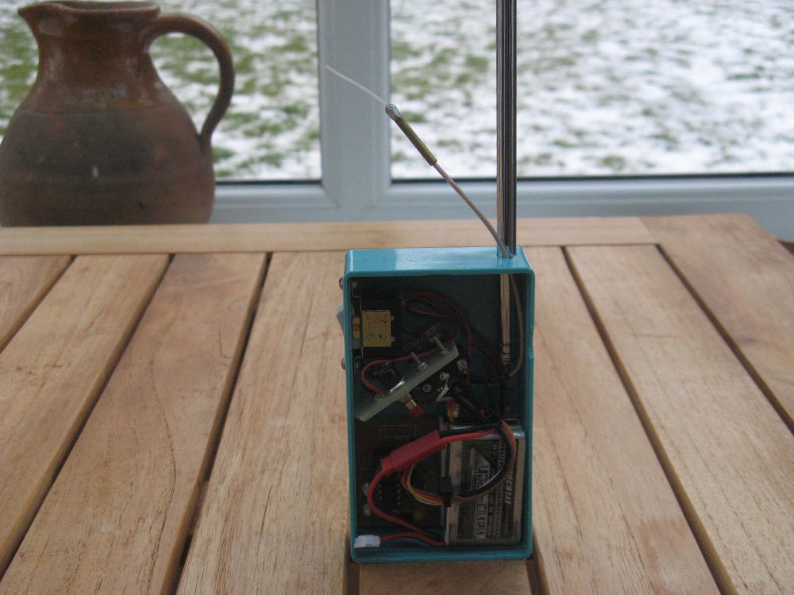

Peel back the screening to expose the correct length of the centre conductor. Cut most of the conductor off but leave enogh to solder it round the top of the brass tube. From memory I think the exposed length was 29mm with the same length of brass tube. It seems to work well enough though of course you should range check it on the ground before flying it. I suspect your RDT won't be very different to this conversion of a Futaba FT-3A
The 27MHz antenna is just for show and the 2.4GHz antenna is normally hidden within a pretty frequency pennant. There is an Orange DSM2 DIY transmitter module hidden behind the battery.-

Sorry Paul. I wrongly assumed it was Phil that posted that.
Thanks for reposting the information and the photo.
