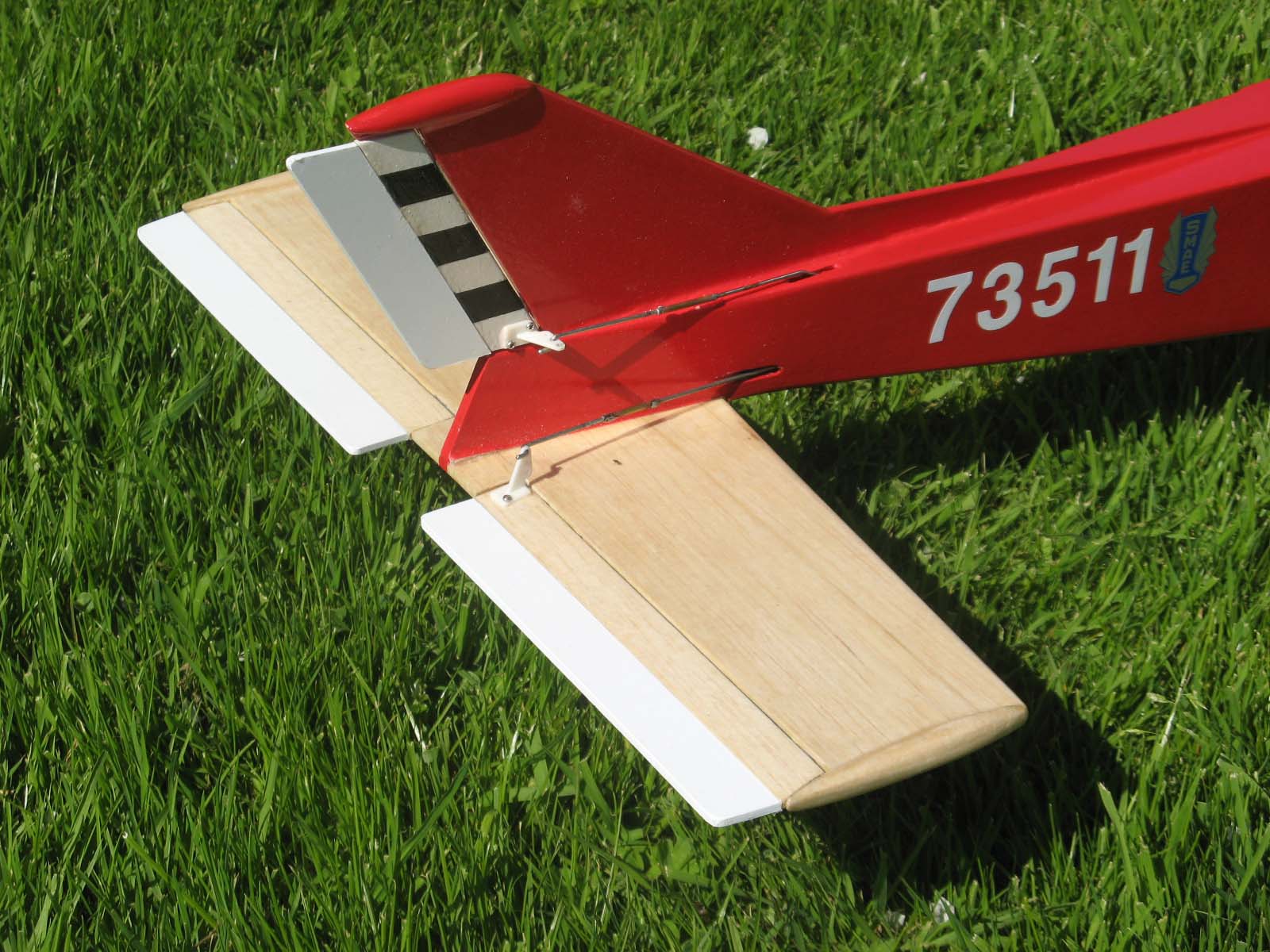

David, thanks for your tips. As it happens I have done more mods and test flew it just a few days ago. As you can see, I have more than doubled the size of the control surfaces by (as a temporary measure) adding some bits of Depron to the trailing edges........
Thanks again for your input.
It's not right yet but at least I did manage one flight and got it back on the ground in one piece! I was under some pressure of time so I wasn't able to make the adjustment on that occasion but it needs some down trim which when added will I think make the elevator trim much as you describe. It is difficult to measure control surface movement when they are all waggling about! However I think the rudder is probably not far out on your suggested 35 degrees and I might need a bit more elevator movement. As I said, it does need some down trim but the biggest problem was a marked pitch UP when I applied rudder in either direction. I wondered if it might be due to the swept hinge line causing the rudder to act as an elevator??? I'm not sure what I can do about that but I thought I would sort out the elevator trim first and then see what it's like........ Thanks again for your input.

It's good you got a full flight with the Timber. I have a now-elderly Veron "Robot" that also has a swept fin. There's no problem with control interaction, but then, it's got a Controlaire "Ghost" actuator in it, which seems relatively free from it.
I assume you're using a Tobe Rand? You could try reducing both the aileron and elevator travel at the transmitter to 50%, then watching to see how "clean" the movements are on the model. If there's no or very little interaction, you can increase the percentages in small increments until you've gone as far as you can. You might not be able to eradicate it completely though . . .
My experience with a number of GG models has been that all have needed a fair bit of fettling (I.e. trimming) to get the best out of them. There are some that will never be much good - the Vic Smeed "Chatterbox" is one: it does fly, but it's got quite a high wing loading, which, as it has to fly quite fast, tends to make it squirelly. In fact, it's very aerobatic! A better size and wing loading for GG appears to be around 42 -48" w/s and 12 - 15 ozs/sq.ft.
Keep persevering - you'll get there!
- Posts: 652
Re: Simple pleasures
Yes it is the Tobe actuator that I am using but I am sure that is working as it is supposed to. I think the problems, such as they are, are due to the model, which was not originally designed for GG and with my own lack of GG experience. I had to add an elevator and guess at size and how much control surface movement to use and I didn't get it quite right but as you said....... I'll get there
