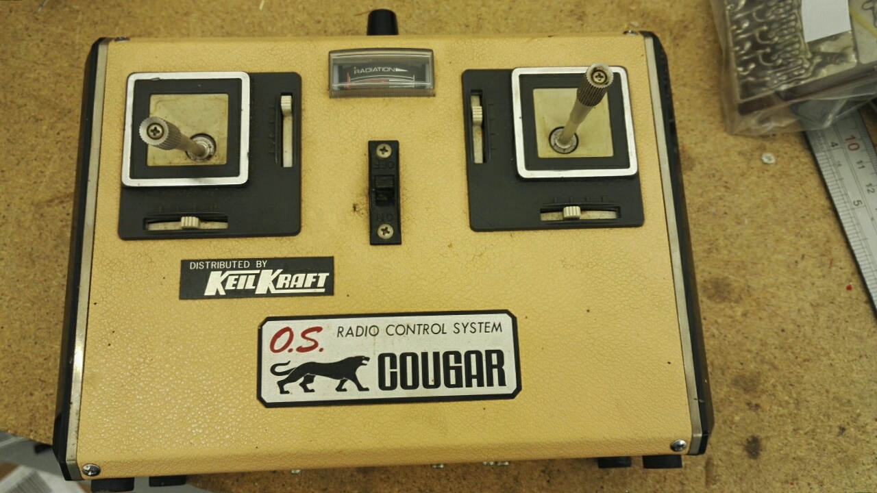

Just got a boxed Cougar 5 Mk 2.Tx case cleaned up ok, but need to get corroded batteries out.
There are two battery boxes which look like they are screwed to the case bottom with a single screw.
Tried unscrewing the black screw on bottom and battery box is still in there, any ideas what might be retaining the battery?

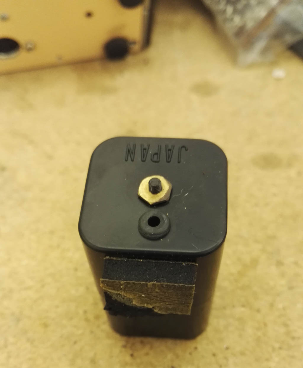

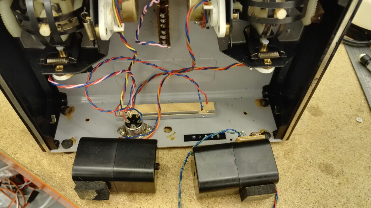

Hi Guys, similar tape found to that described by Mike.
The two screws on the bottom face, that I mentioned, spin when the battery boxes are turned so it looks like they do retain the boxes. There is a small nut at the top of the box, nicely corroded so have given them a drop or two of penetrating oil and will try again tomorrow.

Re: OS Cougar Mark 2
Hi Stuart
My misunderstanding. There obviously is a long screw that goes the whole way through the battery box with a retaining nut on the top, I assumed that you had put a small spanner or pliers on this and unscrewed the long screw and were struggling with some other fixing. But when you have removed this screw you will find the double sided tape is still firmly holding the battery box in, it will need gentle persuasion to remove.
If the long screw is too corroded to remove, you could just drill the screw head out. If you damage the long screw getting it out and you want to re-use the battery boxes, you are quite welcome to mine as the Cougar is destined to be converted to 2.4GHz and be powered by a small lipo battery, the battery boxes are surplus to my requirements.
Regards
