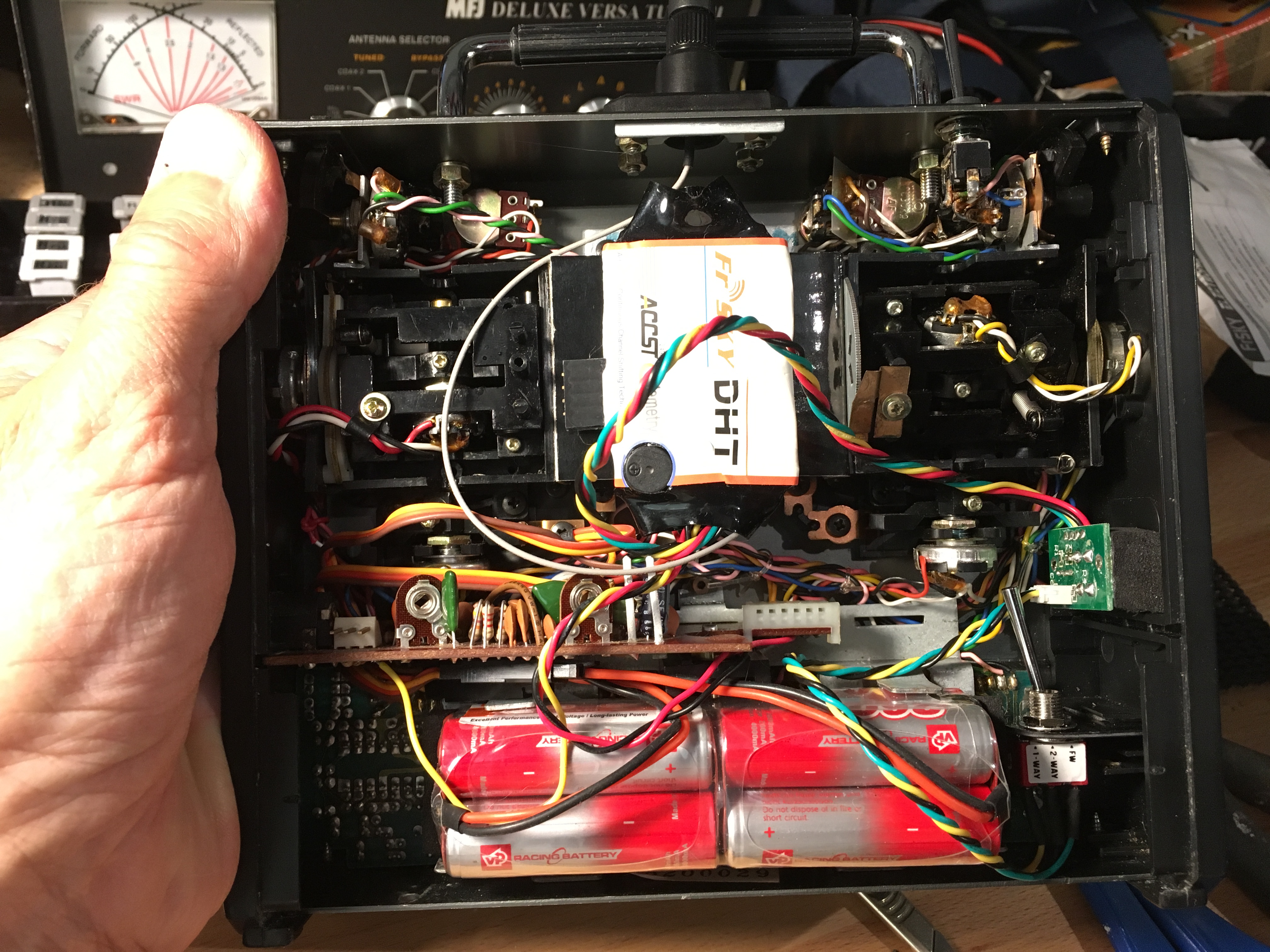

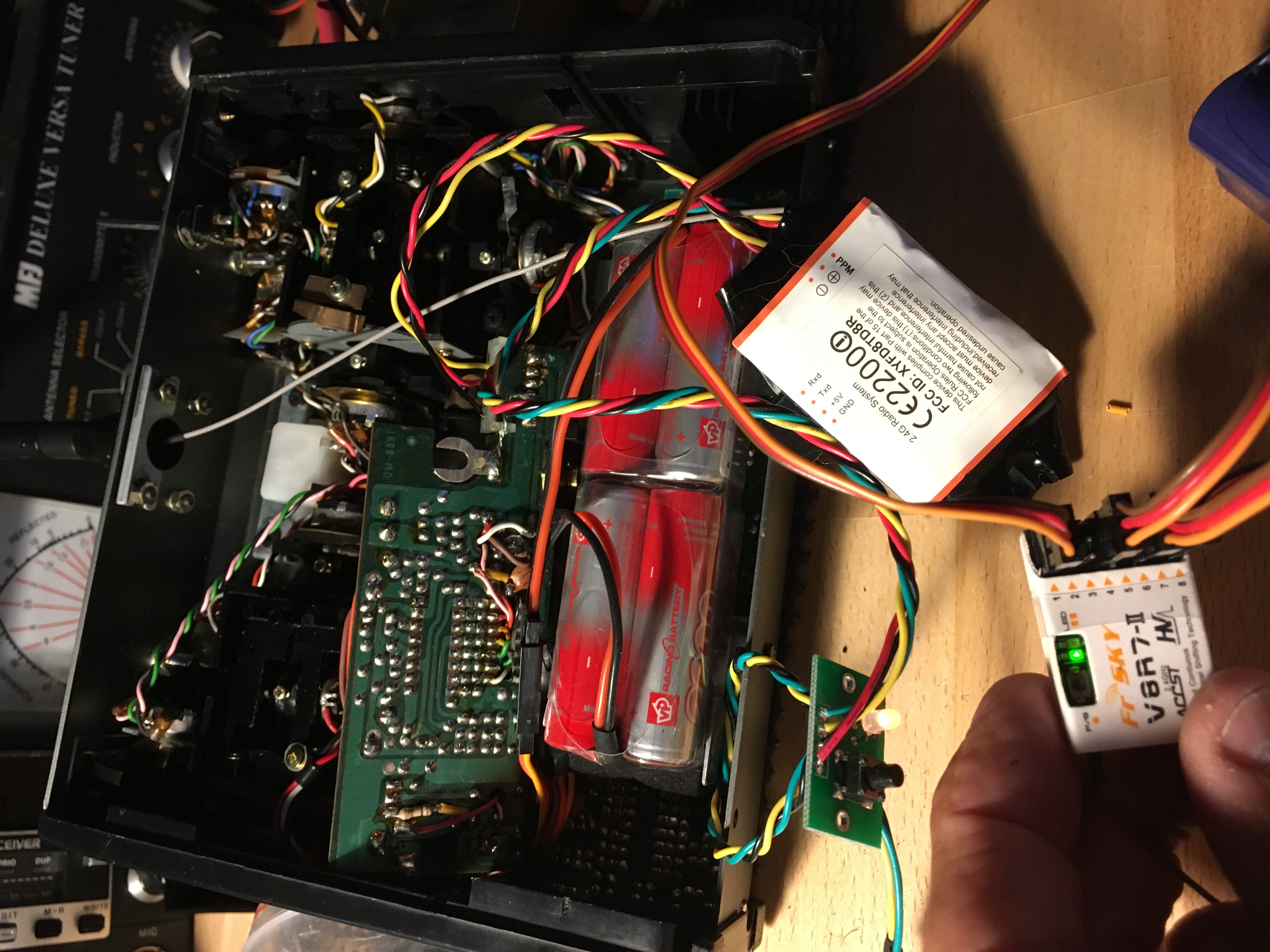

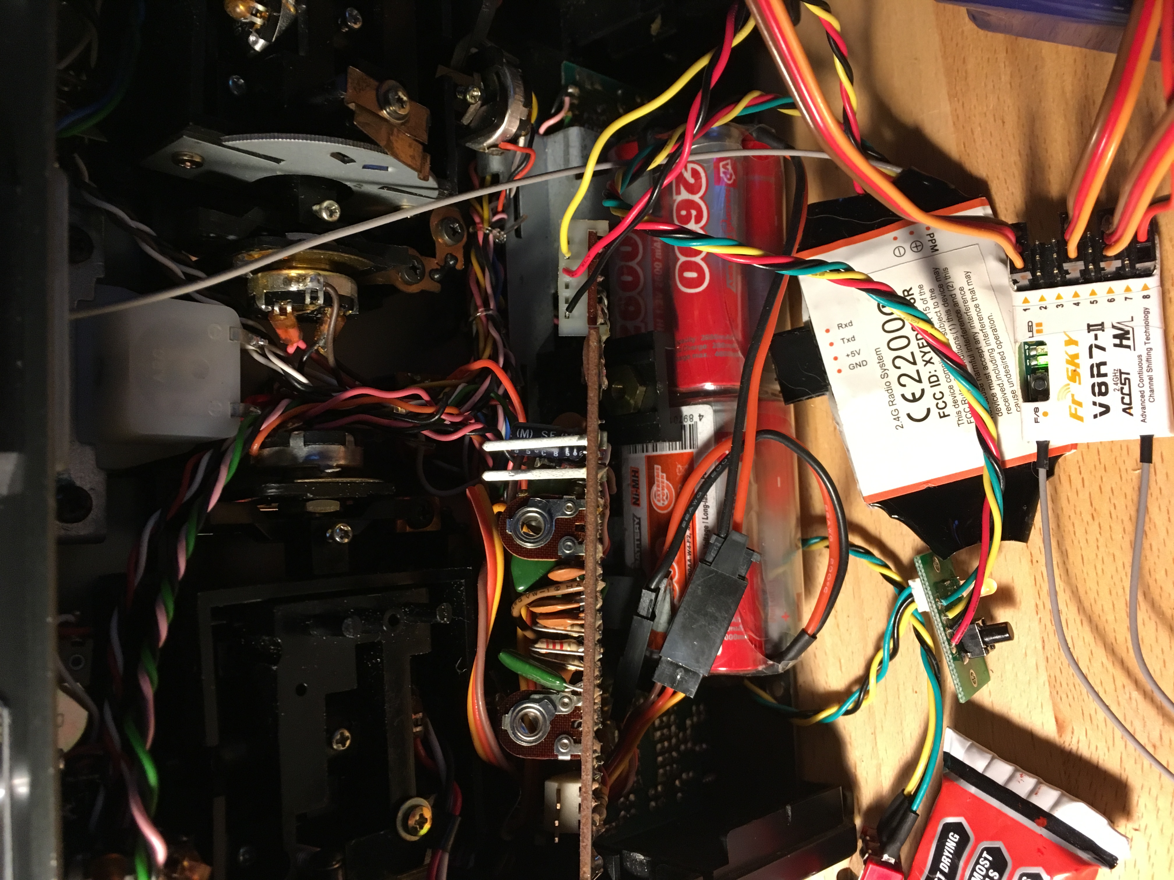

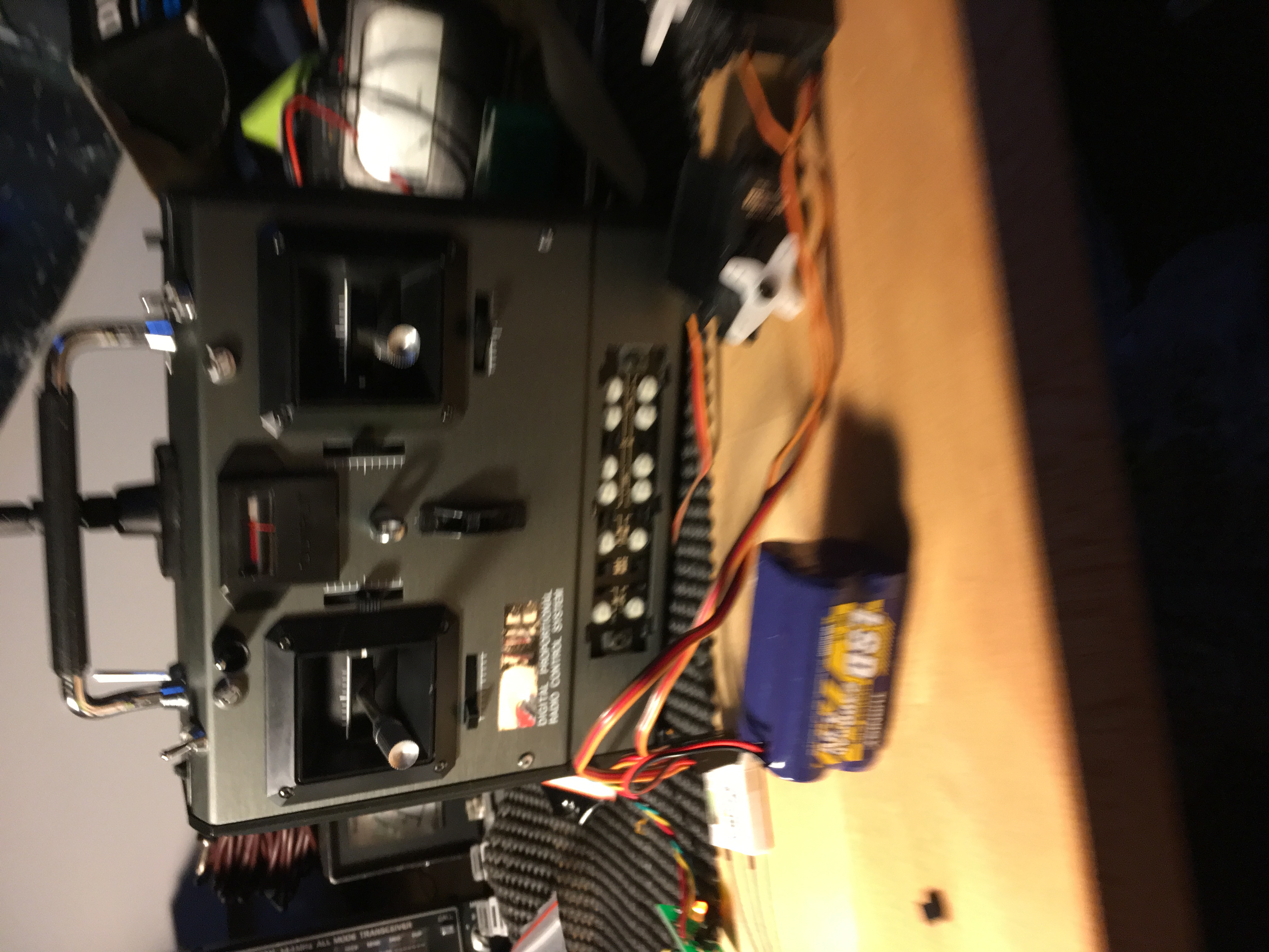

Hello everyone. Well this is a departure for me As I have never fitted a 2.4 GHz module to any of my transmitters preferring to keep them original. However the 35 MHz FM module was intermittent. I got it working but there must be a component Failure. As I had a 2.4 GHz conversion kit I’ve decided to use it. It seems I can get the transmitter and receiver to bind. But I cannot get any movement at the servos Yet I’m sure I have selected the PPM output to the 2.4 GHz transmitter module correctly. Any clues would be much appreciated!

Sussed it! Wrong PPM signal feed - now working great! :lol:

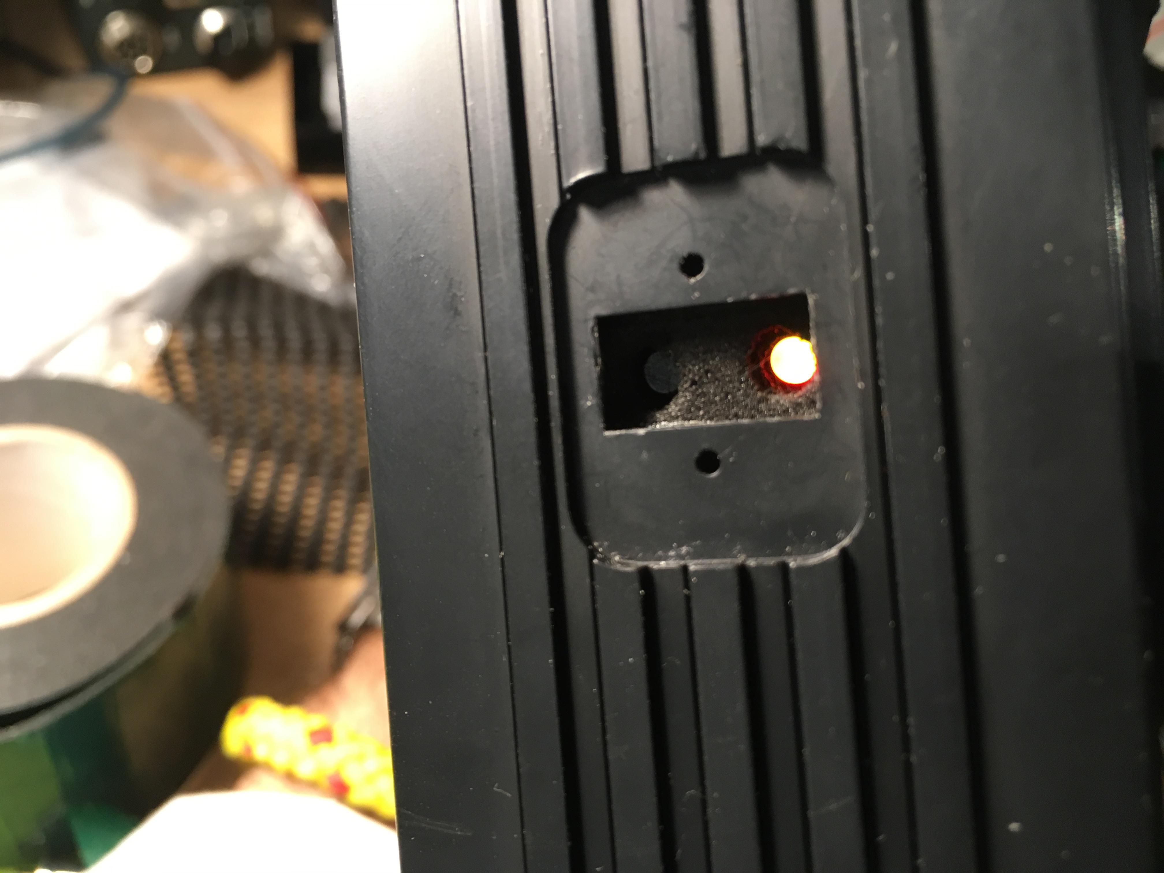

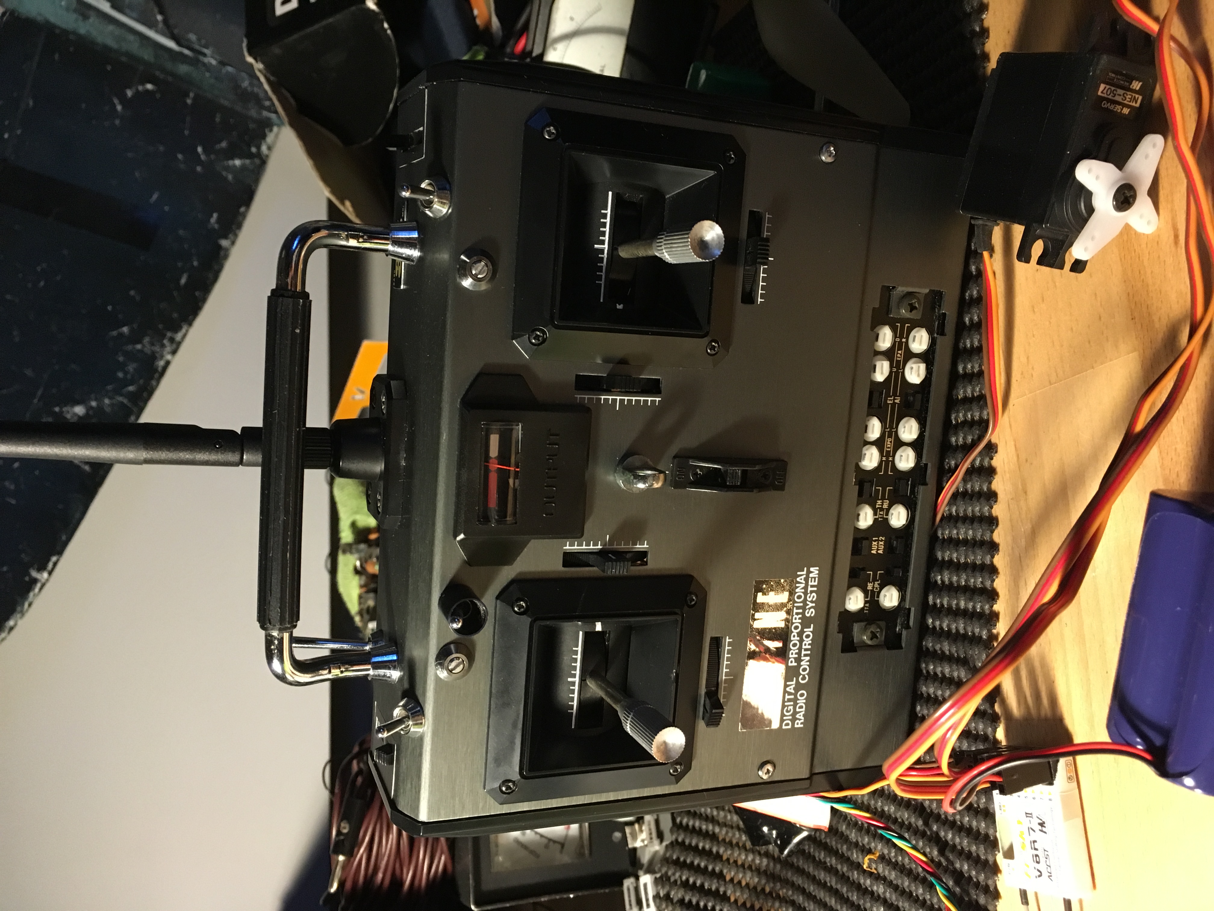

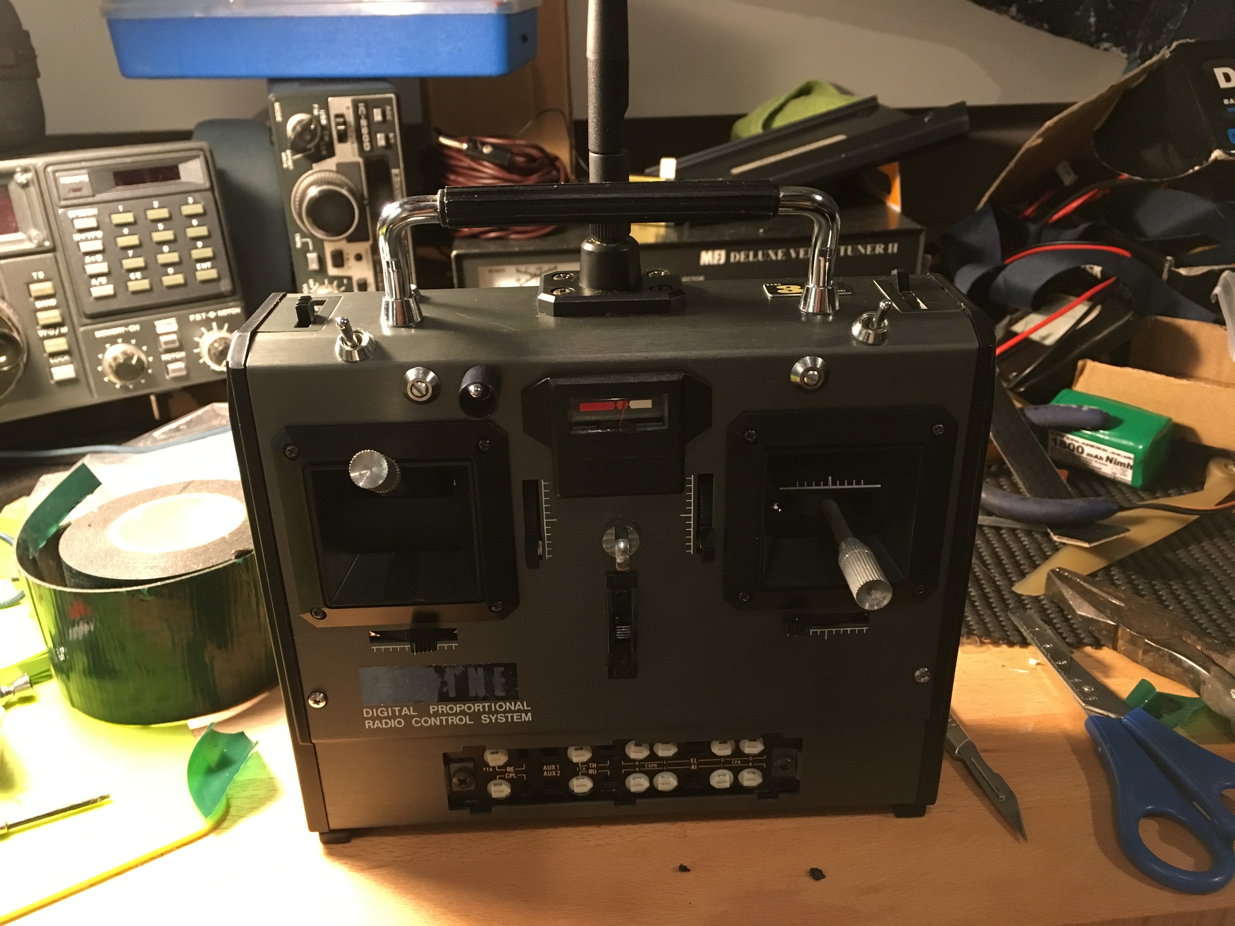

Completed transmitter. Bind button and LED sit recessed within the xtal hole. I kept the mode 1and 2 switch hidden inside - works amazingly well and locks on immediately with the rx very unlike my spectrum DSM2 outfits which I am not keen on
