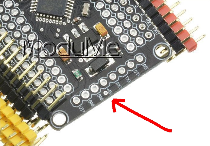

2) The mods listed in this post do not apply to the similar-looking Deek-Robot board!
Recently (2017) a variation of the 328P board has been supplied, for us its a better board and whilst at a quick glance it looks identical, its easily identified by the tiny Through-Plated-Hole (TPH) adjacent to the Vcc (+5v) pin:
This one has proven to be the best option for encoder projects as it allows the three encoder connections to be made directly to the end header using a servo plug. The DiyMore is the one with the tiny TPH hole near Vcc (+5v) on the end header.

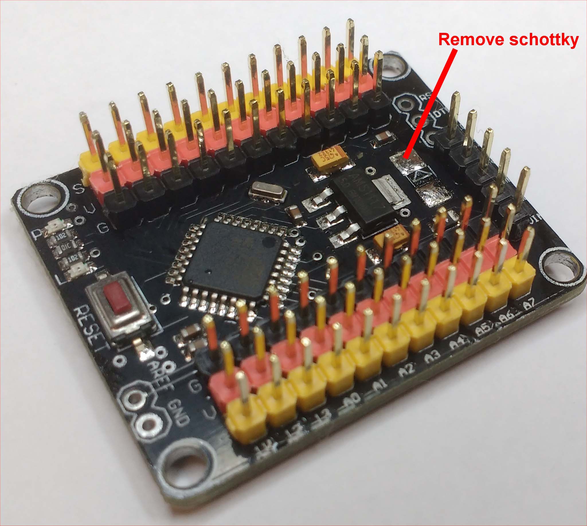

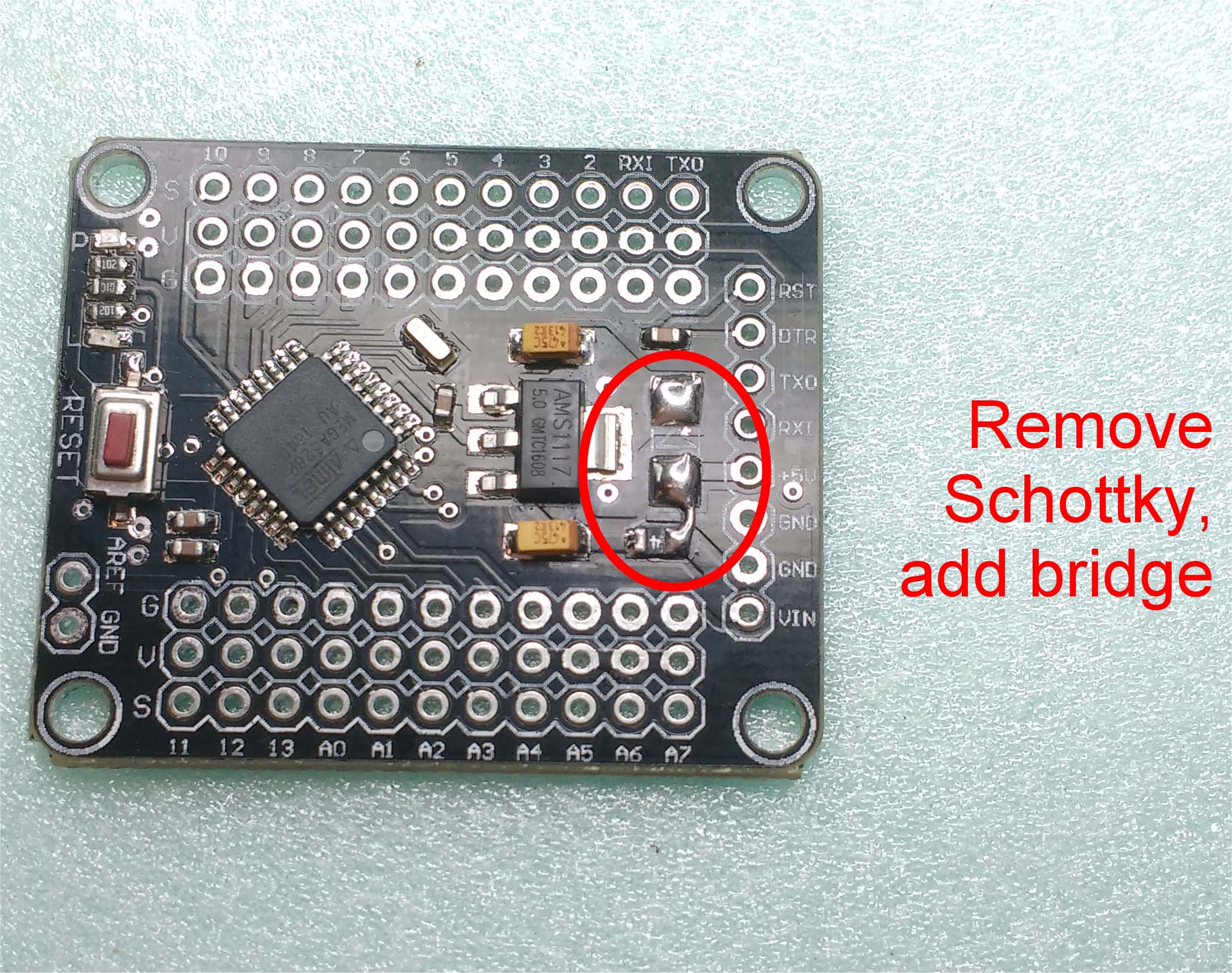

It needs a couple of simple mods, first the schottky diode is removed.
This is much easier before the headers are fitted:

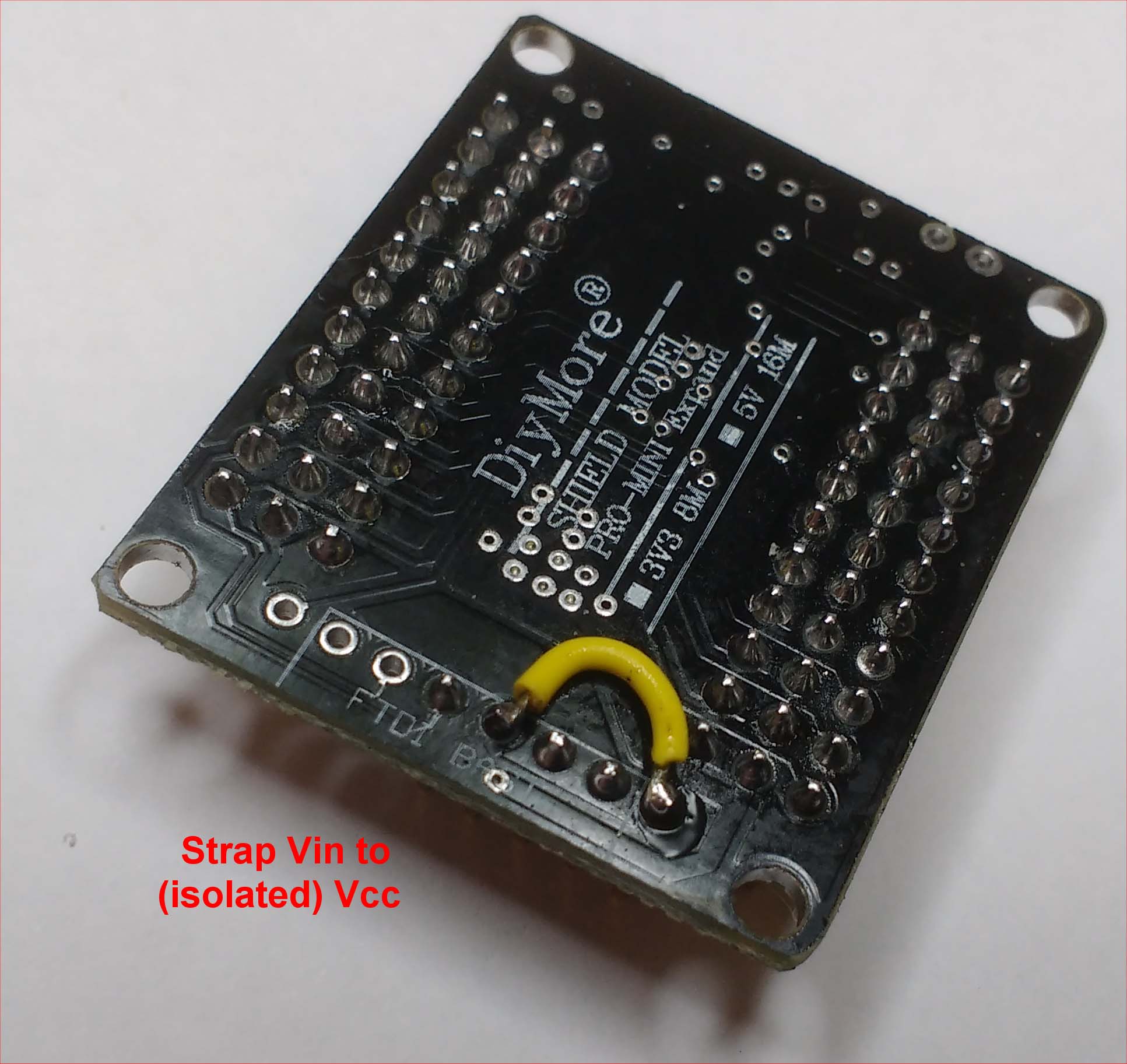

Removing the diode isolates the 5v pin on the end header so that we can use it for the battery supply to the RF module. There are two ways to do this, either using a short wire bridge like this:
… or by soldering a short wire bridge from the old schottky pad to the 4 ohm resistor.
This is my preferred method even if its a bit more fiddly:

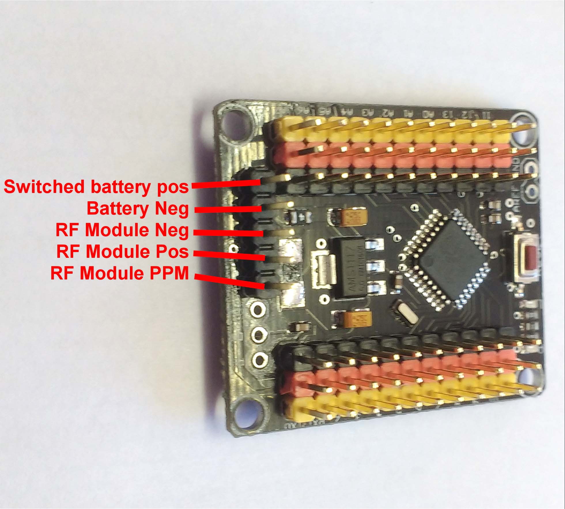

The RF module connections for the DiyMore board are as follows, of the 5 pins, two are for battery switched positive and negative, and three are pos, neg and PPM for the RF module. PPM is on the pin labelled RX1 which is actually D0, of course this also needs to tally in the sketch – static int ppm = 0
The remaining 3 holes are unused.
This is where the DiyMore is much neater than the Deek-Robot board which needs a separate pos supply for the module. A servo lead can be fitted to the module so it plugs straight into the encoder, really neat & flexible:
