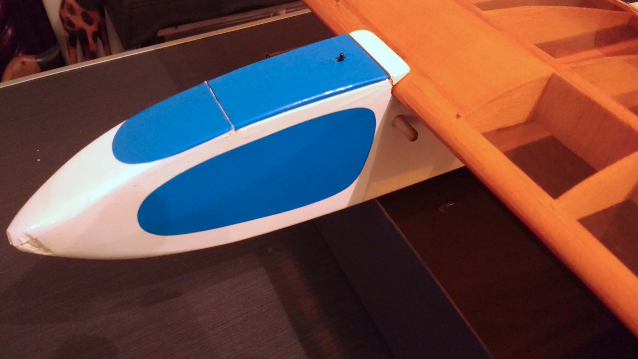

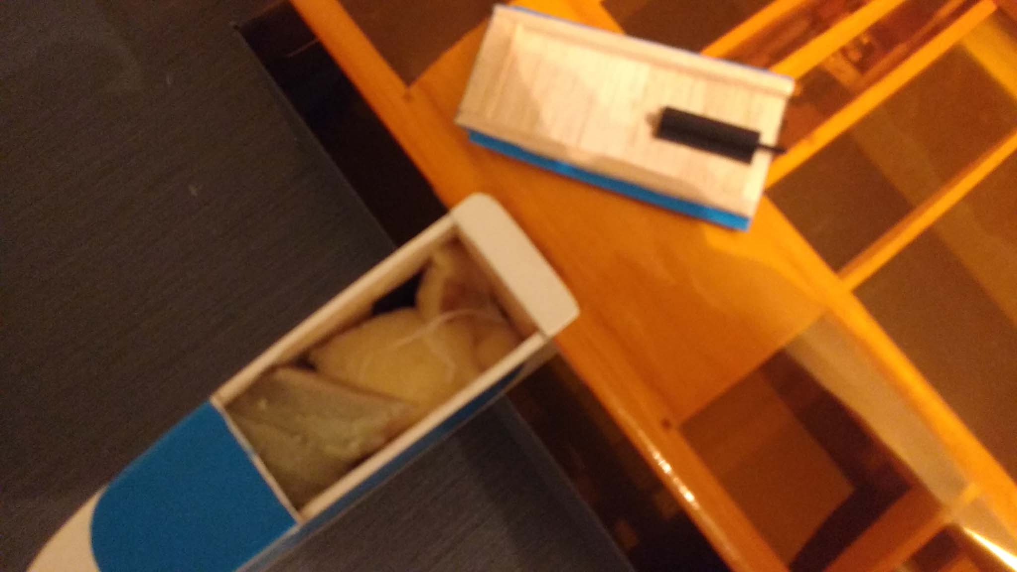

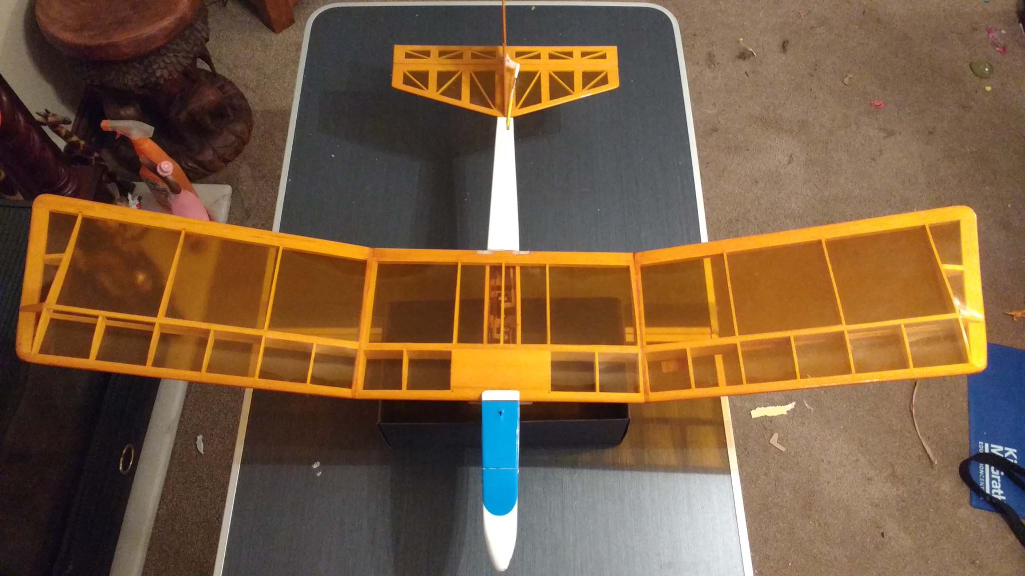

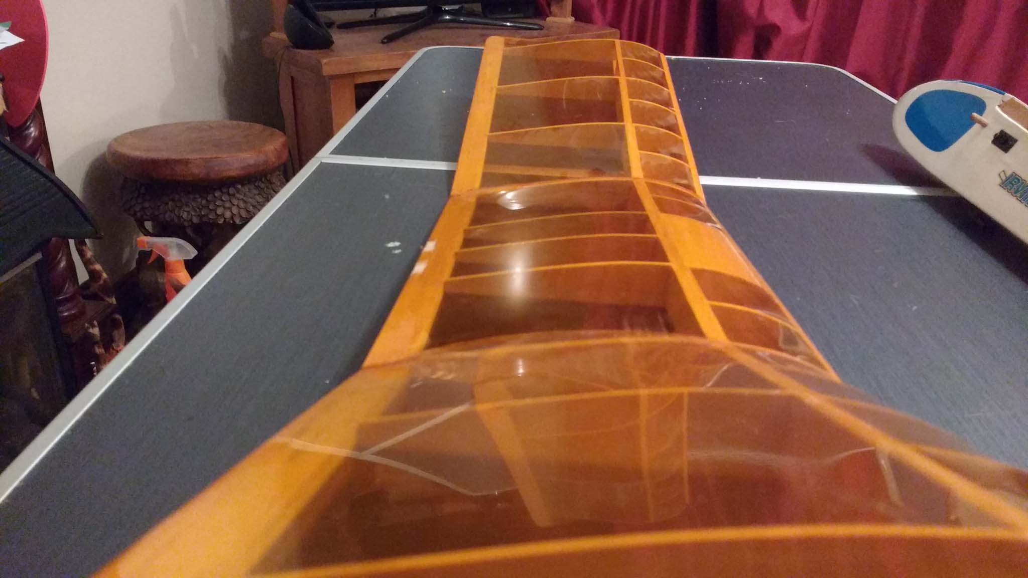

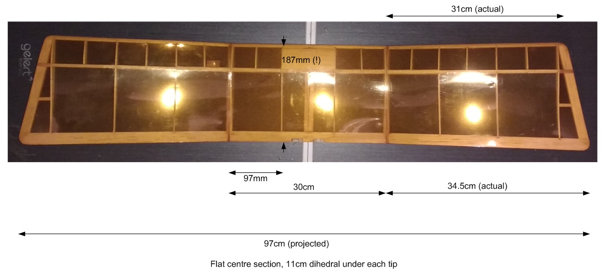

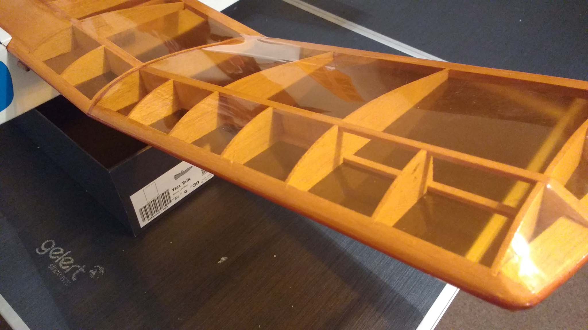

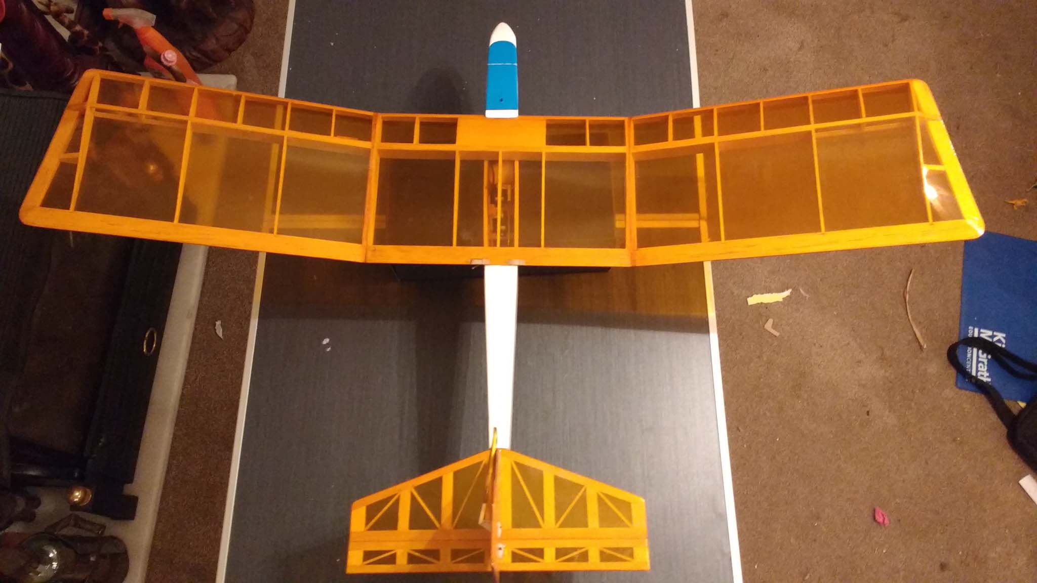

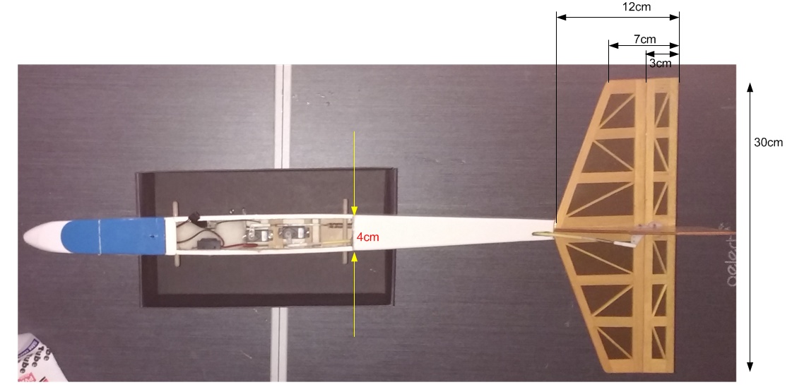

Straightforward Clark Y no undercamber or anything weird. Wide-spaced ribs with riblets.
TE is 3/4 stock, LE is 3/8 preformed. Webbing on all but outer section
Spar is 1/4 sq. There's a few degrees of decalage, guess 3 or 4° ?

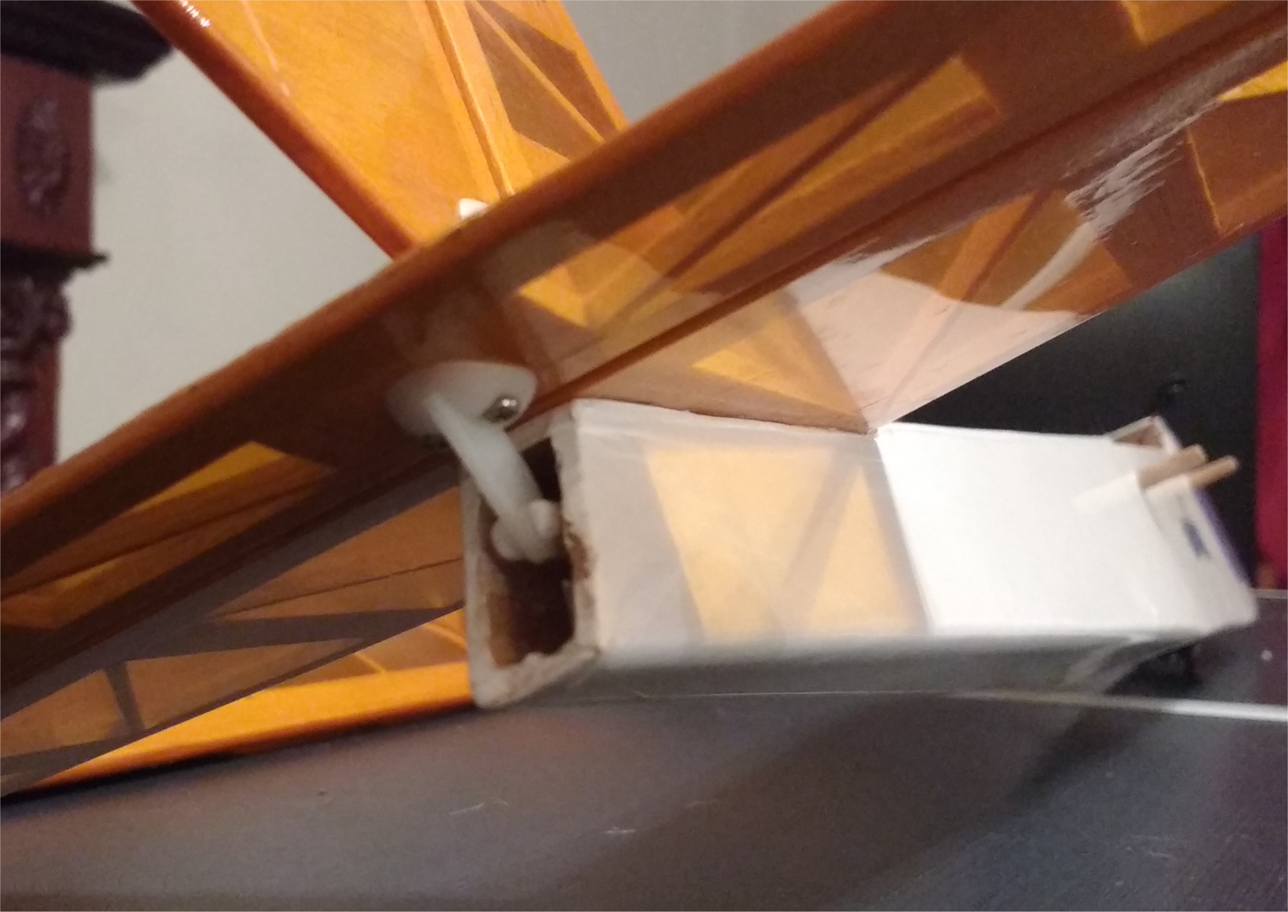

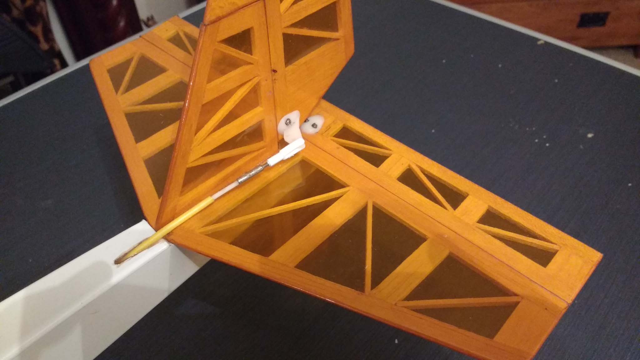

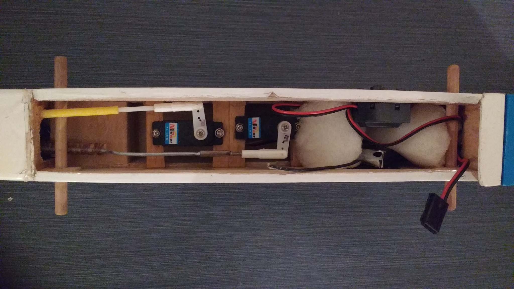

Elevator pushrod, rudder snake
Internal ele horn & clevis

Oooo! I might need one of these. Phil, what's the airfoil thickness please?

Hi Phil
Do you find it needs the kick up elevator?
I know I’ve seen yours fly but can’t remember you using the elevator.
Do you think it would be fine rudder only.

Hi Phil
That should be sufficient to be getting on with then

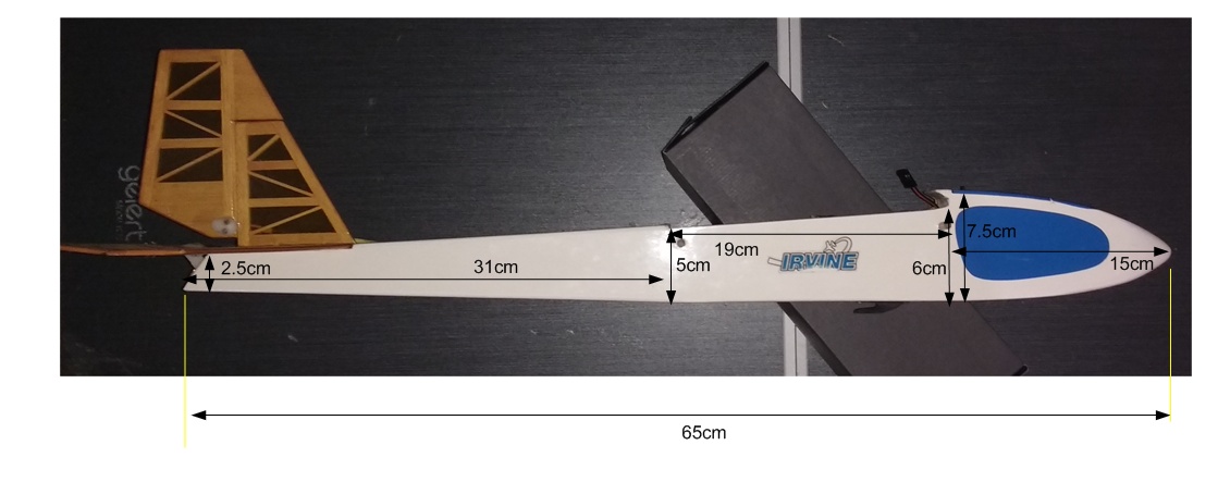

As a quick check, my own drawings made from the box end pic seem pretty close !!!!
I should be able to get something done soon.
The annotated pix are a huge help.

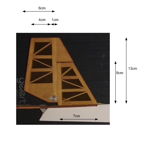

I'm assuming fuselage sides are 2.4 and stab/fin thick 3.0 ?

Re: Recreating the Irvine Pixie S/C or intermediate glider
I hardly ever use kick-up Ron, only for loops. Yes it would be absolutely fine without - if you remember at Marske we were flying it rudder-only using the OS Pixie. In the "Pixie + Pixie" video I dont think I used it at all throughout the whole flight. If I was building another, I wouldnt even fit one, its a brilliant S/C soarer.
In fact I'd implore, maybe even beg Neil not to fit one.... theres absolutely nothing special about a rudder-elevator glider!
I think the fus sides are 1/16 and tail/fin 1/8 thick. The section is a straightforward Clark-Y Gary
Phil, can you check the wing thickness for me, it can't be a real Clark-Y with an 9.5^2mm leading edge, the LE would be around 3mm short in height. I'm guessing it's just a flat bottom 'section' and someone's size 42 insole for a curve on the top to fit the wood 'twixt front and back (AKA a generic 'clark y'
I know, I know, I'm picky - sorry
Most of a/c major parts drawn now - not sure where I'm finding the time, must be something I'm not doing - possibly grasscutting
BTW, incidences are +4deg on wing and +2deg on stab (or 2deg on wing if you like as I didn't straighten your pic up to 0/0

Looking closely at the wing tip photo I'm inclined to think the section is about an inch thick and the spars are 1/4" ×1/8". They don't appear square but of course I don't have one in front of me so I stand to be corrected.
