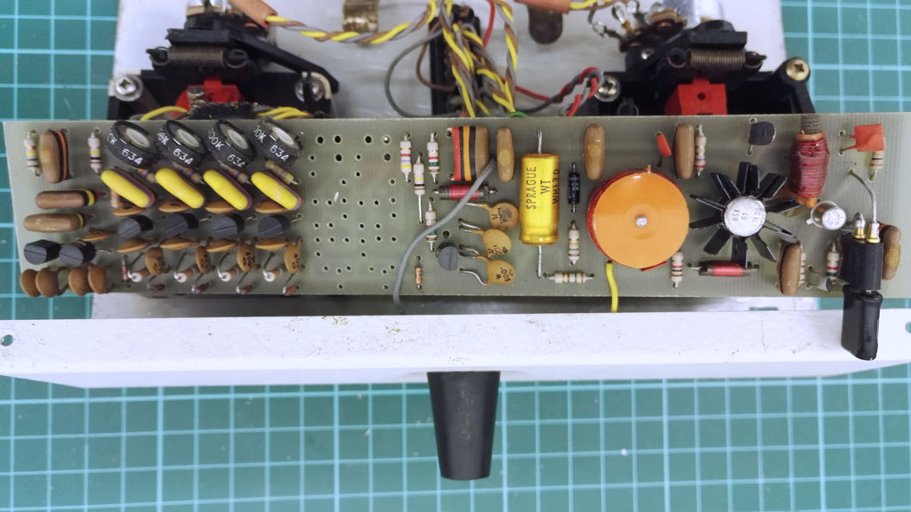

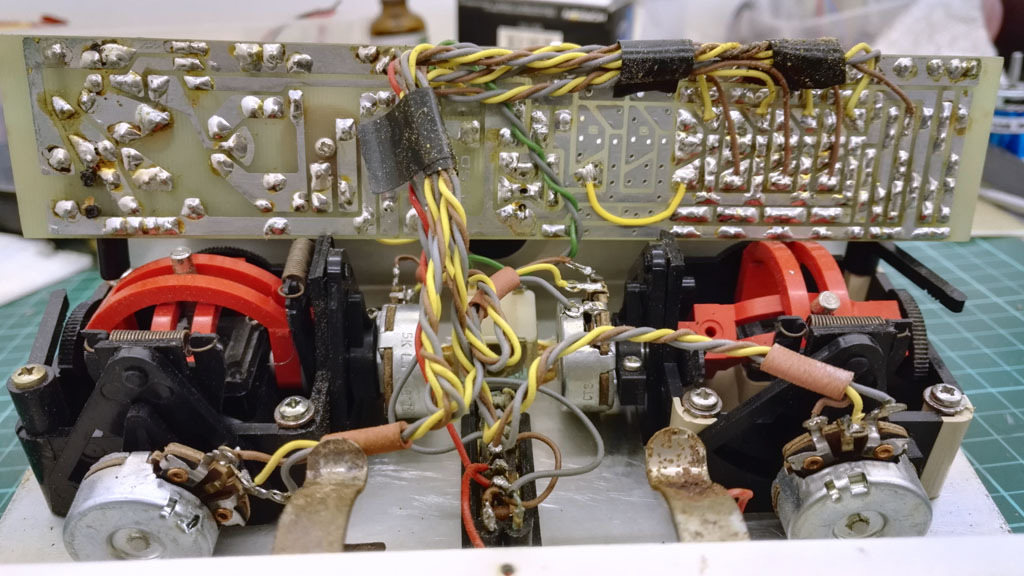

I can't help you with the component layout for the PL-6D, but I've attached some photos of the board from a PL-6D I'm soon to convert to 2.4GHz. If there are any component values you want me to measure, or a better close up, just ask.
