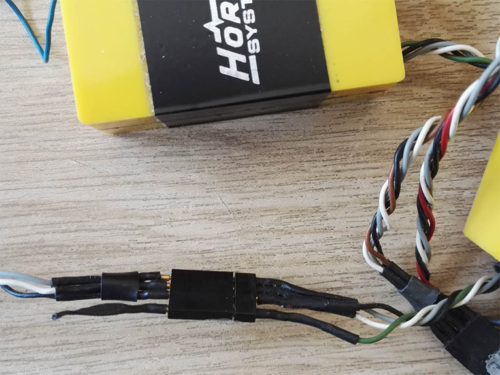

I have a complete Horizon HS2L which I tested as working over a year ago. I've either mislaid the switch/battery wiring harness or worked it out - not sure which. But does anyone have the correct wiring as the connector has 4 wires: green space black white grey. I just can't remember what I did

My Horizon set has the following: Black is 0 volts, White is centre tapped, Grey is positive and the Green is not connected.
On the battery to Rx connector the green (unconnected) goes on the pin which is slightly spaced away from the others, then the black, white and then grey at the "top", as on the left of the connector, the wires on the right moved before I took the photo.

Thanks Mike. That's spot on. I found a 4 cell pack with that wiring arrangement, which I must have made up to test the set in the first place. Still works perfectly
