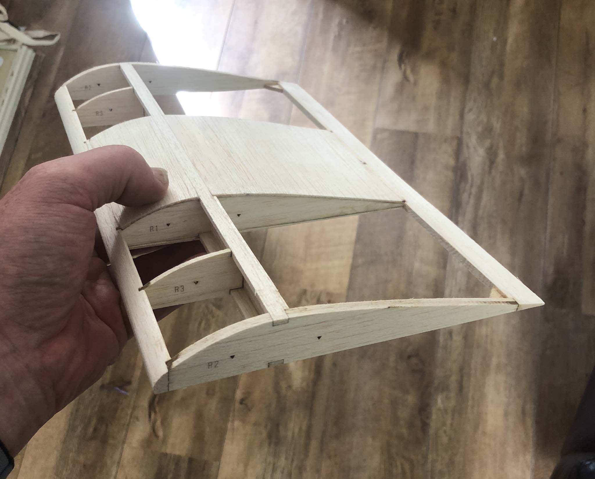

Hi Gordon.
Not sure about a pod yet. I’ll see how she goes first.
Just started the build. I’ve built the center section of the wing. Seems to be going together quite nicely.

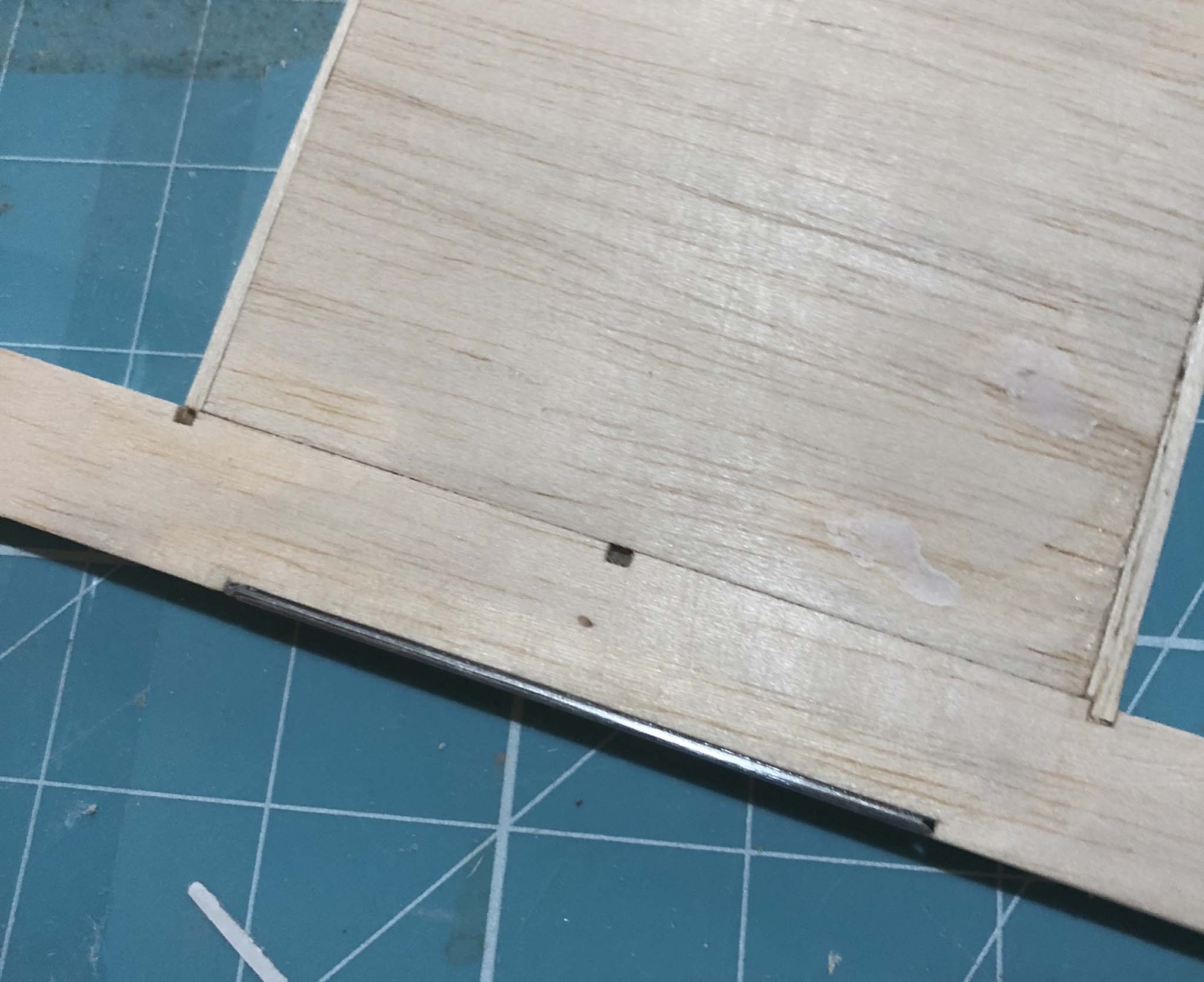

I recommend a small length of thin piano wire around 80mm in length adding to the trailing edge in the center section to stop the rubber bands cutting into it. After sanding the T/E it’s quite thin at the back.
