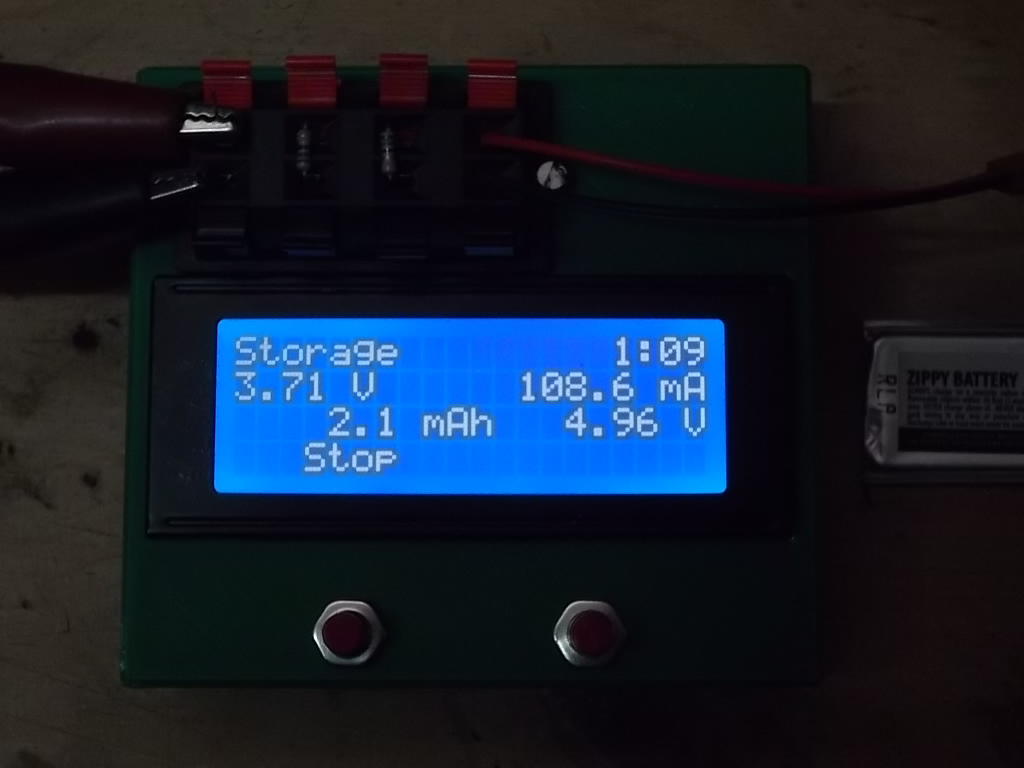

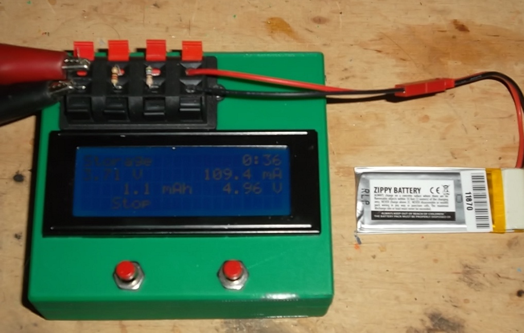

This charger works to a resolution of 0.1 mA, 0.1 mAh and 0.01 V. It's particularly suited to charging the very small capacity cells, typically used on indoor models - there are lots of simple chargers available for these, but they don't usually give you the option to accurately control the charge rate or measure the capacity of the cells.

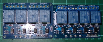

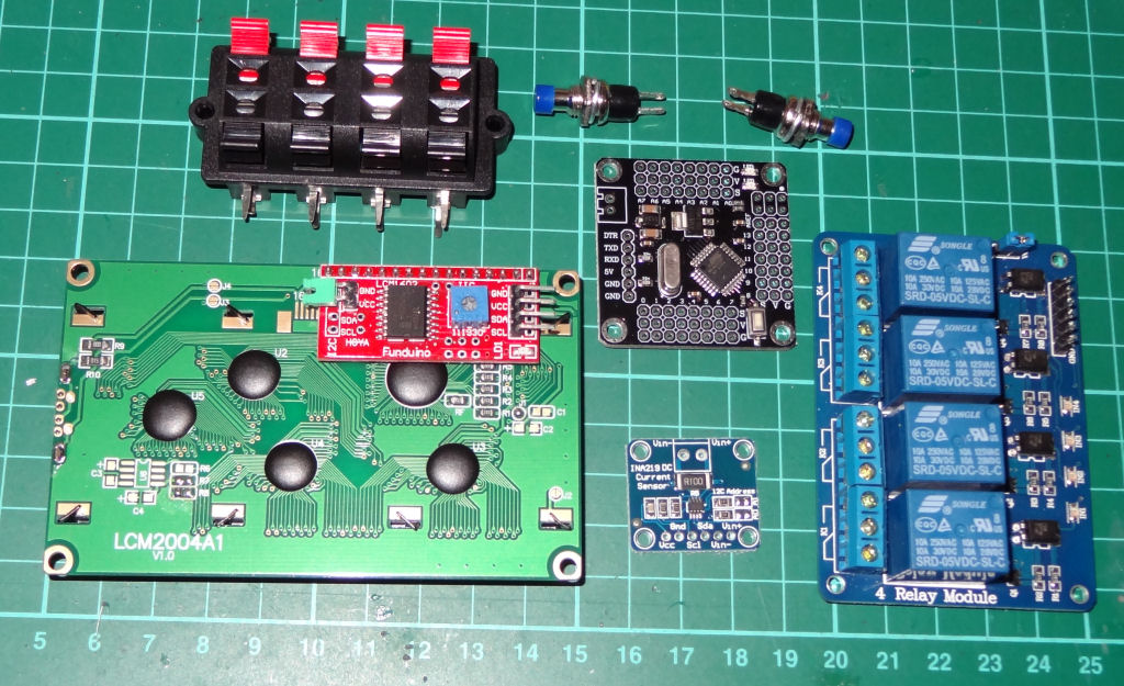

Here's a photo of the components used.

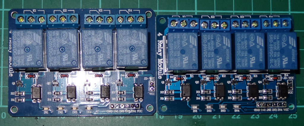

Beware that the relay boards come in at least two different sizes. It would be easy to design a case to suit one size, but then solder up the connections on a different board that doesn't fit the case. Ask me how I know! :oops:

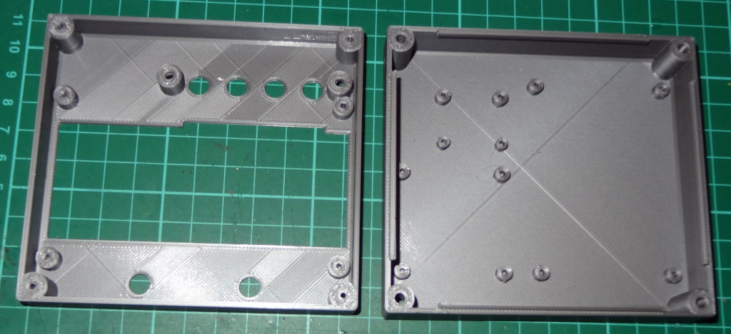

Here's the case design.

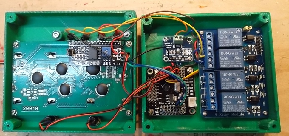

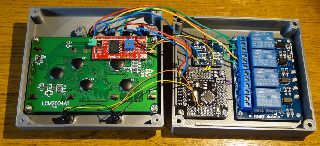

And here are all the gubbins wired up. Note that I hid some of the wiring underneath the boards, so as to make the tangle of wires look slightly less disgusting! :lol:

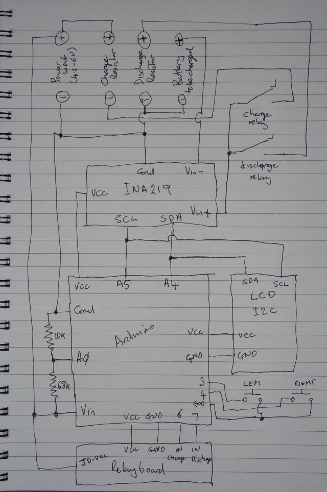

Here's a circuit diagram. Click on any photo to see a bigger version.
Note that the GND connection into the INA219 module is taken from the negative terminal of the battery being charged - and that GND wire then doesn't continue to the Arduino or anywhere else - all the other GND connections are taken from a separate GND wire from the GND input terminal. Although the two GND wires are connected to each other up at the terminals, this separates the 'analogue ground' in which virtually no current flows, from the 'digital ground' which carries more current and more electrical noise. It's best to wire it this way as the INA219 is then able to more accurately measure the voltage of the cell on charge.
