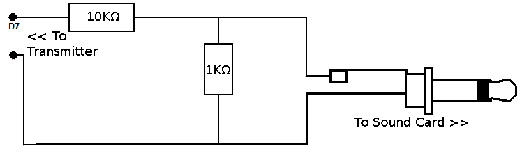

I followed your suggestion and put a voltage divider after the ppm signal and before the mic input. The author of the emulation software also suggests a similar setup with different values:
However, both suggestions made my signal undetected.
Connecting the ppm signal directly to the mic input works when I set mic level above 50% but there's always a buzzing sound coming from the speakers/headphones even if I mute those outputs. Still, it works perfectly otherwise and I can play Picasim without a problem, as the game interface offers a calibration system. I will try it in in desktop with line-level input his weekend.

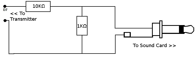

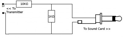

Re: I'm connecting the PPM output of Phil's encoder to the Mic input of my laptop
Isn't your mono plug connected backwards? conventionally signals go to the tip and ground to the sleeve
Maybe this is the cause of your buzzing... ground loops are tricky things.
The illustration is wrong, I've just noticed too.
I built my adapter properly nevertheless. It's been running fine and lately I've been having fun flying the PSS Spitfire.
