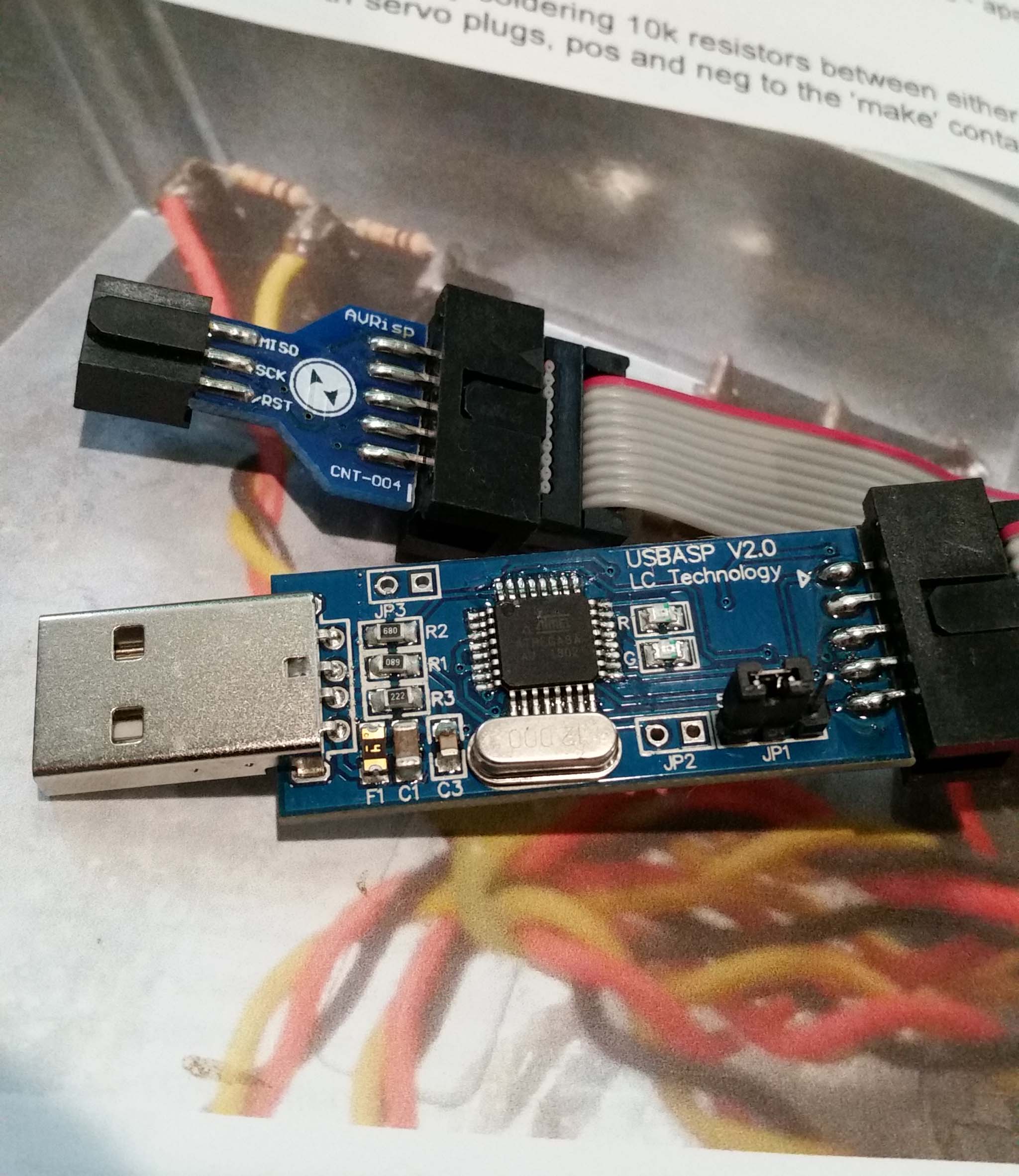

Thanks Martin! I picked up one of these.....
I got the driver loaded no problems. Windows 7 64 bit.
I might go get a nano board to experiment with!

Installed the drivers. I programmed a nano with "blink". It worked!...Except I get an error message about "cannot set sck period" BUT it still blinked....
Thanks for the help!
Dave
Dave
