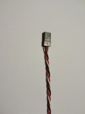

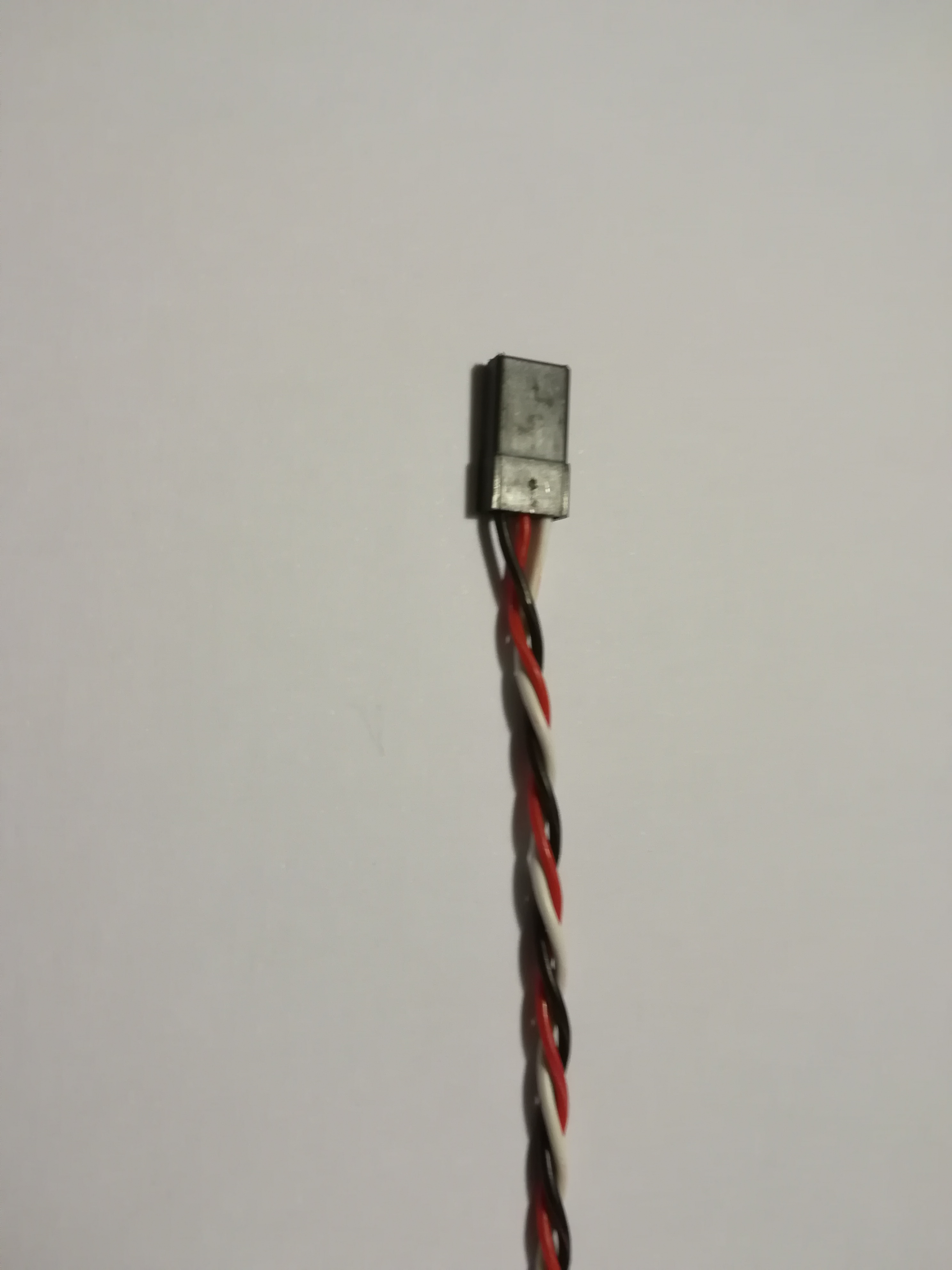

Thanks for your response and kind offer......... However, after I posted my question, I had an idea
I had some flat servo connectors which looked like 24swg so I split one into three separate wires, put the loose ends in a hand drill and twisted it..... Problem solved!

I've made twisted leads this way for a long time - one suggestion though, while the wires are still twisted & under slight tension in the drill give the twisted length a gentle once over with the heat gun. This removes any "memory" the insulation may have & encourages the bundle to stay twisted permanently

. You can see in the pic above that it had slightly unwound itself so I will give it a squirt with the heat gun and see what happens.......

Works okay if the three individual wires are disconnected at one end so they can each twist on their own axis. In fact if you twist all three the same way individually before putting them back together, then the resulting 3-wire cable automatically twists itself together in the opposite direction.
