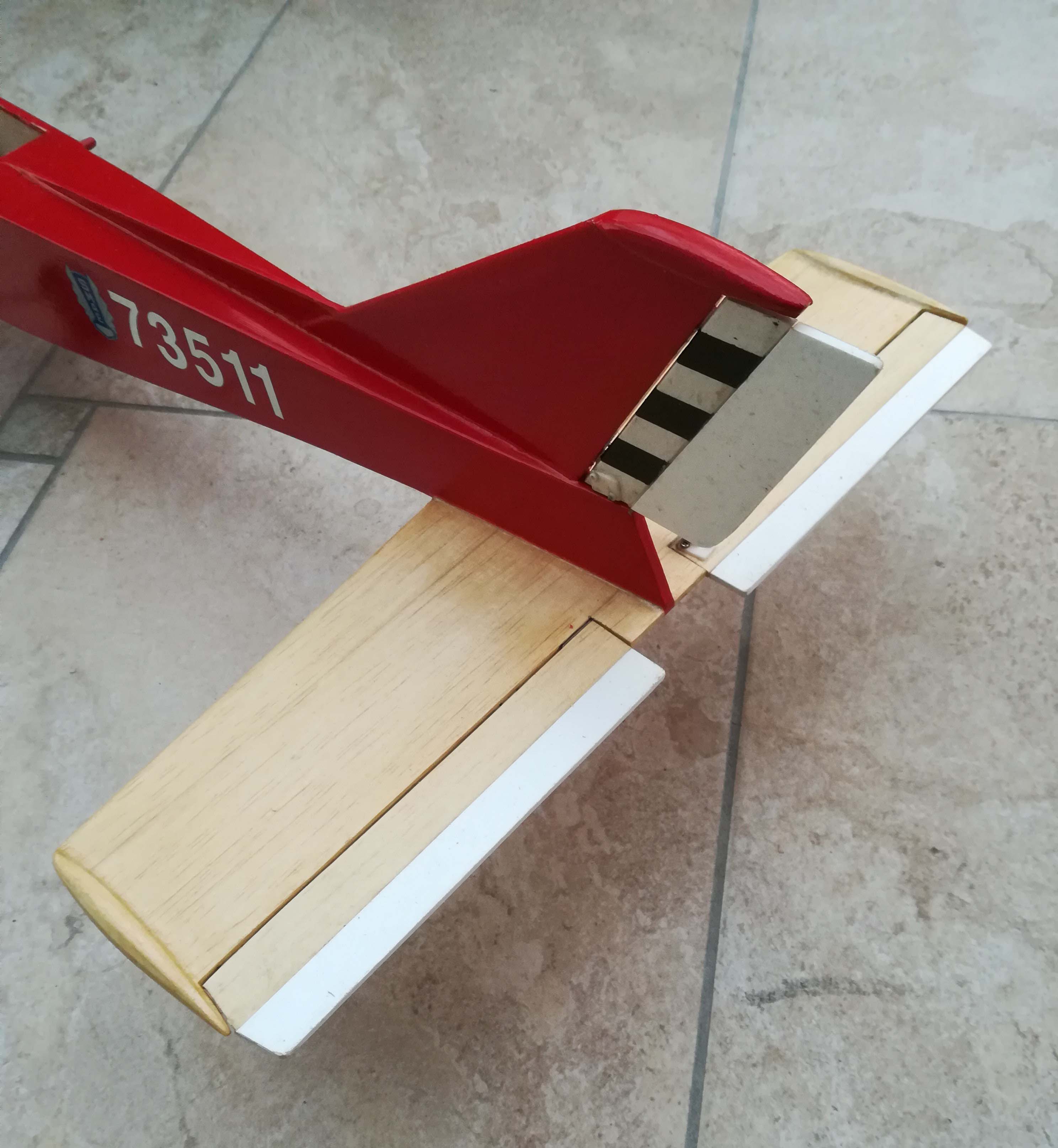

Yes, I remember the Timber as flying well on single channel and, having seen others in action, I know that the Tobe actuator was doing what it should so I was a bit flumoxed as to why it had such poor control response with GG. I ended up doing this to the tail feathers.......
which made some difference but not enough and in the end I increased the dihedral as well. Now it is flyable but still not great........
Gordon I would be interested in some details of your Timber...... Is the rudder as per the plan, how wide did you make the elevators, is the dihedral as per plan,what engine have you used and where is the CG?

I will fish the Timber out during the week to answer your questions.
Dihederal is as per plans and from memory so is the CofG.
From my thread on RCG
https://www.rcgroups.com/forums/showpos ... stcount=57
Plus I put some packing under the l/e of the tailplane, 1/16" or thereabouts from memory.
