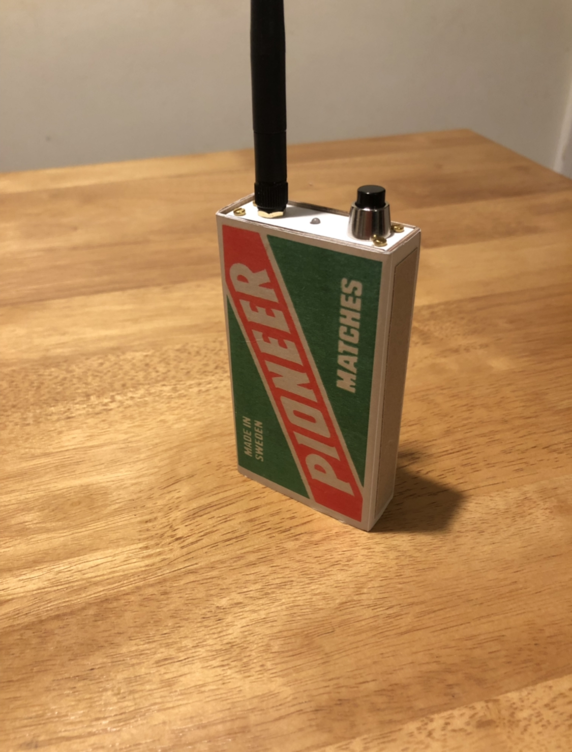

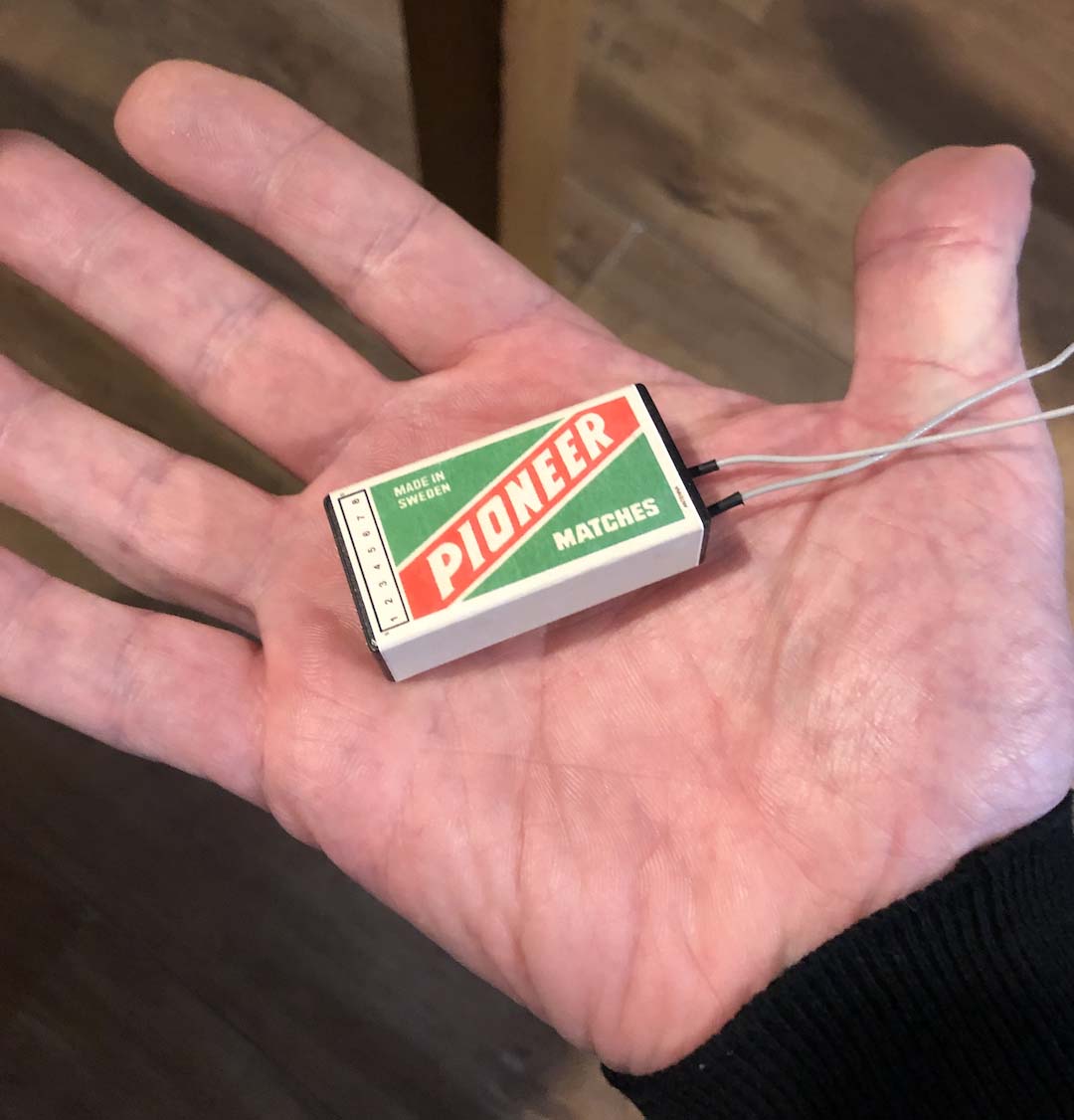

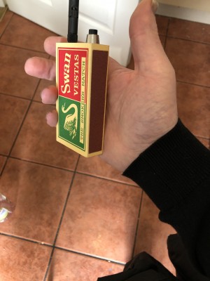

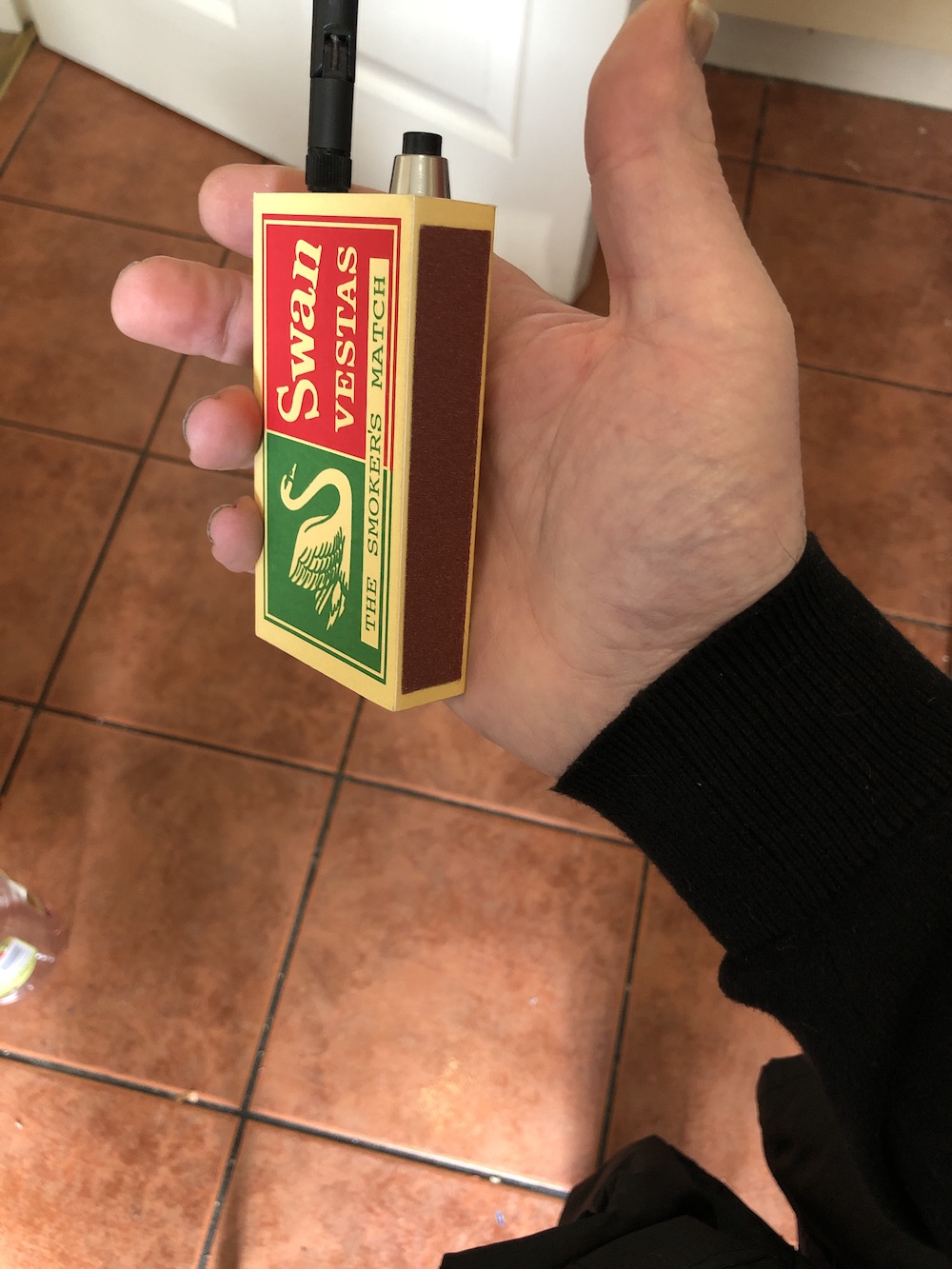

Here is my Mix & Match transmitter finished (get it? Match?) :D

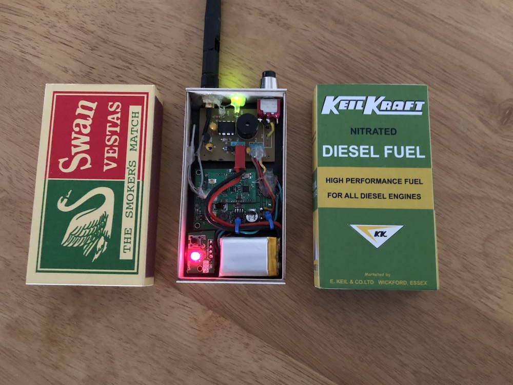

It was quite a tight squeeze getting everything in but it does go, The lipo is a Hyperion 270ma 2 cell with the blue shrink removed, great size, only 25mmx16mm.
Using a V8 hack module with all the original cables removed, prefer to use my own nice and thin cables plus you can cut them to the correct length, makes it neater.
Decided to mount the C&K button switch on the top, its actually quite a good feel. even better with the strip of sandpaper down the side for extra grip!
This actual box (inner and outer) was laser cut by Neil Igull, simple to put together and a perfect piston and barrel fit too. He also cuts a white plastic bezel for the ends with the holes laser cut into them. Im sure Neil would be willing to make them for anyone fancying a go at one.

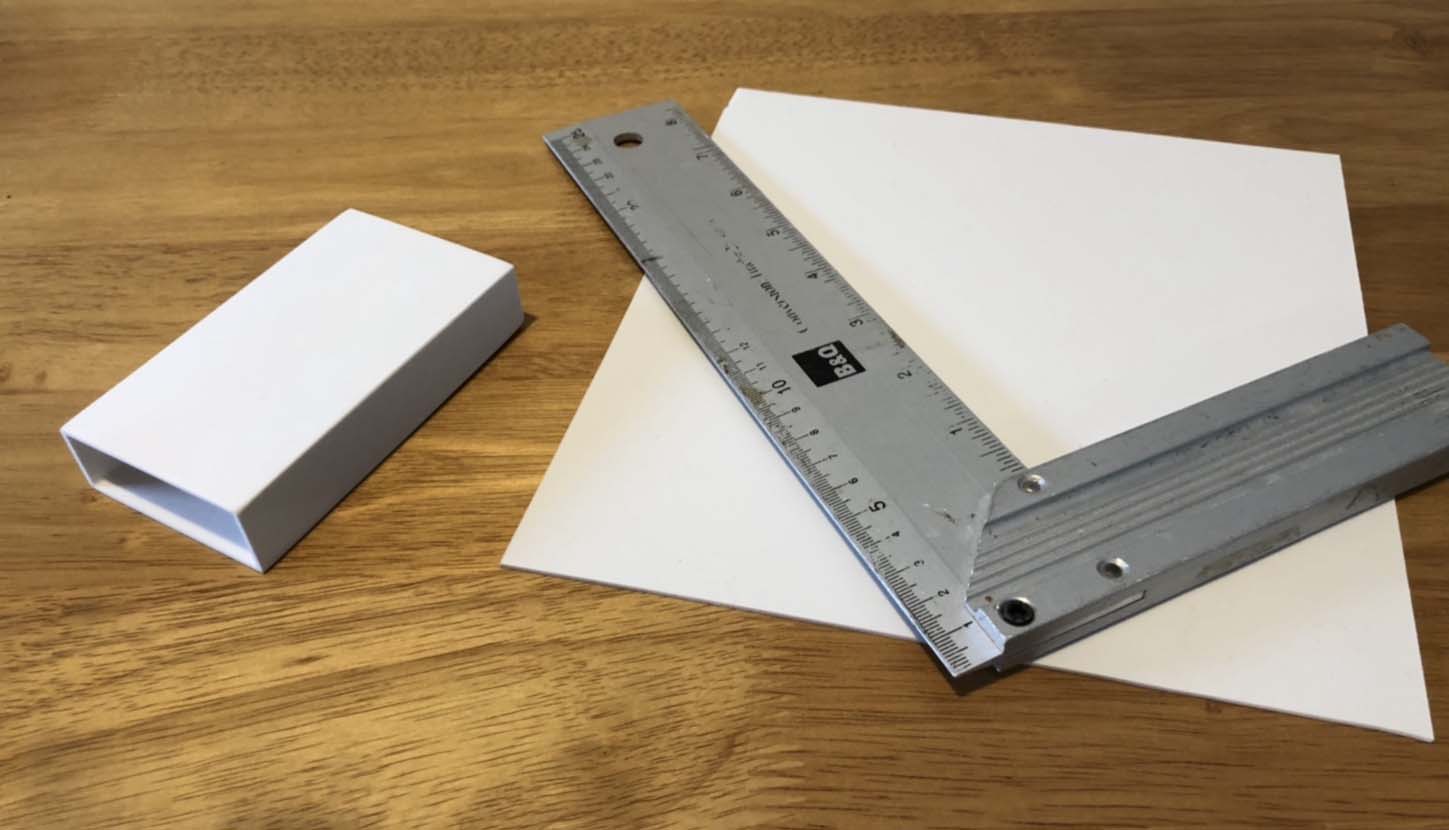

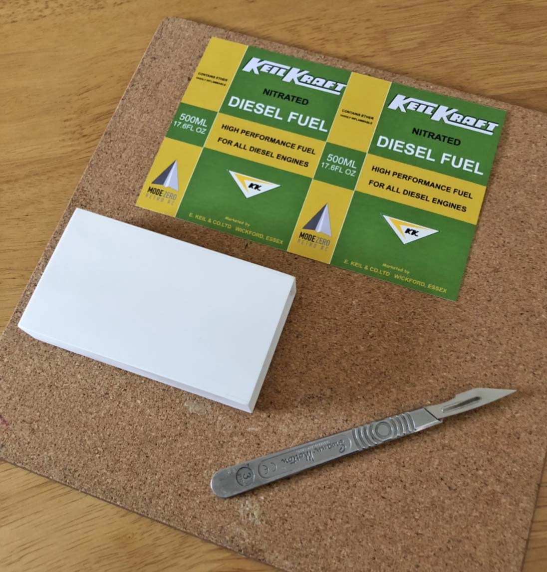

Regarding the box, it’s also possible to make one from plasticard, I used this method on my second attempt and it worked very well. It’s just a lot more work that’s all.
Far easier to give Neil iGull an email.

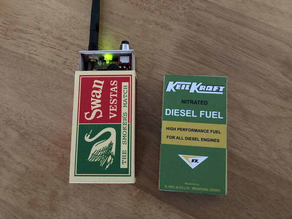

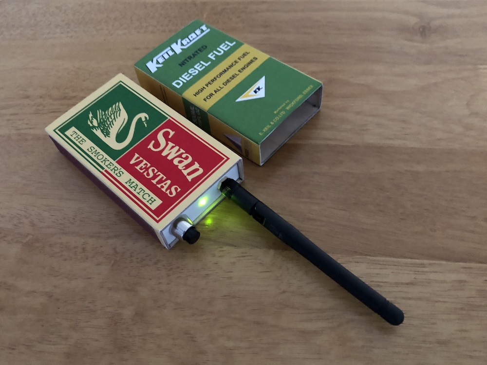

Just finished another slide on cover.
Particularly like this one as it’s the brand I remember My father using in the early 70s

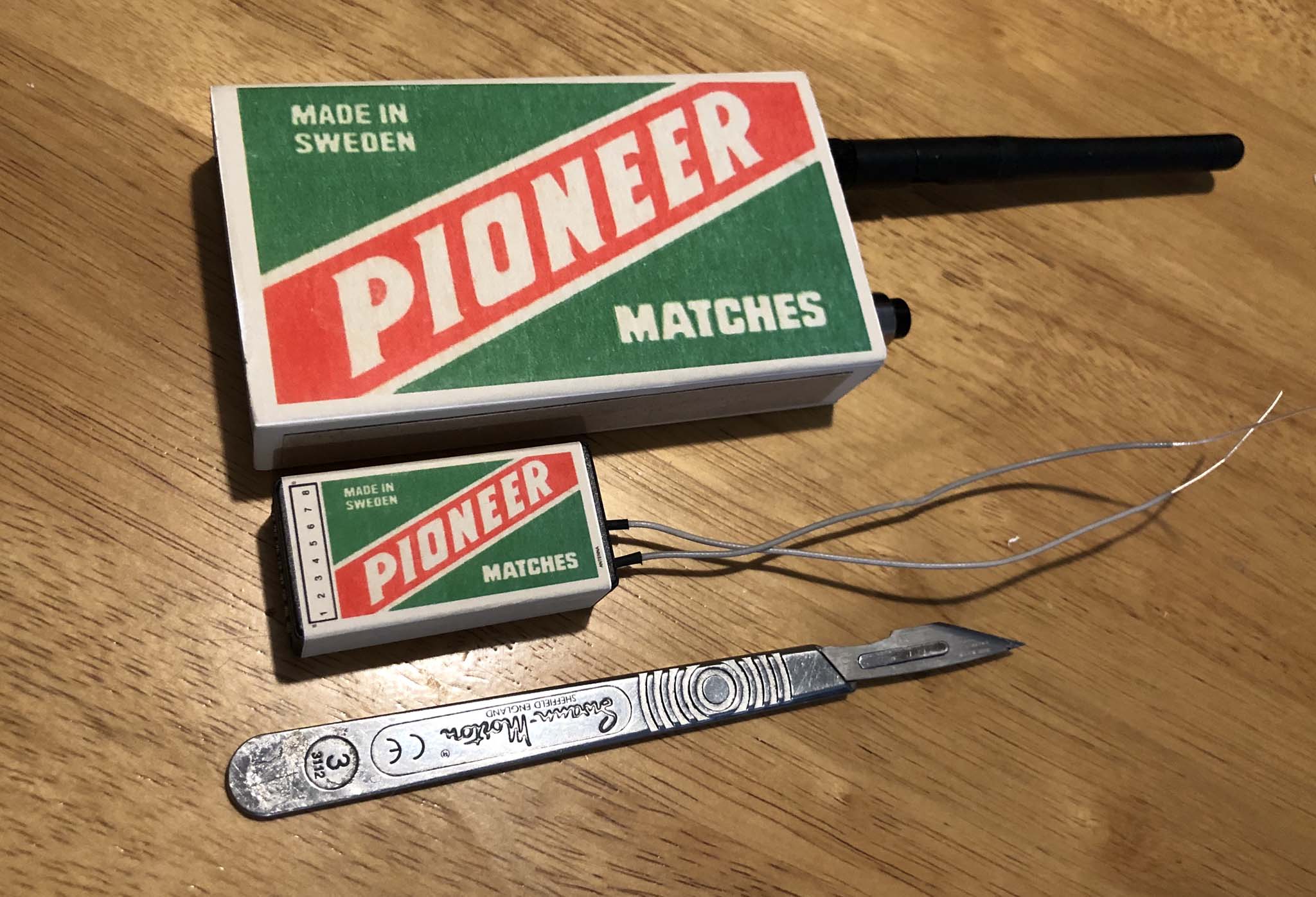

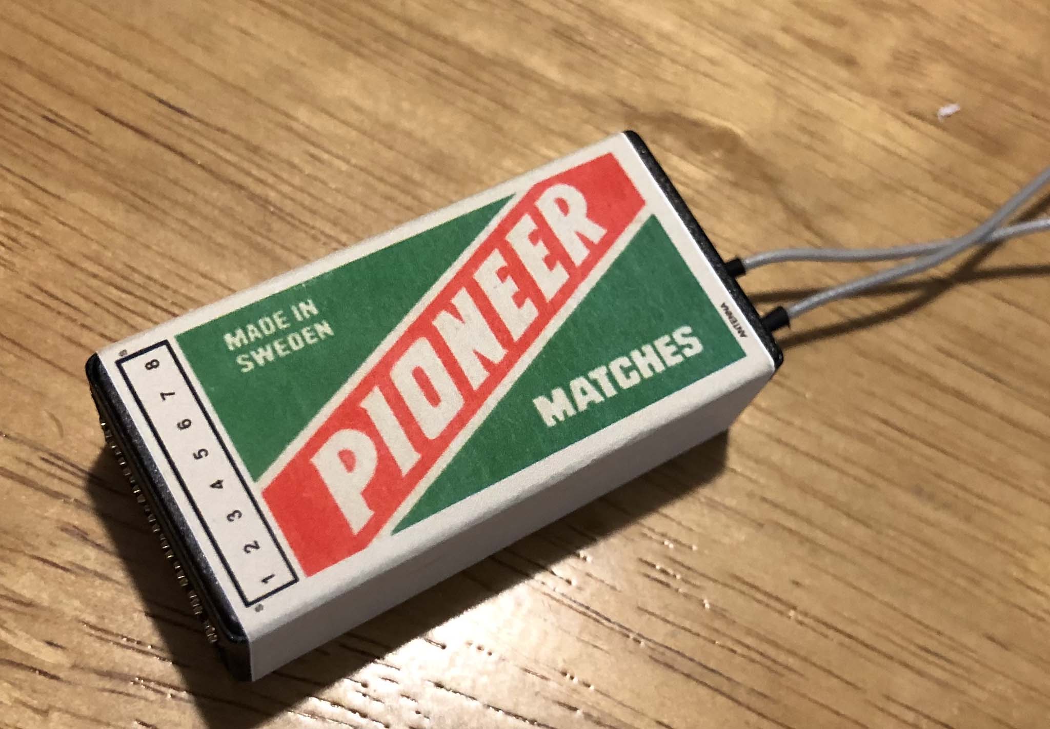

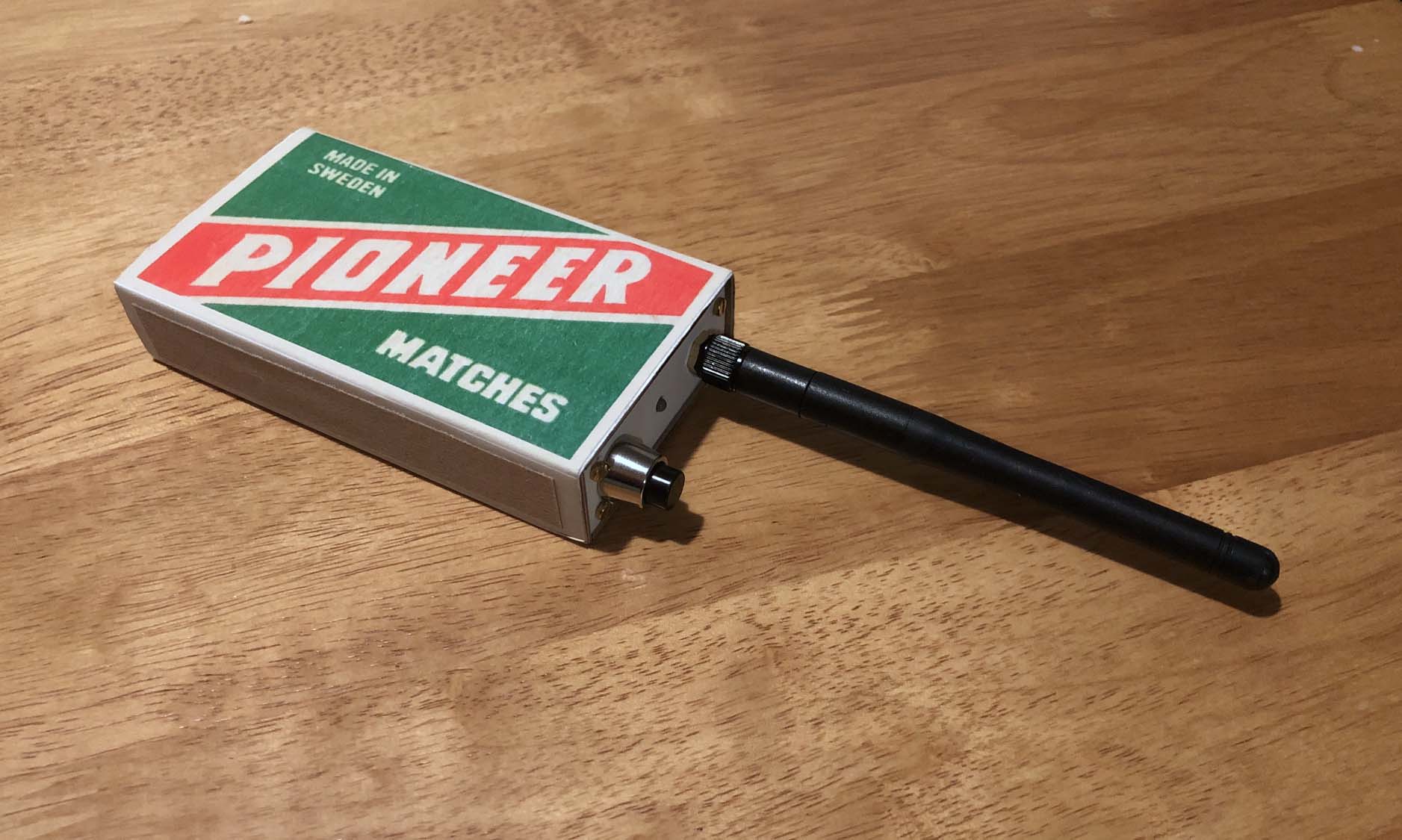

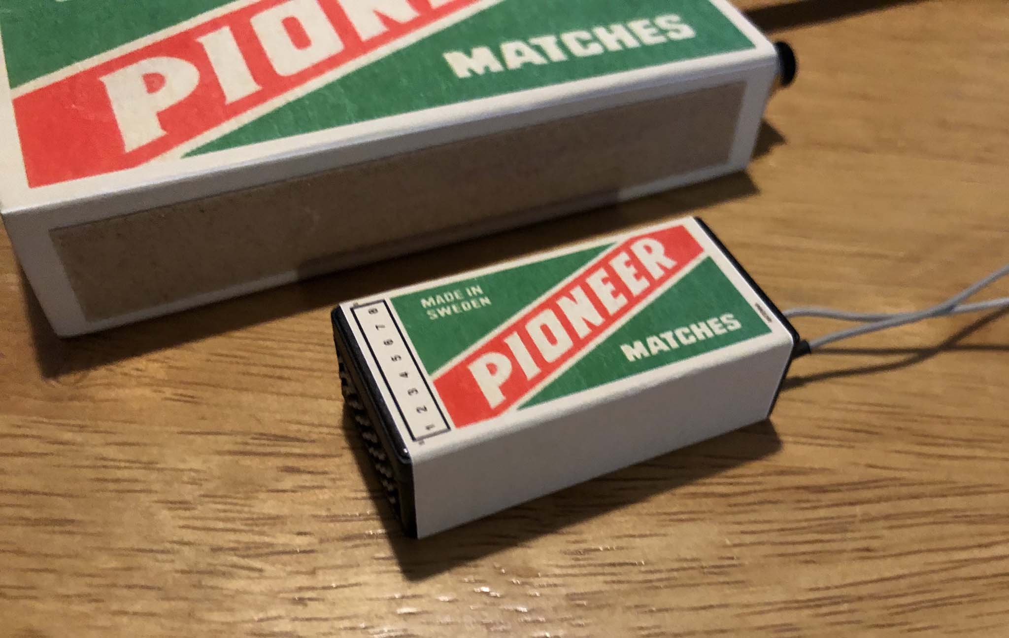

Just finished the matching receiver, How cute! :D

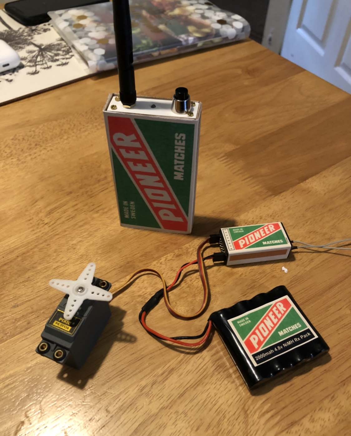

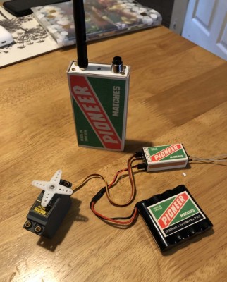

And matching Nimh pack just to finish off.
Just the cardboard box to make now. I know, OCd :lol:

Ron, you've excelled yourself. That's a great set and can't wait to see the box.
